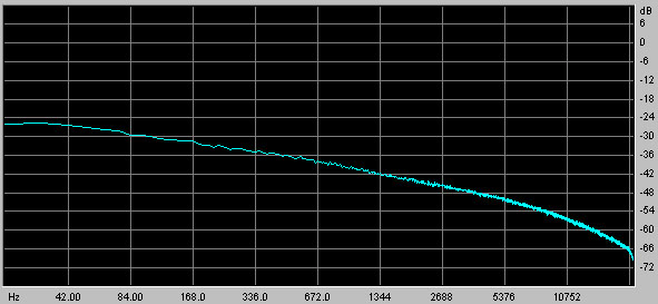

Brown Noise
The sound produced by the white noise generator is quite harsh, too much for many applications. Thus one would like to generate somewhat smoother noise signals. This can be easily done by filtering the output of the white noise generator with a lowpass filter. In fact, the Noise module in the Nord Modular has a `color' control, which adjusts the cutoff frequency of a first order lowpass filter applied to the output of the noise generator. At the minimum setting of the color control the cutoff frequency is set to 20KHz (or above), essentially giving no effect. As the color control is increased the cutoff frequency decreases, filtering out more and more of the high frequencies. At the maximum setting of the color control, the cutoff frequency is about 20Hz, and the spectrum of the noise output has a falloff of 6dB/octave. Noise with this rate of falloff in its spectrum is commonly known as `brown noise'. This name comes from `Brownian motion' which produces random signals with this spectrum.
