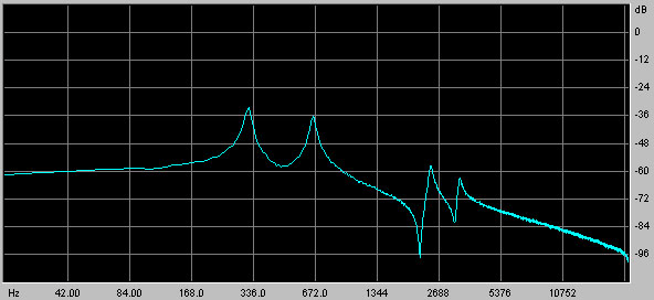

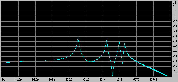

The Vocal Filter module combines four resonant bandpass filters with adjustable center frequency and bandwidth. There are nine preset settings of these four filters, yielding nine different vowel-like sounds (A,E,I,O,U,Y,AA,AE,AO). The frequency spectra corresponding to these nine preset settings are shown in the following graphs. You can see the resonant peaks of the four component filters in each of the spectra. Note that their positions shift from setting to setting. This shifting of the resonant peaks (or formants as they are called in auditory studies) is what provides the listener with the perception of different vowels. For the most part, the amplitudes and bandwidths of the resonant peaks are fixed between settings, although the bandwidths of the filters as a group can be adjusted with the resonance control of the module. In real speech the relative amplitudes and bandwidths of the formants differ between vowels, and even within a given vowel they can be different.
Vocal Filter Module `A' Spectrum
Vocal Filter Module `I' Spectrum
