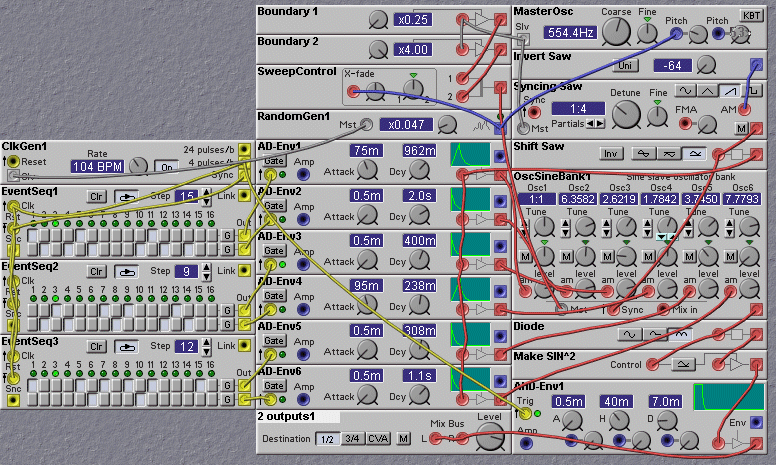

The idea of VOSIM is to have a simple model with only a few control parameters, that will generate vowel-like sounds with strong controllable formants. Interesting fact is that we will not use any filters for this, we directly construct the necessary waveforms with only sinewaves and a sawtoothwave, using sync and multipliers. The VOSIM model uses a train of so called sin2 pulses. These look like bellshapes. In one period of the waveform there are a given number of these bellshapes with the same width, but decreasing amplitude. Here is where we deviate from the original model, we will not be able control the exact number of sin2 pulses, but we will "fade them out".
To start we will use a Master module and two OSC Slave A oscillators. The syncing oscillator is set to a sawtooth and the synced oscillator is set to a sinewave. To get the sin2 pulses we only have to multiply the sine by itself. We can use a ringmodulator to do that, we will however not use the Ringmodulator module but the Multiplier module from the mixer section. Connect the output from the synced oscillator to both inputs of the multiplier and the output is a sin2 waveform.
What we want to do next is to use the sawtooth waveform as an envelope over the sin2 pulses, effectively fading them out over one period of the waveform. That is easy to do as the synced oscillator has an AM input. This AM input actually acts as a multiplier, it is in fact a build-in ringmodulator! Only we can not directly use the sawtooth signal to sync the sineoscillator and modulate the AM input. The sawtooth ramps up, and what we actually need is a sawtooth that ramps down. During the up transient of this last wave the waveform crosses zero in the positive direction and that is the point where we want to sync. So we have to invert the sawtooth wave. That is easily done by connecting a Constant module to the AM input of the syncing sawtooth generator and setting the constant to a negative value of -64. Now the output is a sawtooth that ramps down. Connect the output to the sync input of the synced oscillator. We still cannot use the inverted sawtooth wave yet to modulate the AM input of the synced slave oscillator, we first have to shift up the level with a levelshifter. So connect the sawtooth output to the input of a level shifter/inverter module and the output to the AM input of the synced oscillator, and there it is: VOSIM. We can use the trick with the two amplifiers and X-Fade module to control the amount of sin2 pulses.
Variations on VOSIM
Now the fun begins, because we can start to variate on the basic patch. First we are going to do something about the sin2 waveform. Between the output of the synced slave oscillator and one of the inputs of the GainController we put a Diode module. As you can hear the settings influence the sound considerably.
Instead of the sinewave you can try the other waves and use them if you like them more. Note however that for the squarewave and sawtooth, both having strong transients, the aforementioned jitter at the syncpoint might be heard.
Nature gave us bread but Clavia gave us the OSC Sine Bank, and it does all that we needed for VOSIM. So lets exchange the Synced Sine slave oscillator for the Sine Bank and connect it e.g. as follows:
Now we can conveniently have up to six controllable formants. And like a good cook you can add more oscillators, filters, phaseshifers, overdrives, etc. etc. Add them to your taste.
