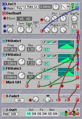

Another interesting variation is to put a few 12 dB filters in parallel and use the bandpass outputs to create a fixed or controllable resonant structure with several resonance peaks. By simply mixing the outputs of three such filters in a 3-input mixer, the 'formant filter' module of some vintage analog modular synths can be conveniently recreated with about the same DSP-resources as needed for a single 24 dB filter. A crossfader can be used to crossfade between the input signal that goes into the filters and the output of the mixer than mixes the BP signals to control the depth of the effect.

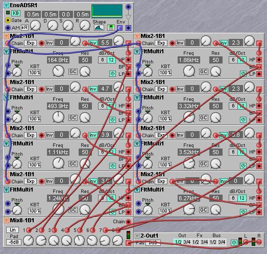

Modal synthesis
Strongly resonating bandpass filters are often used in a synthesis technique named modal synthesis. With this technique a number of bandpass filters are excited with one single pulse, causing them to ring for some time. When these bandpass filters are each tuned to a partial in the sound to be synthesized, quite convincing emulations of certain groups of acoustic instruments can be created. It is important to have very detailed control over the ringing time. An extra degree of fine tuning for the resonance can be accomplished by feeding back a phase reversed portion of the bandpass output to the filter input with an extra mixer module at the input, while the resonance of the filter is set to maximum. If the mixer used uses exponential control the ringing time of the filter can be set more precisely by careful adjustment of the feedback mixer knob.

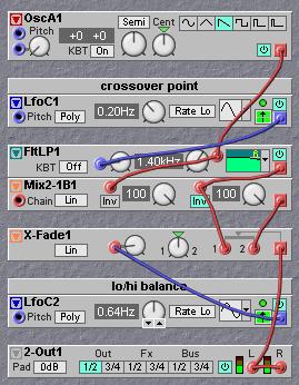

A typical crossover filter has one input and two or more outputs. When the outputs of a crossover filter are mixed together again, this mix should preferrably give an exact replica of the original signal. This last property is sometimes referred to as phase linearity. There is no dedicated crossover filter on the G2, but making a crossover filter is actually quite easy to do. The basic idea is to recover the high part of a signal that is thrown away by a lowpass filter. This is done by extracting the difference signal between the input and the output of the lowpass filter. Imagine that the ouput of the filter is mixed in reverse phase with the signal that goes into the filter. As the low part of the signal is in reverse phase with the low part of the unfiltered signal, these two parts will be cancelled out in de mixing. But as there is no high part in the filtered signal anymore only the high part of the input signal will be present at the output of the mixer. There is one requirement for this to work properly, and that is that the filter must have a gain of exactly one (be at unity gain) in its lowpass band, so it does actually cancel out exactly in te mixer. Pure analog filters are not precise enough for this use. In fact, crossover filters is an application where digital filters have a definitive advantage over analog filters, as they can have exactly unity gain in the passband. A good filter to use on the G2 is the non-resonant lowpass filter named FltLP. The advantage of this filter is that there can be no possible coloration of the timbre due to resonances in the filter. The FltLP can be set to slopes of 6dB per octave up to 36dB per octave in 6dB steps. Additionally it has a totally flat lowpass band at exactly unity gain, so it is the ideal candidate to be used to make crossover filters.
Have a look at the illustration above. A sawtooth waveform from an oscillator is fed into the input of a FltLP lowpass filter. The sawtooth is also fed into the input of a Mix2-1B filter. The output of the filter will be the 'low band' in the crossover filter. This low band is fed into the second input of the mixer. The signal on this second mixer input is brought into antiphase by activating the Inv button. In practice this means that the signal on the second input is not added, but instead subtracted from the first input. On the output of the mixer is the difference signal between the input and the output of the filter, which is 'all but the low band' or whatever the FltLP has thrown away. The advantage of splitting the audio range with this technique is that there are no nasty phase shifts that would occur if both a lowpass filter and a highpass filter were used in parallel, which perhaps many would think to be the obvious way to do it. In this simple crossover filter the high band has a slope that is not as steep as the lowpass filter, e.g. when the lowpass filter is set to 24dB the highband does not have a slope of 24dB. In practice this is not a problem as highpass filters do in general not have to be as steep as lowpass filters to have the right sort of sonic effect. Experimentation and good listening to different settings is necessary to get a good idea of what is happening when tweaking the filter cutoff or changing it to another cutoff slope. Notice that lowpass filters and highpass filters psycho-acoustically work out totally different on sounds. An interesting example is a small sixties transistor radio. The little transistor radio can physically not reproduce frequencies below some 200 Hz, it is just too small for that. In fact, its speaker is an effective highpass filter set to some 200 Hz. Still, when listening to such a radio there is a definite sense of bass notes. Psychoacoustic research has found that if there is only a hinge of harmonics present that belong to a low pitch that is too low to be reproduced by a speaker, a person will reconstruct the sense of this low pitch in the mind. Which actaully applies to any highpass filter. This basically means that whatever a highpass filter throws away the mind will try to reconstruct. The mind does not do this with a lowpass filter. Which means that the issue of slope steepness works out totally different on lowpass and on highpass filters.
When the two-pole A/B switch is swapped for a crossfade mixer it is possible to smoothly fade between the low band and the high band. If the crossfader is in its middle position the original signal is heard, as this is an equal mix of the low and the high bands. When the crossfade position is moved it will cause one of the bands to be attenuated while the other gets more emphasized. This is very similar to a shelving equalizer where the zero dB point is exactly at the cutoff frequency of the lowpass filter. But this simple patch has several advantages over a standard shelving EQ. First is that the cutoff frequency can be controlled and modulated between extremely low and high frequencies, second is that the balance between the bands can be controlled and modulated between full lowpass and highpass slopes. When used on an audio loop it is possible to fade a loop away in either the low or away in the high, depending on the setting of two knobs, the knob on the crossfader defines if the fade is going into the low or the high and the cutoff frequency of the filter does the actual fade. Third and most desirable advantage is that before the bands go into the crossfader both bands are separately available and can have different additional effects inserted at this point. These effects would have their effect in this band only.

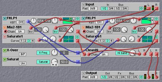

Crossover filters are always good to use before a distortion module. The idea is that distortion often generates a lot of high harmonics which might conflict with the high harmonics already present in the signal. Distortion is often preferred to happen only in either the lower or in the middle ranges of the audio range. By preventing higher frequencies to go into the distortion module much less high harmonics are generated, but the original high is lost as well. By using a crossover filter and mixing the distorted low with the undistorted high, there is suddenly an extra timbre control on any type of distortion. Note that the main distortion will appear to happen in the ranges just above the cutoff frequency of the lowpass filter in the crossover.

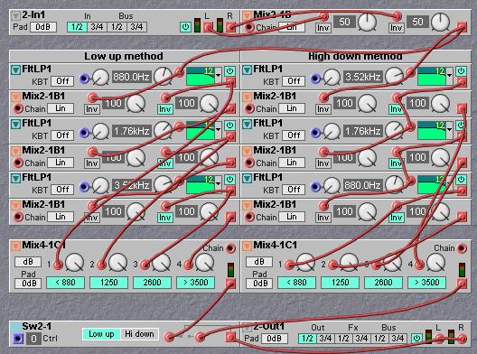

Multiband filters
If more than two bands need to be processed, only one extra filter for each band is needed. So if four bands are needed only three filters are actually necessary. Such an array of bandpass filters can be build from either the lowest band up or the highest band down, which in practice does make a difference on how each band sounds. The idea of this cascade of crossover filters is to split a signal in two bands named L and H, then one of the two bands is split and one of them is split, until there are enough bands. The illustration shows the idea better than words can describe it.
When using this method, the filtering accumulates through the array of crossover filters. If the bandfilters are build up from the low band upwards the lowpass slopes of a band will appear less steep and the highpass slopes appear steeper, while when building from the highest band downwards the bands appear to have steeper lowpass response and less steep highpass response. When listening to only one band in the middle, the low to high method appears to give a bit a higher tuned band than with the high to low method. The choice which method to use is basically a matter of personal taste and might also depend on the sort of audio that is filtered. It is handy to make two similar patches, one with the low up and the other with the high down method and check out which one best serves a particular situation. You will notice that the effect of the bands can be quite subtle, making this type of multiband crossover filter well suited for subtle tonal control on instruments in a mix. This is probably not the type of bandfiltering one would use to create a mastering multiband equalizer, as the bands appear quite shallow. But for the purpose of applying selective distortions and mixing all the bands together again in the end, this bandfiltering works out pretty well. The big advantage is that the crossover frequencies can be freely set to define the width of the bands and virtually any number of bands can be created.

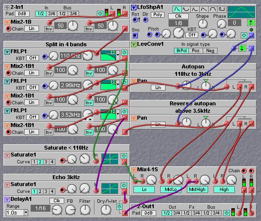

Grunge in low with echo in a small mid band and some panning
The next patch illustration can be used on e.g. a sampled drumloop. There is saturation on the kick, an area around 3kHz has a MIDI synced echo. The area between 110 Hz and 3kHz plus the highest band above 3.5kHz are autopanned in reverse with a MIDIsynced Lfo.
