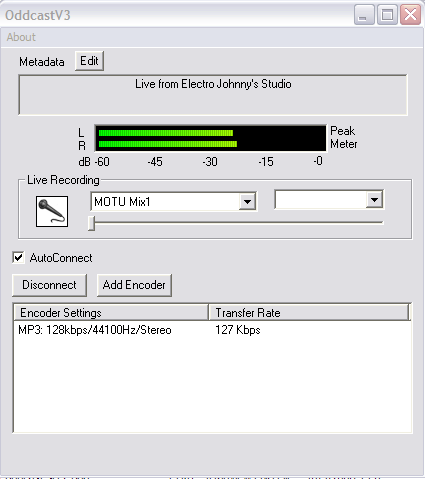

    Next, click OK and return to the main Edcast window. Click on the Connect button and see if you connect to the server. If it keeps trying and not getting through, then recheck your settings making sure you have the port and password correct. There is a chance that the http://radio.electro-music.com server is down. To check, use this URL http://radio.electro-music.com:8070 but replace 8070 by your port number. You should see the Shoutcast D.N.A.S. screen.
    Almost finished now...
    If everything is working, check the AutoConnect box. This will automatically reconnect if something causes a disconnect during your stream.
    Finally, Click on the Edit button next to the word Metadata near the top of the window. This is where you put in the title of your performance. Put that in the Metadata field - leave the rest of the stuff alone.
    You can edit the metadata anytime you want while you are streaming. If you are streaming a concert you may want to make the metadata identify who is performing.

    When all is working well, you will see something like this:

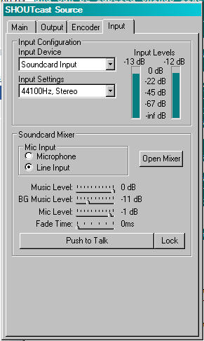

    • Click on the Input tab and ensure that the correct Input Device is selected, in our case use Soundcard - NOT Winamp. This is because we will use the soundcard for our live broadcasts.
    (It isn't necessary to use the soundcard mixer in the bottom part of this configuration window. This works only for commercial PC sound cards. If you have a professional audio interface, like a Firewire MOTU 828 or something, that mixer section won't even work.)

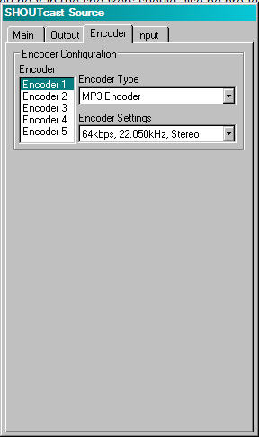

    • Click on the Encoder tab, select Encoder 1 on the left, and select the bitrate options 128 kbps - stereo.
    • Click on the Encoder tab again, select Encoder 2 on the left, and select the bitrate options 44.1 kbps - stereo.

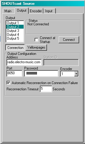

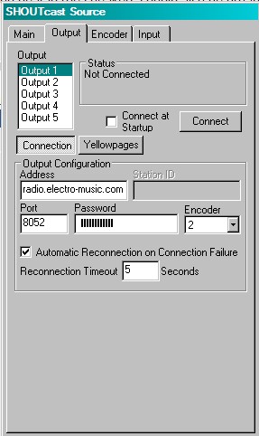

    • Click on the Output tab, then select Output 1 on the left.
    • Click on the Connection button to bring up the settings for the SHOUTcast DNAS you will be connecting to. Enter the URL radio.electro-music.com under Address. Use the Port number, broadcasting password set on the server, and select 2 under the Encoder pulldown menu. (Yes, that's right - Output 1 uses Encoder 2, and Output 2 uses Encoder 1. It's a quirk with Winamp - sorry.) Enter the first port number and password given to you by a stream operator.
    • Optionally, place a checkbox in Automatic Reconnection on Connection Failure if you want the DSP to reconnect in the event of a Internet connection failure. (recommended).

    • Click again on the Output tab, then select Output 2 on the left and repeat the above steps for the Output 2. Use the 2nd port number you were given, and use Encoder 1 (yes, Output 1 uses encoder 2). Be sure to change the Yellowpages fields as well.
