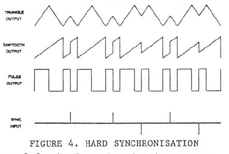

Hello all,
I'm in the process of redrawing a bunch of schematics for various modules (nothing really original, just the usual stuff, just a few enhancements and snippets here and there).
I'm stuck with the VCO core. My starting point is a classic ASM-1 type (integrator with reset) raising sawtooth generator. But I want a sync input. I do understand that you can externally force the comparator to fire at any time, thus resetting the integrator. This is what I understand to be called "hard sync".
Then what is "soft sync", which seemingly has an "intensity" control ? Is it just the same as "hard sync" except for an attenuator (I doubt it is) ? Or (more likely) something more subtle?
I've read plenty of documents trying to explain the difference, many of them with waveform diagrams, but I still can't understand. Most of them insist on things like "harmonic locking" or even "approximate harmonic locking", which adds confusion (to me) and shame (for being dumb).
If anyone would be kind enough to give me an explanation of what happens (I mean at the electronic level) in "hard" and "soft" cases, and why they are different, I would greatly appreciate, and be grateful forever!

You are exactly correct with your definition of hard sync. The term Soft sync is used to describe two different variations which might be the cause of the confusion.
Case 1
With a triangle core VCO, it is possible to have the sync signal reverse the slope of the waveform, so for example if the triangle was ramping up and at 70% of it's max level when the sync triggers, it will start ramping down from 70%.
The discontinuities are not as sharp as with hard sync, creating a much more subtle effect but it still sounds similar to hard sync. I don't think it can be easily done on a saw core VCO.
Case 2
There may be variations on this, but the one I am familiar with 'windows' a regular hard sync input so that the reset will only occur if the level of the slaved oscillator is close (variably) to it's peak value. This is also called weak sync by Roland on the 100M. I find the effect not as useful as with case 1, it sounds like the sync is not working properly Laughing

And to make matters even more confusing; the CEM3340 can do two types of hard sync, depending on whether it is synced by positive or negative pulses... and it's a different hardsync than the one described above (in fact, it's more like the case 1 soft sync...)
CEM3340 hard sync

Hmmm... so that was (only?) it ? Thank you all, now things are a lot more clear in my mind.
Obviously I can't have soft sync with a sawtooth oscillator, not even with the triangle wave obtained by rectifying the sawtooth. A triangle VCO is required. But I don't like too much triangle VCOs (don't ask me why, probably some genetic background).
So I will stick with hard sync only, which also happens to be considerably simpler to implement.
And I do agree that ears are the ultimate judge. But when you're actually designing the circuit, a bit of electronic knowledge is indeed helpful...
