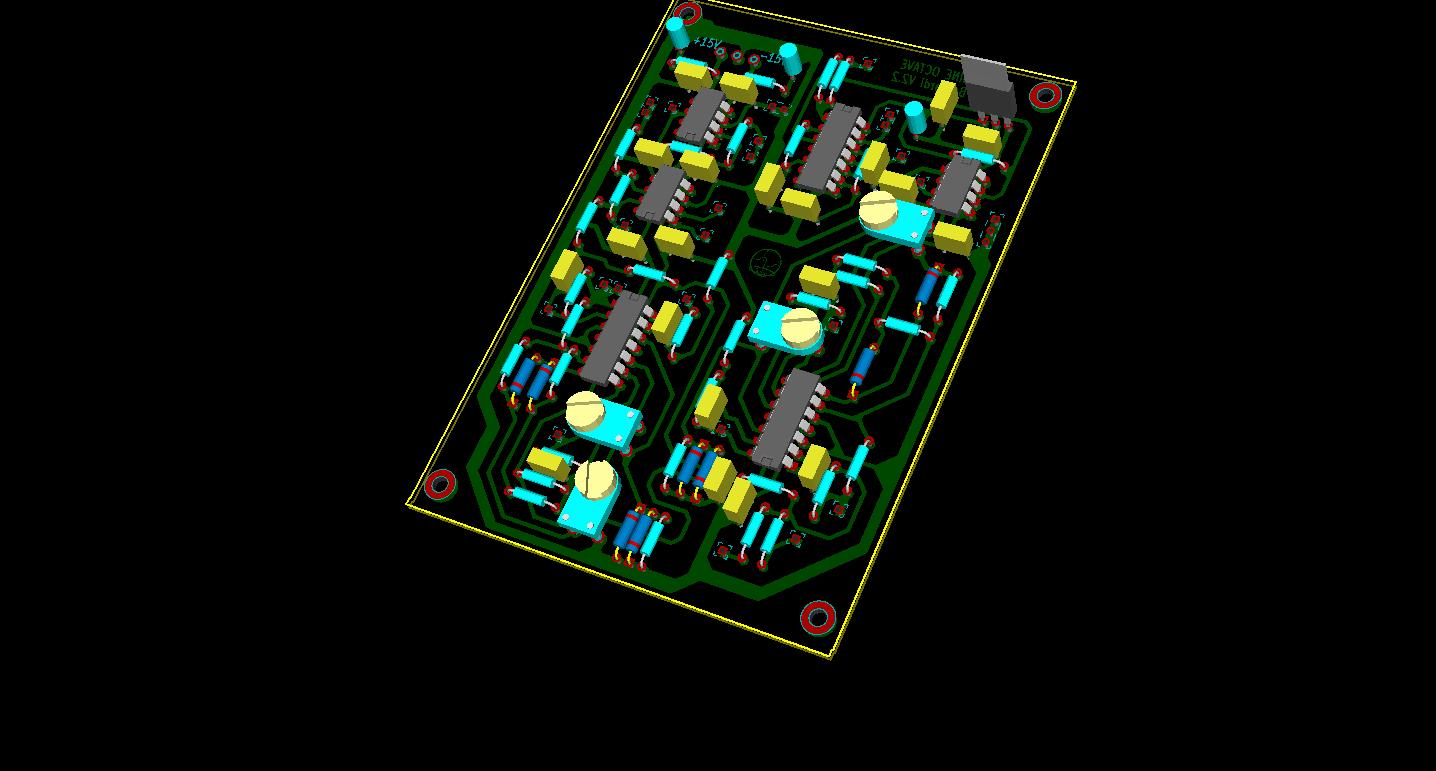

Hello
I've done a layout for a pcb, thanks to Jerem (from the french Yusynth forum) who pointed out many errors and who built first this one.
So it is verified.
You should notice that P6 on the schemo seems to be drawn in the wrong sense, you should tie pin 2 & 3 together and NOT pin 1 & 2. This pot is really tricky to me as it doesn't act like a simple attenuator.
Here is the files, pcb + layout. Please pay attention to the jumpers J1 to J4.
And feel free to suggest or comment this one. It is some of my very first pcb design.
edit: added a 3D view, just for fun.

PostPosted: Fri Feb 17, 2012 5:49 am    Post subject: Reply with quote  Mark this post and the followings unread
Nice layout, hard to believe it's your first attempt. I wanted to see the original schematic but the comcast link in the first post is dead. Is there a new address available, or do you have a copy you could post (with the proper disclaimers for whose work it is, etc)? Thanx

Thanks marv
well it's not my first pcb, but it's maybe the second or third one Wink
Anyway I use to work on perfboard for a long time so it certainly helped me a lot, and I've made lot of mistakes during the drawing so I've also learned a lot while doing this.
On this schemo you should read potentiometers pins 321 from left to right for the output waveforms, but P6 is reversed so you should read 123 from left to right.
Note that all the waveform pots are not drawn in the last page of this document, but they are all present in my layout. So in total there are 10 pots, 1 SPDT switch and 2 jacks.
