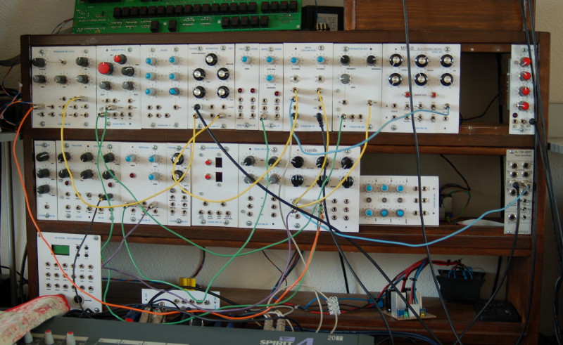

I have replaced the ordinary noise gen. in one of my
m-150 (roland 100m) modules with a cgs digital noise,
here´s how it finally turned out
edit: a short soundclip sweeping/modulating the int. clock
http://www.analogue.org/roland100m.ce/media/dng.mp3
