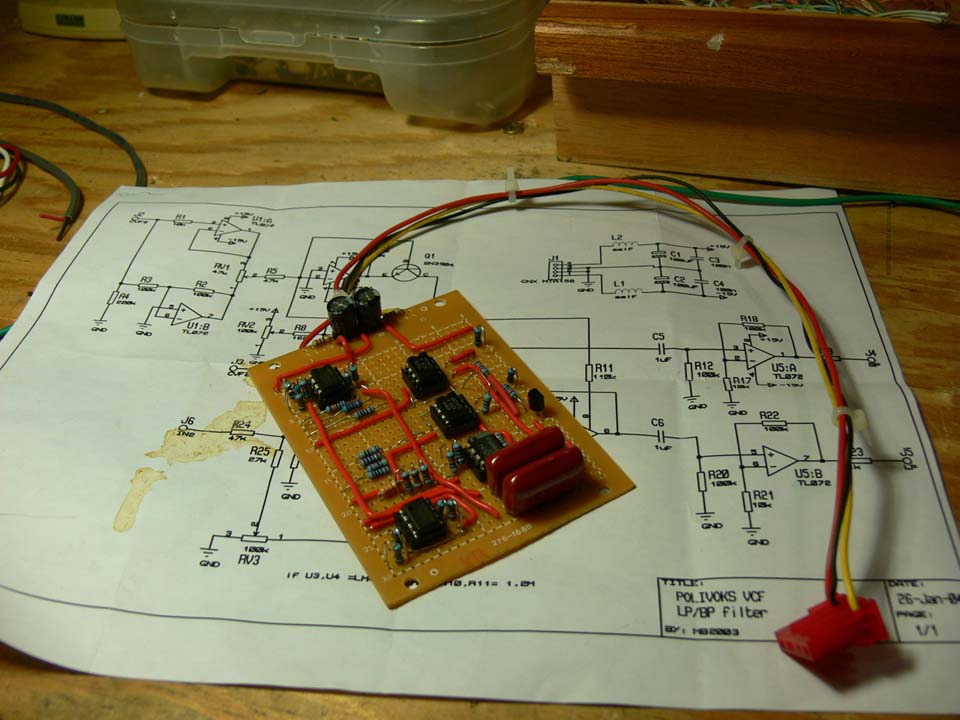

I breadboarded the Polivoks filter tonight using the schematic form http://m.bareille.free.fr
I like it a lot. It reminds me of the MS20 filter clone with the input gain turned down, but when you turn the input gain up there's magic. It turns into a nasty evil distorted beast. It has that crazy squelchy resonance that the MS20 dies when it's turned to max. I'm definitely putting this together on veroboard tomorrow.

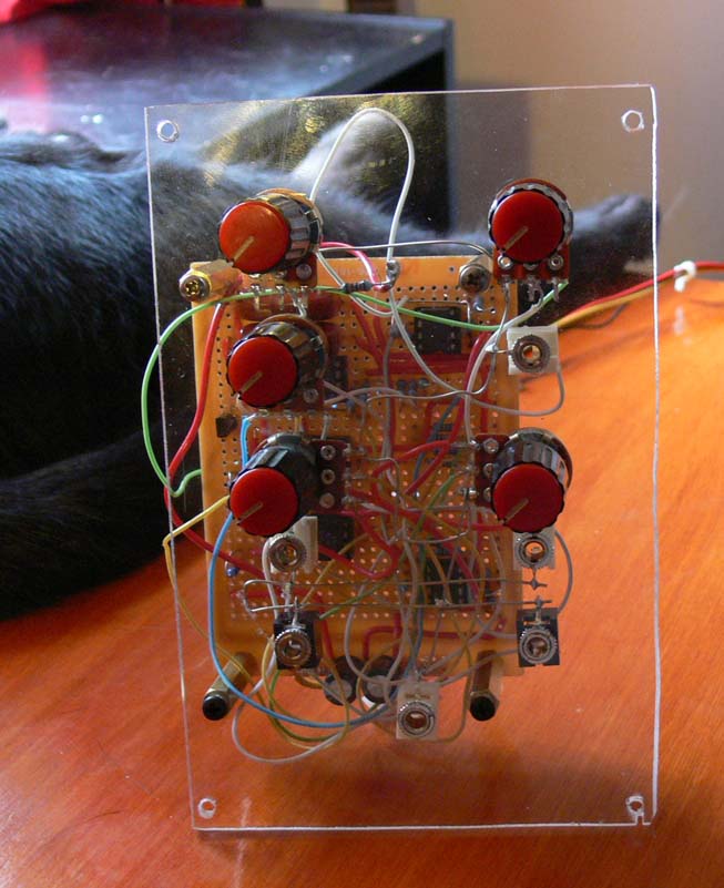

I lucked out on the UA776's. My local surplus store had some. I used attenuators on my inputs, which makes a huge difference. It also amazes me the range of different tones you can get just from adjusting your input levels.
I like your layouts. The bandpass filter on this thing sounds awesome. I have plenty of mixers, so I didn't do an output mixer. I nearly gave it the same panel I did for the MS20 clone.
Here's my panel. I know it's a little jagged, but I cut it with a jigsaw. I need to get to a table saw to cut some more blank panels.
Here's a picture of the vectorboarded (stripboard, veroboard, whatever it's called) Polivoks as well. I was pretty pleased with my work. Very Happy

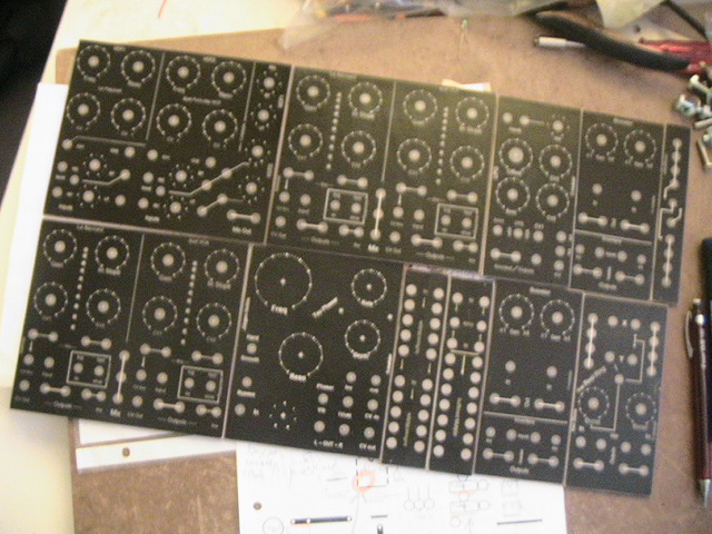

My panels are btw. also made with the Jigsaw. i build mostly in wood, but now with printed covers
my panels in work, on top left the dual polivoksfilter panel
on top lefgt my new deual polivoksfilter panel

I just finished building a Polivoks filter also. I chose to wire it by hand and grabbed whatever perfboard I had in the drawer. Then I found this forum posting and found by coincidence we had built them on the same perfboard. I just thought that fact was interesting. I'm still waiting for my front panel to finish the module. I did a lot of comparisons between the NTE888M and TL071 op-amps and the 2N3904 transistor and the Russian УД1208 and KP140УД85 op-amps and the KT315Г transistor. I also implemented a few mods including 1V/octave tracking and changes to the self-oscillation waveform.
