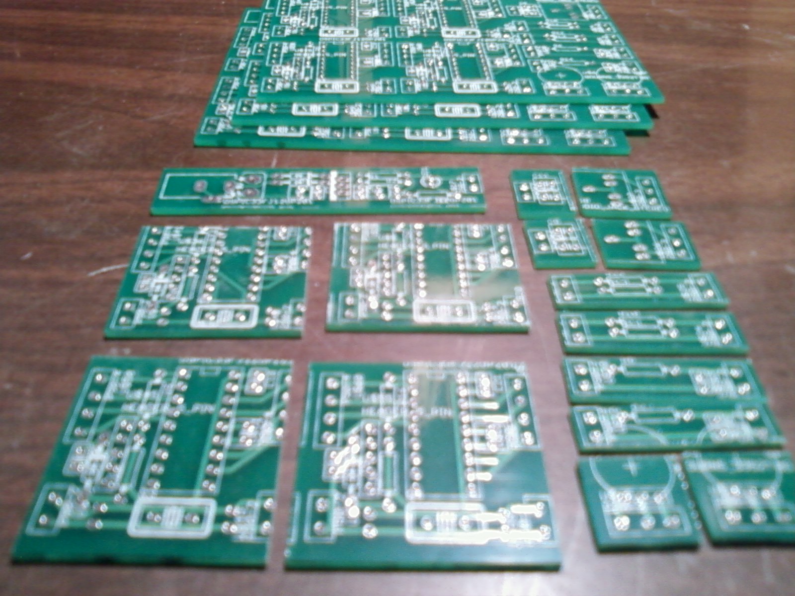

PostPosted: Tue Mar 24, 2009 8:51 pm    Post subject: Reply with quote  Mark this post and the followings unread
I finally figured out how to chop up the EChucK boards. I had the solution all these months but didn't think of it. I just put my Dremel tool in a drill stand and put a diamond cutting wheel in it. By carefully adjusting the height of the cutter, I sort of rigged up a makeshift table saw of sorts. Just the thing for cutting the boards. Though, as you can see some of the little EChucK boards are trimmed a bit too close. They are still usable though.
I also downloaded and installed the MPLAB IDE and C programming libraries, then after days of reading pdf files and going through tutorials I was finally able to write my first EChucK program. All it does is output a square wave, but it is the basis of generating the PWM output signals that the modules will use to transmit audio.
I have been wondering about what to make as the first really useful EChucK programs, and just tonight it occurred to me that I could make guitar effects using the DSP engine in the dsPIC processors. That plus maybe an AM radio transmitter for guitar.
At the moment, it's all a moot point, however, because I have no programmer and no chips to program. In time I will get those things set up also. Little by little EChucK is becoming a reality!
EChucK boards, one of them chopped up!
