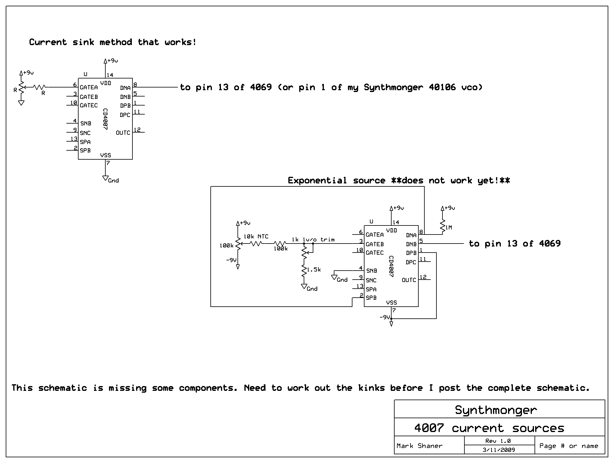

Still working out the kinks but I've replaced the transistors in my 40106 vco with some gates from a 4007 and it works pretty dang well! The distortion isn't as great and the range is about 5hz to well above 20khz. I haven't tested the max frequency but it's definitely inaudible and coming up pretty smooth looking on my scope.
I'm using one of the spare gates to buffer the triangle output so it can interact with things without "flopping" out. I need to amplify it as well since it's only peaking out at about 2v.
I have pulsewidth modualtion, a better sync and hopefully some sort of waveshaping. Ideally skewing and/or sine wave output. All using the extra gates of the 4007.
I plan on making a board for it and will be posting it here. Schematic hopefully later tomorrow...er well today. Last edited by synthmonger on Tue Mar 10, 2009 10:04 pm; edited 1 time in total |

Okay so I found out adding a Cap and a resistor at the output of the triangle gate solves it going floppy when applying the output to a voltage input so that saves me a gate.
Now I have one gate left on the 4007. Either I can use it and a spare 40106 gate for an extra pulse width output, or another vco without pulse width modulation...bah maybe I should just make a couple versions.
I also found some gnarly waveform outputs on different parts of the PWM circuit. Squarish-sawish kinda shapes that are skewable via the PWM input. Fun stuff for sure!

I decided I'm going to make a layout fit to 3U eurorack standards with doepfer style PSU connectors. There will be holes for pots from futurlec on the boards too.
I'm 50/50 on what I should do with voltage requirements. I might stick with 12v and ground or +7/-7 by using 4049s as voltage inverters/regulators. This way I can interface it with standard modular synths with ease...actually come to think of it I could probably just make boards for DC and AC psu's with not much trouble. |

Posted: Tue Mar 17, 2009 2:51 am Post subject:
Still no luck finding a good expo source out of the 4007. Works great as a current sink but I'm not sure when I can get the 1v/oct worked out.
In the mean time with some tweaking you can use the 4007 sink schematic I posted for a fun 4069 vco. If you want it even simpler then stick a voltage divider onto pin 13 in series with a 50-100k resistor. |
