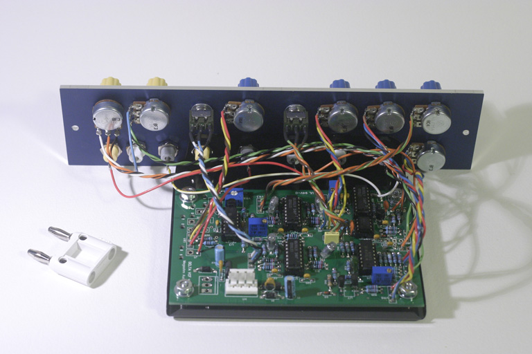

Let me start by stating who I am.
I am MegaOhm Audio and run these two websites:
www.megaohmaudio.com
www.fracanana.com
There's nothing on the fracanana site yet.
So, I started out doing small module runs a few years ago in MOTM format. This led to some custom modules done in Modcan A format. I fell in love with bananas!
Last Nov I made a pcb for a Delta VCF and did a batch of five MOTM format and a few Modcan A format. It turns out this was a no-no. One said No outright and the other gave me the impression that permission may be conditional. No problem. To each his own.
So I have abandoned both formats. If it's not FULLY open then I'm not interested.
For 1/4" format I have settled on Moog/Synthesizers.com format. There are many benefits to this form factor but that's for another post.
For banana jack format I settled on Frac Rack. Racks ard power supply are easy to get and are priced reasonably. Also, the smaller form lends itself to live rigs which is very much an interest of mine.
While waiting for my panels to arrive, I saw that BugBrand put out a line of cool modules in banana frac format. I was VERY happy. The more people doing this format the better. Also, Metalbox does versions of their CGS modules in banana jack. Very cool.
So, I'm not here to dictate the standards. I'm not that presumptuous. This topic is an effort to establish some rough guidelines for DIYers and/or companies that are interested in this format so that a variety of modules from a variety of places can play together happily.
Jack colors.
I think one of our members, Neandrewthal, is on the same page here (please chime in).
Green - audio input
Yellow - audio output
Blue - CV input
That's all I have for now. My first module was a Delta VCF and that is all it needed. I went with green for audio input because that seems the standard for old analog computers (and because I really like the color green!). Yellow, for some reason, seemed intuitive. Maybe it is from the Modcan A modules I made? Blue because Serge and Buchla use it and it seems like the standard.
I am a little biased here because I will be using colored knobs. The most populous jacks on most modules will be audio in and CV in. The jacks and knobs that I like the most on a black panel are blue and green. So...there's my logic!
If we can accept the above, then what about the remaining colors and functions?
Red - Logic? Input or output...or both?
Brown - System ground?
Any more functions that need colors? How about CV outputs?
For electrical standards I propose...actually going with the common standards:
audio signals - +/-5V or 10Vp-p
CV signal - 0-5V (for example: an envelope output)
Gate,Trigger, Pulses - I'm going with 0-5V but higher signal here shouldn't matter much. How about threshold voltage? Anything above 1V equals on/high?
Power: +/- 15V
I'm sure I am forgetting some things.
Give your opinions and suggestions. I think this format is really going to take off for a variety of reasons. My thought is it would be best to have some rough standards so that modules from a variety of different sources will patch and play well together. Looking forward to some feedback.
Thanks,
p.

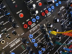

I've bananafied an assortment of frac and euro and went with the Serge color scheme because I was already used to it.

While we're on the topic of specs for Banana jack SDIY, what about tackling the issue of modules designed to use switched jacks, and converting them for bananas?
I run into this quite often -- I generally add a toggle switch, extra jack, a push/pull pot, etc. as works with the module, but I wonder if any of you have any other ideas or suggestions? For example, does a simple signal detecting circuit exist that could trigger an electronic switch for this kind of purpose?
peng
Joined: Feb 23, 2006
Posts: 111
PostPosted: Tue Mar 24, 2009 9:48 am    Post subject: Reply with quote  Mark this post and the followings unread
I've used shorting double plugs on a lot of modules. The frac version of the Delta VCF can also use a shorting plug between the VCF out jack and the VCA in jack. The jacks have to be spaced 0.750" apart. I have always thought these would be great in stand alone type instruments and the Buchla Music Easel uses them to great effect.
The other way I've done it is with toggle switches but, for me, a switch is the most expensive panel component so I try to be conservative with how many I use (!). On the other hand, a switch is playable and can be used to good effect.
As far as a special circuit goes...I'm not having any great ideas. Maybe a comparator(s) to sense if the input signal deviates from 0V which turn on the jack input and turn off the 'normalled' input?
p.
 Filesize:  49.26 KB
 Viewed:  21610 Time(s)
 Filesize:  131.51 KB
 Viewed:  371 Time(s)
peng
Posts: 111
PostPosted: Tue Mar 24, 2009 9:51 am    Post subject: Reply with quote  Mark this post and the followings unread
I should have added: Turn on and off an analog IC switch.
