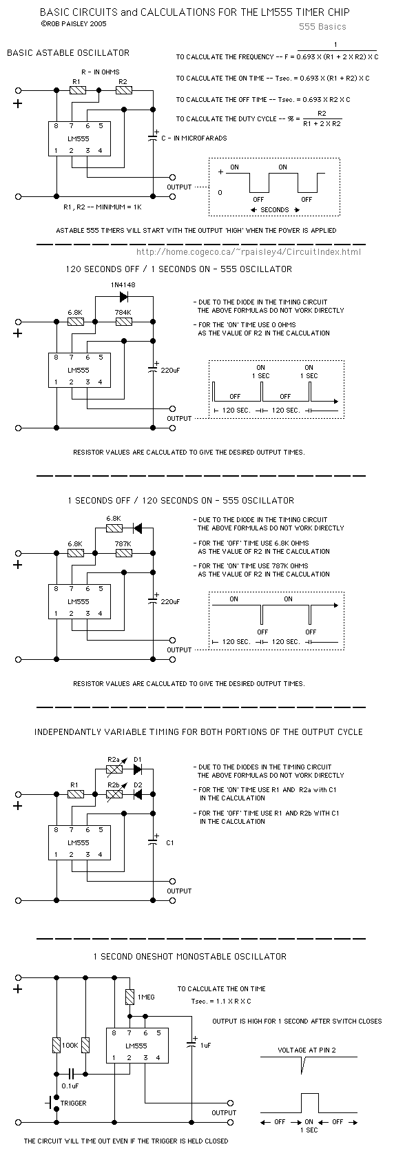

hi you all,
It's my first post on electro-forum!!!
Do you know about a hack to disable the autopower off feature on the Casio SK 1 or SK 5? I tried to tie T5 to the ground unsuccessfully, the main chip seems to shut down after 8 minutes anyway, even when the general psu circuit stays active.
thanks
best
Maxime |

Hi Maxime,
The original site with the SK-1 auto power off disable is here:
http://www.electri-fire.com/sk1pagesoverview.htm
As for the SK5/SK8, they can't be disabled by this method - i've tried in vain over a long time. The reason is that the SK5/8 have a "smarter" processor than the SK-1 that, although you can do the same mod to them to disable it, will still fall asleep after the allocated 7 mins. The rest of the keyboard will be awake still if you do the mod to it, but it's useless without the processor awake to operate the keyboard.
The best workaround method for the SK5/8 is to activate a key or button every 6 or so mins - just before the APO shuts the keyboard off. This can be done automatically by using a simple 555 timer circuit and a tiny reed relay or something that is hooked up to a relatively unused button on the keyboard - such as the STOP button on the rhythm (this assumes you don't use the internal sequencer/rhythms - otherwise choose another button). The circuit "pings" the switch every 6 mins or so. This will keep the keyboard awake.
Cheers, Graham |

HEllo Graham,
I will try your route on the sk1. the same circuit as sk5/8 is used on it. the keyboard shuts down at 8 minutes, even if the psu is kept awake..
the electri-fire mod doesn't work on my sk1, because of the smart processor also.
thanks a lot
Maxime |

Posted: Thu Feb 05, 2009 2:51 pm Post subject:
Hey, that's great news! Glad that circuit worked out - thanks for posting the 555 schematic.
Cheers, Graham |
