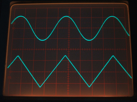

new saw-core VCO board i made a few days ago.. and derived tri and sine in testing this is a serge-sized board for a panel i am making.

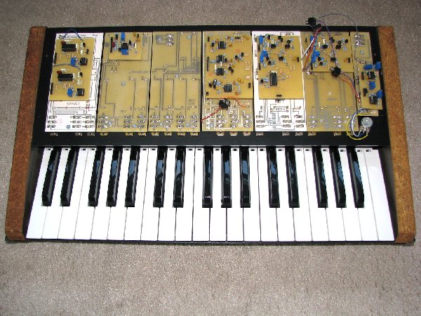

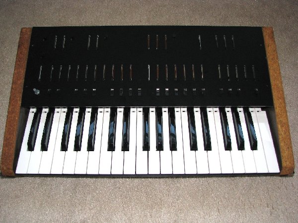

I had a beat up Jen SX1000, a truly dreadful synth, but the case was the perfect size. I had the panel made by Front Panel Express (currently looking for a cheap screen printing company).
Everything is identical to the Oddy except for the envelope generators, I had problems getting 1Meg 30mm sliders needed for the original design, so I opted for a couple of CEM3310 ADSR's so I could use 100k sliders instead.
The keyboard is from an M-Audio controller, feeding a Midimplant CV converter, so I can switch from keyboard to external midi control whenever I want... not duophonic though, but I can live with that.
I've got to find time to recover the case in tolex, but I've also got some brown leather left over from renovating my MkIII Odyssey, so I'll slap that on the sides as a token gesture, then probably flog it on ebay

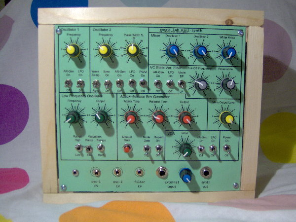

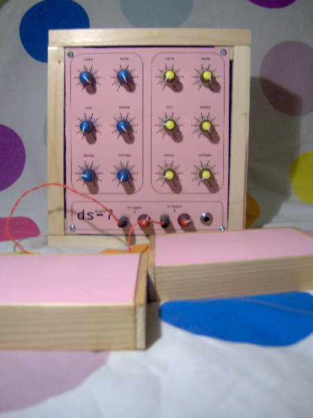

2010 is just one month old and already I have completed my two most ambitious projects to date.
many thanks to uncle krunkus for such a great stripboard layout for the DS7 and everyone else for inspiring me to get of my arse and finish some projects.
