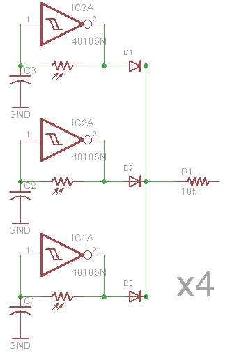

tjookum
Joined: May 25, 2010
Posts: 360
Audio files: 26
PostPosted: Sat Dec 24, 2011 2:50 am    Post subject: Reply with quote  Mark this post and the followings unread
Here you go jingle joe.
You repeat the circuit 4 times with all kinds of different cap values, between 0.01uF up to 10uF are all good. Then tie the 4 resistors together and enjoy. You can experiment with more diodes, less resistors, other diodes, leds, etc.
I wonder what the practical, sensible limit on oscillator number is...
good question, I guess until it starts sounding worse than 1 oscillator ago?

Thankyou tjookum Very Happy I thought you might use a diode OR gate, simple and elegant again, I need to try and keep things simpler in mine too.

Speaking of white noise, when I first started working on this present contraption, it had an XOR chip in it instead of a NAND and it's sound was more like tuning a radio, but more like the sound of five radios being tuned at once, and the static had this heterodyne beating sound to it. Really pretty cool.
Also, thanks tjookum, that looks way simpler than I had imagined too. I kinda want to whip up another drone machine sometime soon, so I'll probably start with that!

tjookum, I'll look into the tri wave thing soon. That sounds right up my alley. Same with the XOR one! I've got a quick question about the XOR noisemaker though. What is the idea behind buffering the oscillators?
JingleJoe
Joined: Nov 10, 2011
Posts: 878
Location: Lancashire, England
PostPosted: Sun Dec 25, 2011 1:26 pm    Post subject: Reply with quote  Mark this post and the followings unread
probably to make the wave voltage logic level, as the XOR doesn't have schmitt inputs (we could make a fun oscillator with it if it did!) and the output of a lunetta schmitt osc is usually a bit crap from a logic level perspective, especially at high frequencies.
Kabzoer
Joined: Feb 07, 2011
Posts: 82
Location: Belgium
PostPosted: Mon Dec 26, 2011 2:11 pm    Post subject: Reply with quote  Mark this post and the followings unread
The noise generator XOR thing seems to work fine without the buffers. The outputs of the XORs oscillate at high frequencies, even when you give low-frequency inputs.
http://soundcloud.com/contraspect
JingleJoe
Posts: 878
PostPosted: Mon Dec 26, 2011 4:52 pm    Post subject: Reply with quote  Mark this post and the followings unread
Ah that is what my simulations revealed, I thought they were wrong, but this could be acheived by gating a high frequency 4093 NAND oscillator with an XOR too, the four XOR gate method seems a bit over the top to me thinking but whatever boats your float. Laughing
Spacebones
Joined: Jul 12, 2011
Posts: 15
Location: Utah
PostPosted: Fri Dec 30, 2011 11:11 am    Post subject: Reply with quote  Mark this post and the followings unread
tjookum, I'm having a hell of a time finding that 4069 Triwave oscillator... Would you happen to have a schematic or a link?
Psyingo
Joined: Jun 11, 2009
Posts: 248
PostPosted: Fri Dec 30, 2011 2:07 pm    Post subject: Reply with quote  Mark this post and the followings unread
here it is: http://home1.gte.net/res0658s/fatman/4069_lfo.html
