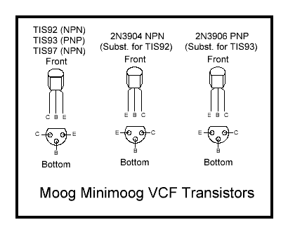

The schematics state that:
2N3904 = TIS92
2N3906 = TIS93
BUT TIS97 = TIS97
Here are the Pinouts of the transistors for reference in case you need to try a substitute.
 Filesize:  7.43 KB
 Viewed:  8585 Time(s)

To take a shot at my own question, it might simply be the pinout?
