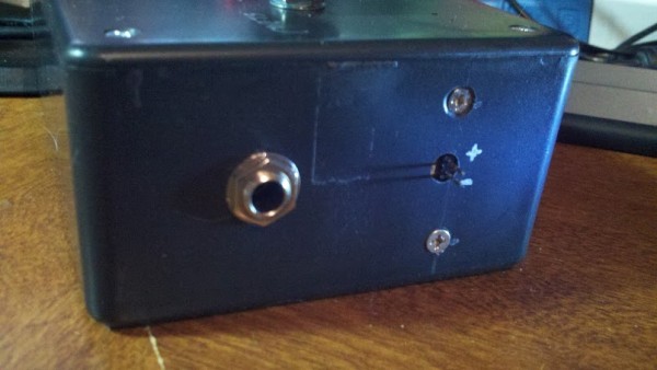

I wanted to build the Oscillator Calibration tool...but I didn't have a 9.1V Zener or a CD4520... So I broke it up and put it back together again, and what I have appears to work well (on breadboard at least). Very nice 1V/step....
I use a +/- 15V supply. I started to use an 8.2V Zener, but then it seemed I would have trouble getting to 1V/Oct because the ladder output was only stepping 800mv. I didn't want to mess around with the gain of the op amp stages, so I went to a 12V Zener. That gave me about 1.2V/step out of the resistor ladder, but that's what the trim is for. Smile What I found though was that the divisions in the Step Voltage Trim were such that I couldn't get down to 7V. So I pulled that apart too and ended up using a 50K trim and a 50K top resistor.
Of course I get ahead of myself. I used a CD4024 for my clock, and aside from the different pinout, it works exactly the same.
And backing up further, for whatever reason the slowest step on the running clock was well less than a second, which seemed way too short to me, so I increased the cap C5 to 10uF so I could get really slow stepping, but still have reasonably fast (I haven't timed it exactly).

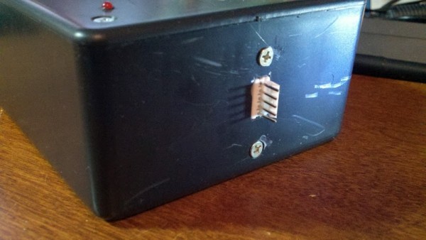

I'm going to add a pin-header out in addition to the jack, so I can use this easily with breadboarding, and an LED blinking along with the clock just for visual feedback on the speed. I'm considering whether I want to put in a manual reset to zero so I can start stepping at the bottom, because when it powers up it seems to be somewhat random.
I plan to post the final enclosure over on the builds thread. I'm feeling pretty pleased that despite being new to all this stuff and being many years out of practice with electronics, I can still figure out ways around my material limitations....
PostPosted: Sun Apr 15, 2012 10:42 pm    Post subject: Reply with quote  Mark this post and the followings unread
Aaaand pretty unpleased that I am not so proficient working on the plastic I'm using for the project box...split the lid and made it unusable, going to have to run and get another tomorrow.
Remember: Go Slow, and clamp it down as close to the bit as possible. Smile

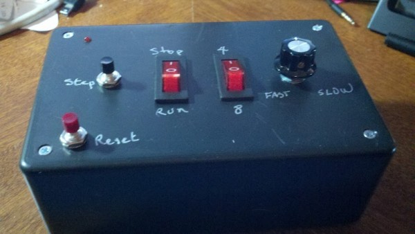

PostPosted: Sat May 05, 2012 6:34 am    Post subject: Reply with quote  Mark this post and the followings unread
Yah, I finished it, posted pics to the build thread, but I'll attach some here too. About 2 minutes into using it for the first time I realized a down switch would be really useful, wish I'd thought of that before hand Smile.
I'm not sure if the 7809 would work or not. I tried to re-regulate a 5V supply with a 7805 and that didn't work at all, however, with a 12V or higher supply, a 7809 should have enough headroom to work correctly.
The lid was cracking because as the bit came through the other side of the plastic and into the wood, the edge would grab it and pull it up. The mistake was 1) clamping too far away from the hole and 2) going too fast through the material which makes that catch worse. I realized I could use a stick of scrap as a caul and be able to clamp it exactly next to the hole...it doesn't entirely prevent the catch, but it keeps the lift from trying to bend the lid half way across, which his when it cracks.

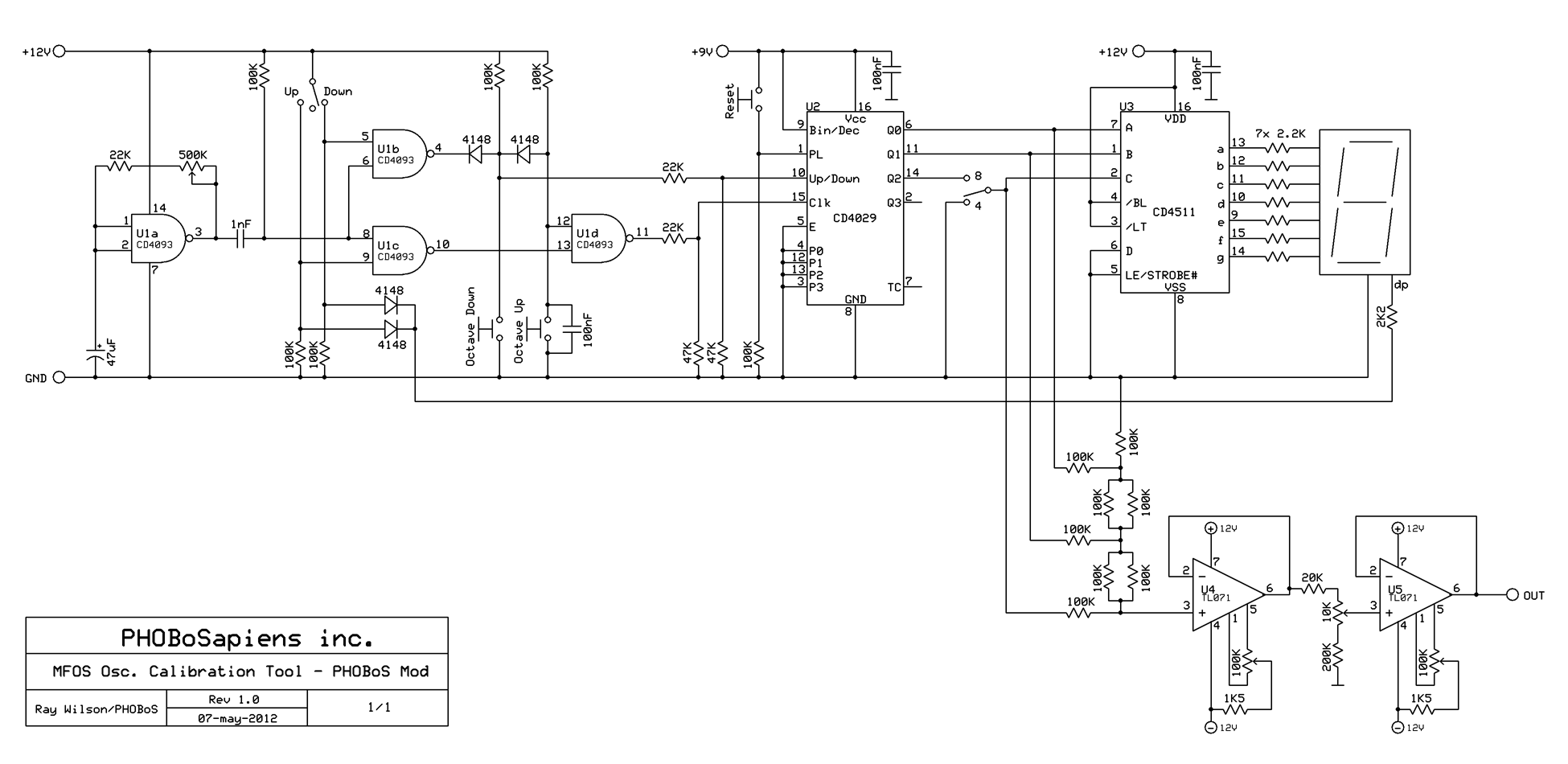

PostPosted: Mon May 07, 2012 4:26 pm    Post subject: more mods
Subject description: circuit pr0n
kvitekp wrote:
I've replaced 9.1V zener with LM4040CIZ-10.0-ND part which is Precision Shunt Voltage Reference
with .1% tolerance and pretty low temperature coefficient (100ppm/C) in TO-92 package.
I'll see if I can locate it somewhere, allthough so far the 7809 seems to work fine for me. It still had the same
voltages when i switched it on today, and I don't have the tools to measure mV's or less anyway. Rolling Eyes
here's what i got sofar: (see schematic at the bottom)
starting on the left side, there's the oscillator. I didn't look at the original schematic when I wired it up,
just selected some values that I think produce a usefull range for testing. I added a cap and a resistor to
the ouput to convert the square into a pulse, this way you can still use the up/down buttons in between steps.
the oscillator is followed by 2 NAND gates which function as 2
voltage controlled switches.
(this is also why I didn't use a 40106). The reason for adding these is so that I can now turn the dot on the display
on with the same switch. Cool I tried a blinking dot to display the oscillator speed but that turned out not
to be very usefull, especially at low step speeds.
Next are the Up/Down switches. U1d is used as a debounce circuit in combination with the 100K and
100nF cap on pin 12. This provides a clean CLK signal when using the Octave Up/Down buttons.
The 22K/47k resistors on the CLK and Up/Down inputs of the 4029 are voltage dividers since it makes
more sense to me to power the oscillator from the 12V line to keep possible noise of the 9V line.
I don't think the 47k resistors to ground are actually necessary but I placed them there just in case.
(haven't tested it yet like this and just noticed the Up/Down pin is either connected to GND or 12V by
a 100K resistor so I'll look into that)
not much to say about how the 4029 is wired except that I used the parallel inputs to create a reset pin.
the 4/8 steps switch is a bit different then in the original schematic. Instead of actually resetting the
counter (which doesn't work when counting backwards) I just tie the 3rd bit to ground. This might produce
a different voltage since actual GND could be slightly different then a low output of the 4029 (?!). But I wasn't
able to measure it.
nothing special about the display driver chip, I used what I had in this case a 4511 CC driver. You can change
the 2K2 resistors to whatever works with the display.
I only used 100K resistors for the R/2R ladder since I find that easier to match and the rest of the circuit is
the part that's still original.

PostPosted: Mon May 07, 2012 7:10 pm    Post subject: Reply with quote  Mark this post and the followings unread
Dat's a nice schematic, which editor do you use?
Posts: 5881
PostPosted: Tue May 08, 2012 5:15 am    Post subject: Reply with quote  Mark this post and the followings unread
the schematic is drawn with ExpressSCH

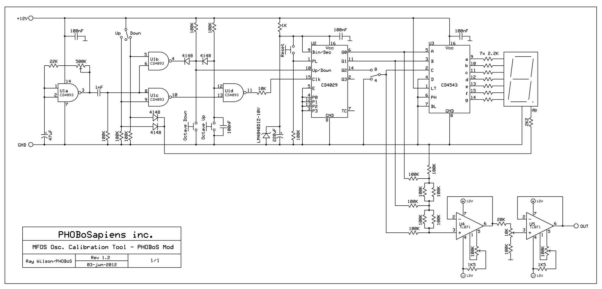

PostPosted: Sun May 27, 2012 5:15 pm    Post subject: updated schematic Reply with quote  Mark this post and the followings unread
here's an updated schematic with the LM4040DIZ-10V in place, I had to replace the 200k resistor with a
100k aswell for a good range. It's still on breadboard but seems to work fine. Thanks for the suggestion Smile
I also replaced the display driver with one that has a nicer 6 (and 9 but you won't see that).
edit:
Embarassed I noticed 2 errors in the schematic so here's the updated version.
I almost finished it, just have to do some final painting and then I'll post a pic bigsmurf

Posts: 5881
PostPosted: Sun Jun 03, 2012 12:29 pm    Post subject: finished build Reply with quote  Mark this post and the followings unread
finished it and posted some pics here
I had to do one final mod because as i expected there's a difference betweeen a direct GND connection
and a low CMOS output. So when switched to 0-3 steps I got a slightly lower voltage then 0-7 steps.
I solved this by connecting 0-3 steps side of the switch to a 1K pot, which has one side wired to GND
and the other side with a 1M series resistor to the 10V reference voltage, instead of directly to GND.

Cool! Looks awesome. What happens if it's free running and you hit one of the up/down buttons by accident? Wink
Posts: 5881
PostPosted: Sun Jun 03, 2012 2:23 pm    Post subject: Reply with quote  Mark this post and the followings unread
with free running I suppose you mean when it steps by means of the oscillator. I designed the circuit so you
can use the buttons just the same. So if it's counting up and you want to go a step back you just press the down button.
(and it will hold as long as you keep the button pressed)
PostPosted: Sun Jun 03, 2012 5:41 pm    Post subject: Reply with quote  Mark this post and the followings unread
Cool Smile
Was just a silly question that struck me, but that great. And yeah, by free running I meant oscillator stepping rather than manual stepping.
