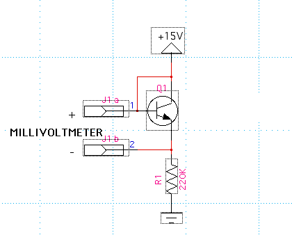

for the diode test this is what i need to do?
take an NPN transistor, connect the base to the collector, switch your DVM to diode test and connect the positive lead to collector and negative to emitter
if yes...i did it and it gave the number 637, is that the Vbe?
(its moves now from 638 to 639)
thank you for the link it helped me!
does the pic attached method is more accurate?
can the power be 12V instead 15V?
need to be AC or DC?
sorry for lots of questions, still learning.

Yes this is the voltage drop of the diode junction between base and emitter and as such corresponds to Vbe. 637 means 637mV. If your transistors are within 637 to 639 then this is OK they are matched.
Concerning the schemo you can use 9V, 12V or 15V it does not matter provided that you run the comparison with same voltage source no need to change th resistor value and obviously we are dealing with DC here Wink
Yves

PostPosted: Mon Sep 24, 2012 12:17 pm    Post subject: Reply with quote  Mark this post and the followings unread
you are a life saver! thank you very much!
you dont know how frustrating it is to not know electronics and want to build the world Confused
but hey... i'm learning Smile
last question...
does the HFE needs to be matched as well?
infect...in what situation i need a Vbe matched and in what situation i need HFE matched?
are there modules that need both Vbe and HFE matching?
yusynth
Joined: Nov 24, 2005
Posts: 1314
PostPosted: Mon Sep 24, 2012 12:21 pm    Post subject: Reply with quote  Mark this post and the followings unread
HFe is only involved when gain amplification is at stack, Vbe matching is involved for low current application such as current mirrors and differential input stages.
