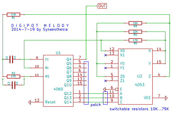

Yesterday I was trying to create a simple circuit to control the frequency of the 4060 oscillator, and I just couldn't get it right. All my attempts at using a transistor as a variable resistor failed miserably. (Can anybody show me how this is properly done? I am sure that this must be possible. The problem seems to be that both ends need to be floating for the 4060. I found schematics using a FET, but all assume that one end must be at a constant voltage level. This is not the case in the 4060 oscillator.)

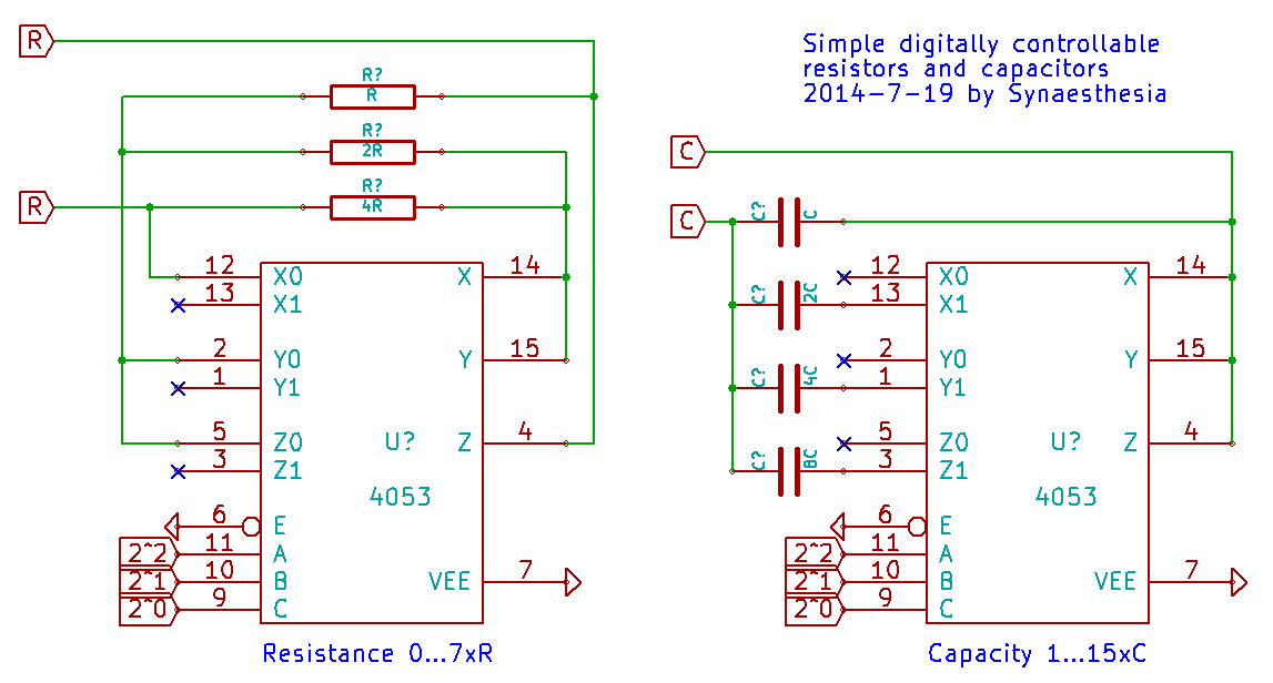

Finally I decided to try something completely different and came up with a simple schematic for a digitally controllable resistor. It is not continuous, but changes resistance in steps. Kind of a poor man's digipot. The idea is to use resistors from a series of 1x, 2x 4x of a base value and an analog switch to combine them to the desired value. I am using the 4053 for that and it gives you 8 different values. I could have used the 4066 and get 16 values, but I also wanted to be able to have a low resistance for a low control input (000) and a high resistance for a high input (111). This can simply be done by using the low-active switch inputs for the 4053 to short individual resistors from the series. With a 4066 I would need another four inverters to do that.
The analog switches have a small resistance of 500 Ohms even if closed, which introduces a small error. However, this doesn't hurt much, because I also chose resistor values that are not exactly at R, 2R, 4R. To keep it simple, I am using values from the 1, 2.2, 4.7 series, so for example 10K, 22K and 47K. This gives me 8 steps and is good enough for controlling the oscillator. With two 4053s you could get 64 steps controlled by 6 bits. Not too bad.
The idea is simple and versatile (and of course has been invented before). If you switch resistors in series, you get a switchable network with a linear response. You can also put them in parallel to a fixed value, which gives you a logarithmic response. And here comes the best part: you can do that with capacitors as well. In that case you want to put them in parallel, and that means the 4066 is an option again.

With the digitally controllable resistor network I finished the circuit idea I had. It's a simple melody/tone generator using a 4060 counter. The counter outputs are patched to the three control inputs of a 4053, which varies the resistance for the 4060 oscillator in turn. Patching the three lines to the counter outputs gives you a range of nice, warbling, stepped tone sequences. The sound file starts with the default wiring from the schematic. After a few seconds into the recording I started to alter the patches to change the tones.
One thing annoyed me when putting this together on a breadboard. The RS resistor for the 4060 at pin11 seems to be quite "hot". It is extremely sensitive to the touch and initially I got lots of unwanted noise in the output because of it. No idea why, but a condensator with 1nF in parallel to it fixed that.

For a JFET to act as a resistor Vgs > Vth & Vds < (Vgs - Vth)
So, the voltage difference between the gate and source has to be above the threshold AND the voltage between drain and source has to be lower than Vgs minus the threshold.
Calculating the actual resistance is very tricky because there is a huge variation in Idss for JFETs. However, one thing that is cool is that JFETs are reversible so drain and source are interchangeable.
You can do the same with MOSFETs (and I think the requirements are the same) but you can only use them in one direction because there is a built in diode.
As for using a BJT, it's kind of tougher. You can also use them reversibly, but you need to figure out and calculate how much current it is going to be drawing to figure out what kind of resistance it "looks" like. Check out the Weird Sound Generator on the MFOS site though. It uses transistors for FM of some 40106 oscillators.
