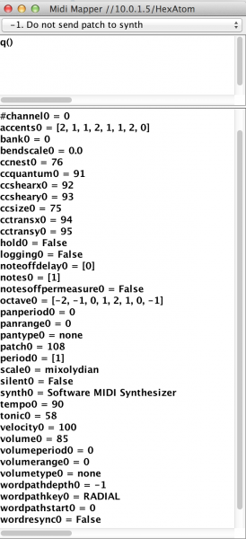

Am about a third of the way through the recordings in this thread, and loving it so far. Thanks for posting.
My contribution is a MOV video over on FB that I posted this morning. I tried converting to MPEG2 using Adobe Premier Pro, but it drops the right audio channel no matter what I do, so I gave up. You may need Quicktime to view it.
This is the current version of this HexAtom software using built-in Java library soft synths that I started using with Scrabble-to-MIDI back in 2009. For NYE2014-15 I plan to use this approach with AAS physical modeling soft synths, haven't started working on the patches yet. The genesis of this approach goes back to the chess-to-just-intonation music that my son Jeremy & I performed in the NYE2007-08 webcast, which really took off after our discussion here of the Glass Bead Game.
The current state of HexAtom in the video is that the graphical atoms in the cellular automaton generate MIDI (the original mode of HexAtom), and also the generated MIDI notes generate and/or destroy graphical atoms. The latter part is new as of last summer. I used that at electro-music 2014, and am expanding it as I get time. Thus there is a feedback loop between graphical and MIDI audio domains.
Here is the jython patch used to automate this particular performance, which I wrote this morning

The pvf commands relate strongly to the feedback The probability of vacuum fluctuation value at the beginning of .077050 means that when a MIDI note feeds back into the cellular automaton (CA), there is a 70% probability (the third & fourth digits) that it will generate a new atom 7 semitones (the .07 -- affects color and MIDI pitch) above its original MIDI note, and a 50% probability that it will absorb the original atom. the 70-50 ratio is regenerative feedback. The later pvf12=.074070 (the 12 just means apply it to all 12 atomic numbers) makes this a degenerative 40%-70% ratio, and the final 10%-90% ratio kills the piece. Other transforms in the above rows change diameter of the space, skew and center of rotation of the atoms, and other properties of the CA.

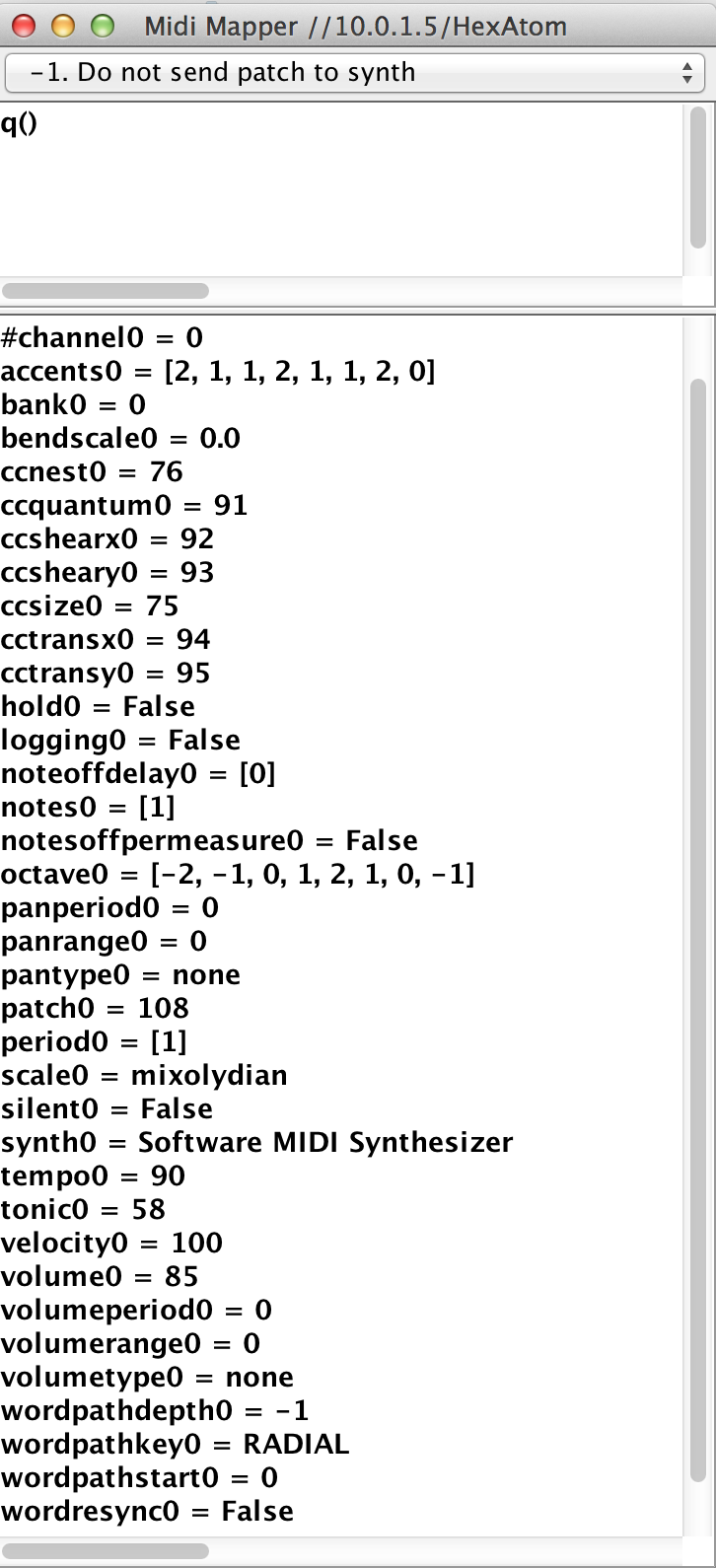

I am posting an MP3 for completeness, although watching the video in HD is the thing to do. I have also posted a screenshot of the CA-to-MIDI mapping GUI, which I didn't touch at all after starting the noodle.
[/code]
Screen shot of the atom-to-MIDI mapper. You can live code in Python.
