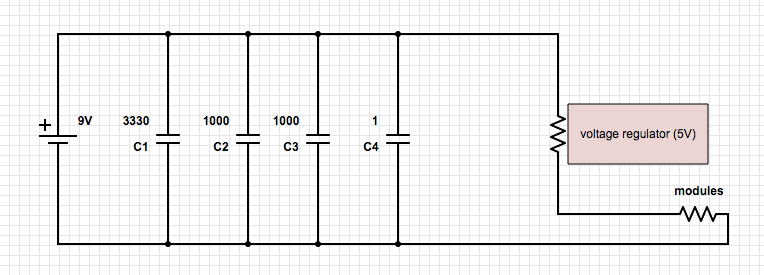

PostPosted: Fri Mar 06, 2015 9:22 am    Post subject: Reply with quote  Mark this post and the followings unread
Thanks for the explanations and suggestions– I think I'm starting to understand.
I've been experimenting with using capacitors and a voltage regulator (I only have one, a 5V 78## model) to try and alleviate my voltage issues.
Here's what I did this morning:
Instead of the 9V battery going directly into my 555 module and my op amp-based VCO, I put a bunch of capacitors in parallel (connecting + to -) and then a 5V voltage regulator. The power then connected to my 555 and VCO (see the schematic– I couldn't find a symbol for voltage regulator so I used a resistor).
The 555 is in astable mode so it's putting out pulses every few milliseconds (or seconds, depending on the potentiometers).
If the 555 is connected to an 8Ω speaker, the VCO saw wave stays constant (constant pitch).
If the 555 is NOT connected to an 8Ω speaker, the VCO saw wave varies along with the 555 (when the 555 is "on" the VCO gets less voltage).
On my multimeter I can watch what's happening; VCO only: 5 volts come out of the power. Add the 555: 5 volts when it isn't "on," then about 4 volts when it is on. As you can imagine this has quite an effect on the VCO.
Shouldn't the voltage regulator bump up the voltage back to 5V when the 555 gets hungry? There are 9V coming in so I'd think there is plenty of headroom... Maybe I don't understand how they work...
So... should I put parallel capacitors in the power supply as well as all my modules? How do I stop the 555 from sucking up so much voltage? A resistor between the supply and the 555 power input seems to help a little. Am I missing something here?
Right now I'm tempted to run everything on its own 9V battery, but I know that's not as practical (or eco-friendly) as running everything off a single supply.
Sorry to ask so many questions. I'm a real noob at this, and although I'm super excited to be making these sounds, I'm frustrated by these power issues.
those caps are all µF
 Filesize:  18.53 KB
 Viewed:  184 Time(s)
making stuff that makes sounds is awesome!
Music/fishing/adventures blog CB Fishes
music.chrisbeckstrom.com
piedwagtail
Joined: Apr 15, 2006
Posts: 297
Location: shoreditch
PostPosted: Sat Mar 07, 2015 1:15 am    Post subject: Reply with quote  Mark this post and the followings unread
Download a 7805 datasheet and peruse.
Note they insist on a capacitor to ground between the regulator and the load.
So on your diagram stick the regulator between your 1000uf caps.
Topics to research: impedance (regulator struggling with a low load impedance), reactance (of the capacitor), low pass filter (power supply filter capacitor).
Think about rivers, reservoirs , dams and household supply needs.

As shown in the datasheets, the capacitor on the output of a 7805 regulator should be 0.1uF. If you place the regulator between the 1000 uF caps (as shown in the drawing), the capacitor on the 7805 regulator output will be 1000 uF which is way too large.

They do all the characteristic tests with 0.1uf, that I certainly concur with.
That is the minimum to keep stability.

I've done the research and also have experience with these parts. The regulator is actually capable of fair stability without any capacitor on the output at all (this is clearly stated in more than one datasheet), however, they recommend the 0.1uF capacitor to reduce the RF effects of transient current requirements. Where the transient current requirements are large (200 mA step changes in current) a capacitor of 100 uF is suggested in at least one datasheet and not mentioned in others.
See this: http://forum.allaboutcircuits.com/attachments/lm340-7805-pdf.32522/ datasheet page 11. Note the diode across the input and output of the regulator to prevent damage from an input shorted to ground (remember - this is DIY). Here they describe the use of large capacitance on the output of the regulator. If the current transient's harmonic content is in the RF range, the smaller cap (100nF) does all the work to remove the RF (because electrolytics are very poor at doing that). Electrolytics are needed to mitigate large step changes in current which is probably not happening in the OP's circuit.

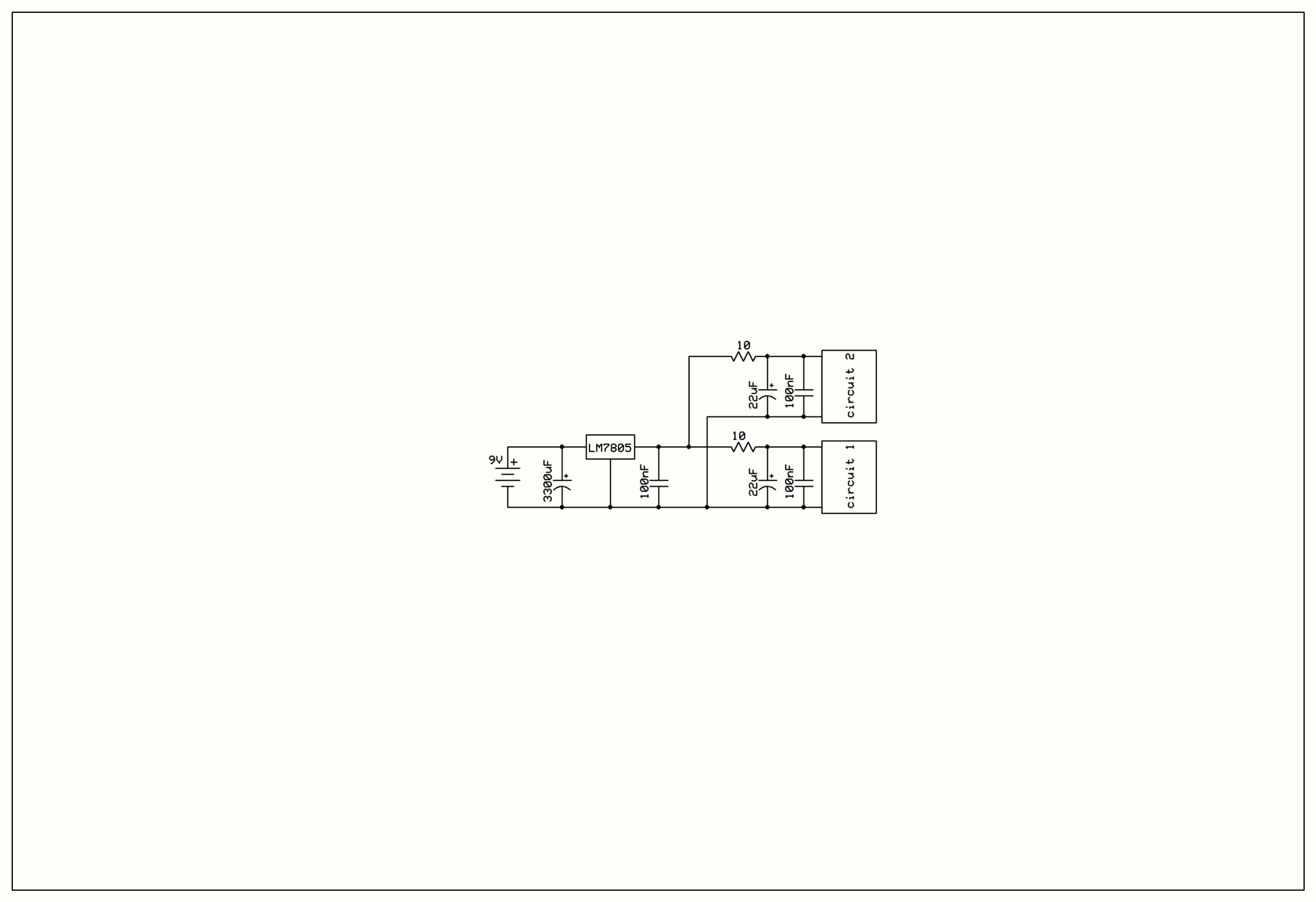

If I remember correctly the 100nF is to prevent oscillations, needs to be placed close to the regulator and is only needed
when there is a certain cable length attached to it.
I'd still use decoupling caps for the circuits themselves. 1000uF is too large for most applications and the 7805 might have a problem with it.
I usually use something in the range of 10uF-47uF but since you're using 555's and driving a speaker you might need something larger.
you stated that placing a resistor between the power and the circuit seems to help somewhat and this is not an uncommon practice
using some 10ohm resistors in series with each circuit might help you out here.
I'm kinda surprised it's more stable with a speaker than without, I would expect it to be the other way around scratch
power distribution example
