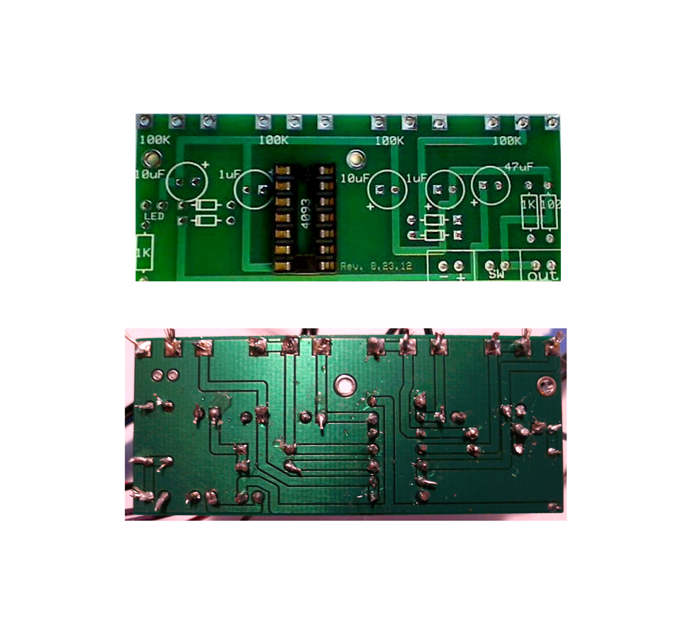

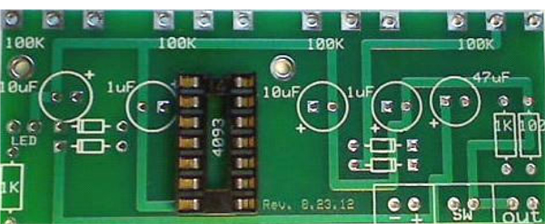

PostPosted: Thu Apr 02, 2015 8:52 am    Post subject: Reply with quote  Mark this post and the followings unread
Thanks for the reply!
so, i attached the front and back of the board (please excuse the beginner solder job).
i'm going to go with a 2 pole 6 position switch for now, i also attached a drawing of how my brain is understanding the circuit...am i thinking about this correctly?
please let me know what suggestions you have as far as range of capacitors go. i'll keep switch position (1) as the initial 1uf and 10uf that is noted on the board, and raise cap values for switch position 2 through 6.
really, thanks for your help. it's a bit intimidating, but a lot of fun.

Posts: 5881
PostPosted: Thu Apr 02, 2015 4:44 pm    Post subject: Reply with quote  Mark this post and the followings unread
spectreman wrote:
wait...i'm making this too complicated i think.
on the board, the 10uf caps modulate the 1uf, right? so i just need the switch i'm adding to go to the (2) spots labeled 10uf.
i think this new drawing is correct...
you almost got it, you just need to flip the wires going to the PCB. (it's an improvement over the previous one though)
So from the PCB you take the + side of where the capacitor was to the switch contact and wire all the + sides of the capacitors you're
adding to the switch. and all the - sides of the capacitors are connected together and to the - side of where the capacitor was on the PCB.
however it's not the 10uF's modulating the 1uf's which is why I needed the photos. I had 2 ideas of how it would most likely be connected:
1: 4 seperate oscillators just mixed together with the diodes.
2: two groups of 2 oscillators with the low frequency ones (10uF) modulating the higher frequency ones (1uF)
And as it turns out it's number 1. They still cause a modulation effect though.
So you might want 2 of those switches which makes it possible to change all the capacitors. but that's up to you.
I'll do some tests myself to see what are the most useful combinations.

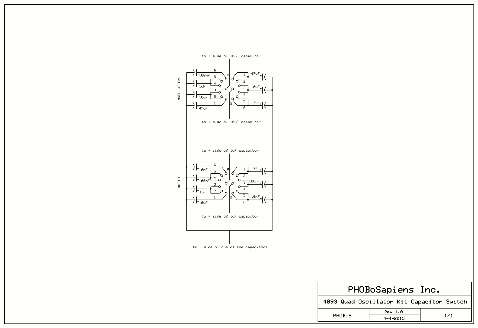

Posts: 5881
PostPosted: Sat Apr 04, 2015 9:43 am    Post subject: Reply with quote  Mark this post and the followings unread
ok I just did some tests with it. Good thing I looked at the BOM pdf on the GetLoFi site or I wouldn't have known
that those diodes are actually zenerdiodes, which makes some difference in sound. It actually wouldn't even produce
any sound if those where standard diodes without adding an extra resistor.
so here's how I would connect up the switches, which gives you the following settings.
MODULATION SWITCH:
1) 47uF + 47uF
2) 47uF + 10uF
3) 10uF + 10uF
4) 10uF + 1uF
5) 1uF + 1uF
6) 1uF + 100nF
AUDIO SWITCH:
1) 10uF + 1uF
2) 1uF + 1uF
3) 1uF + 100nF
4) 100nF + 100nF
5) 100nF + 10nF
6) 10nF + 10nF
there are still some duplicate setting:
M.switch 4 + A.switch 2 = M.switch 5 + A.switch 1
M.switch 4 + A.switch 3 = M.switch 6 + A.switch 1
M.switch 5 + A.switch 1 = M.switch 4 + A.switch 2
M.switch 5 + A.switch 3 = M.switch 6 + A.switch 2
but this will give you a very wide range.
note: the 100nF + 10nF capacitors aren't actually polarized so it doesn't matter which way you connect them

spectreman
Joined: Mar 24, 2015
Posts: 12
Location: Milwaukee
PostPosted: Sat Apr 04, 2015 1:50 pm    Post subject: Reply with quote  Mark this post and the followings unread
oh man...you rule!
perfect.
i have to order some parts, but i'll post a photo when it's done. thanks a million for all the help...i appreciate your instruction and help more than you can imagine.

when 1 is high and 1 is low the voltage should be around 4.7V and when both are low the diodes are blocking it, but because the ouput is
connected to GND through a resistor it's probably 0V. So instead of having an output that is either 0 or 9V you'll get an extra voltage halfway
in between. So if you use zenerdiodes with a different voltage for each oscillator you might get more variation.
This only what I think is happening, I could be wrong.
1Watt zeners will probably work but a zenerdiode needs a certain current flowing throw it to properly work so I can't really tell how much
that would affect it.
spectreman
Posts: 12
Location: Milwaukee
PostPosted: Thu Apr 30, 2015 7:40 am    Post subject: Reply with quote  Mark this post and the followings unread
hey there again...
on you schematic, where you say "to + side of 10uf capacitor", you mean to the + side of where it is labeled on the getlofi board, correct?
i'm not actually going from the switch to a capacitor on the board, just to where a capacitor used to be on the board, right?
Posts: 5881
PostPosted: Thu Apr 30, 2015 9:12 am    Post subject: Reply with quote  Mark this post and the followings unread
yes, you got that correct.
