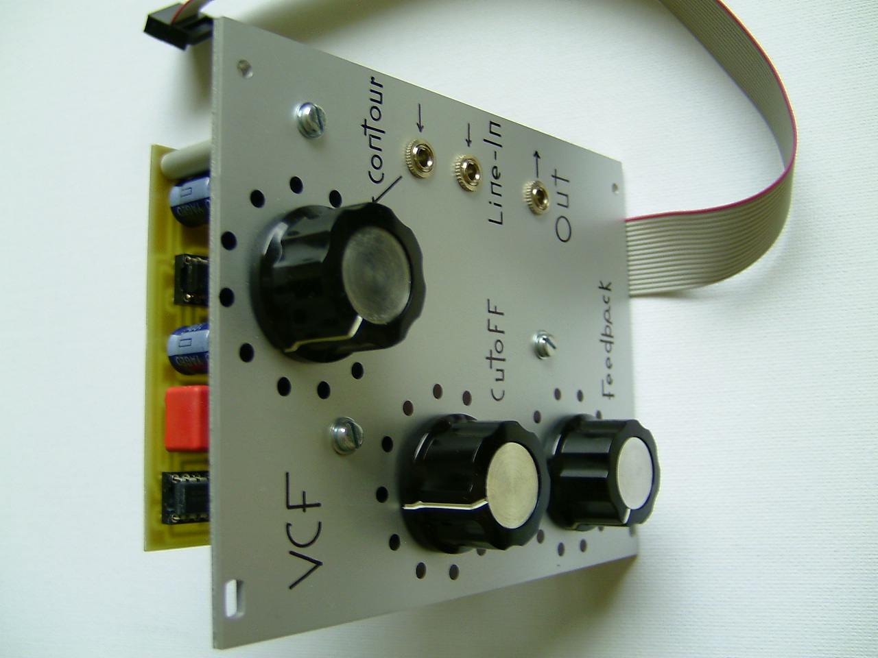

Subject description: Homemade vcf-module, a 4-pole voltage controlled lowpass filter
The Sallen-Key-Filter was invented in 1955 - long before Robert Moog's ladder filter! But it wasn't voltage controlled. I made a voltage control with 3 njfets for a 3-pole Sallen-Key-Filter. If you are interested, ask for a schemo.

Nice frontpanel

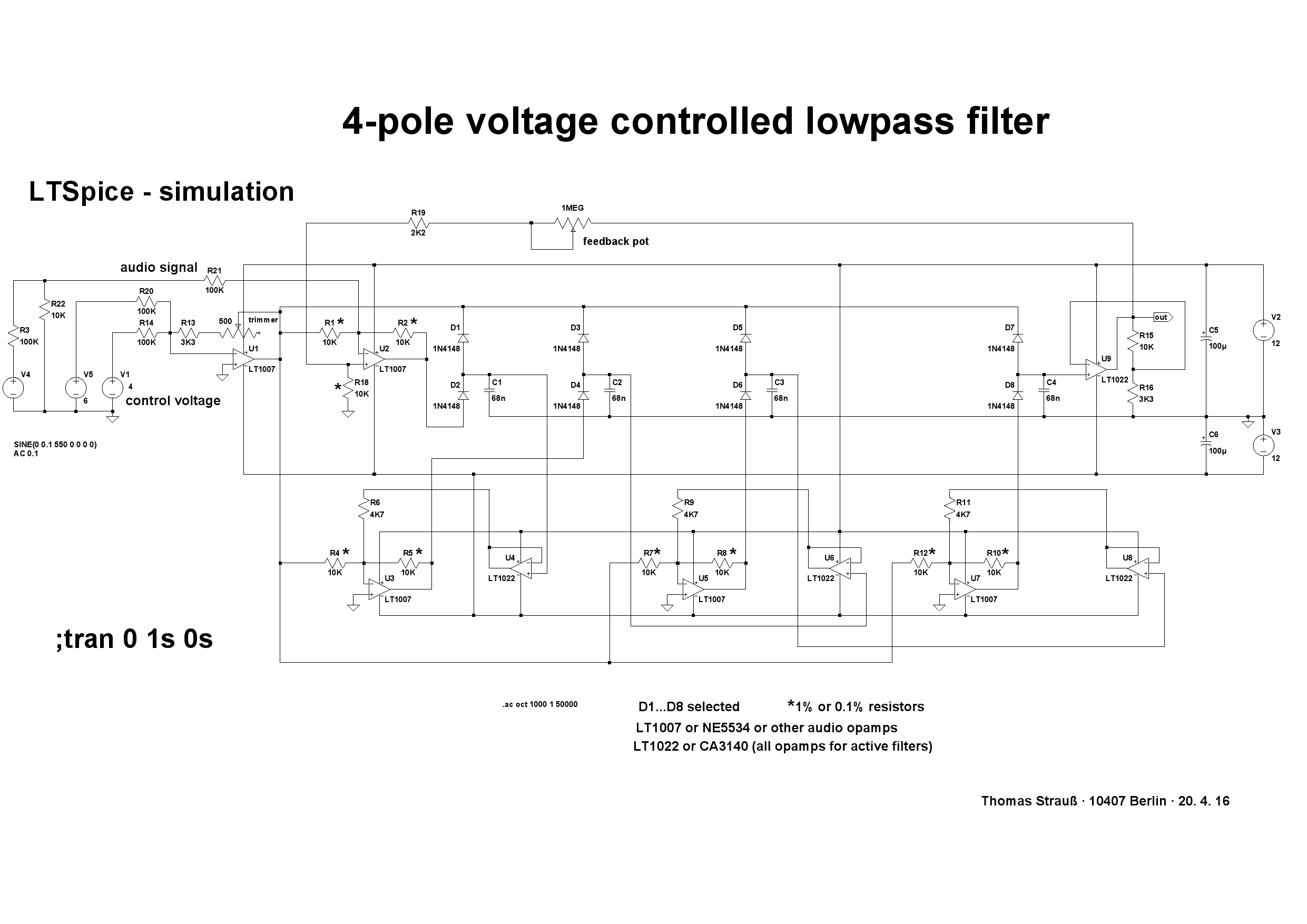

Hello gabbagabi,
yes, you can have the schematics for VCF-Modul, front parts, and the general purpose vcf - card for analog synthesizers.
To make the small numbers and signs visible, I printed the schemos in the format 1000mmX1000mm and smaller.
Thomas

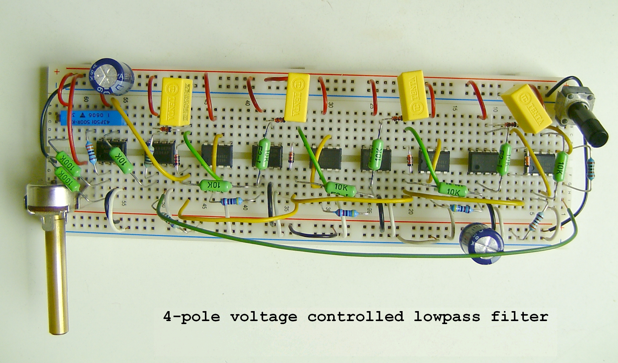

LTSpice simulation schemo
 Filesize:  74.06 KB
 Viewed:  628 Time(s)
breadboard model of 4-pole-filter (8-diode-filter)
 Filesize:  1.5 MB
 Viewed:  400 Time(s)
8-Dioden-Filter.pdf
Revision 1 - changed values of 5 resistors for better resonance behaviour (sine wave generation up to 20KHz)

The CV range is 0V to 10V?

Hello gabbagabi,
the control voltage is from 0...12V for the keyboard voltage, and 0...12V for the Cutoff-Voltage. The Cutoff-Voltage is regulated by a stereo-pot (2 X 10K lin), one for the Cutoff-Voltage, one for the ADSR-Voltage). The bigger the Cutoff-Voltage, the smaller the ADSR-Voltage and vice versa - this is to avoid an overdriving of the diodes.

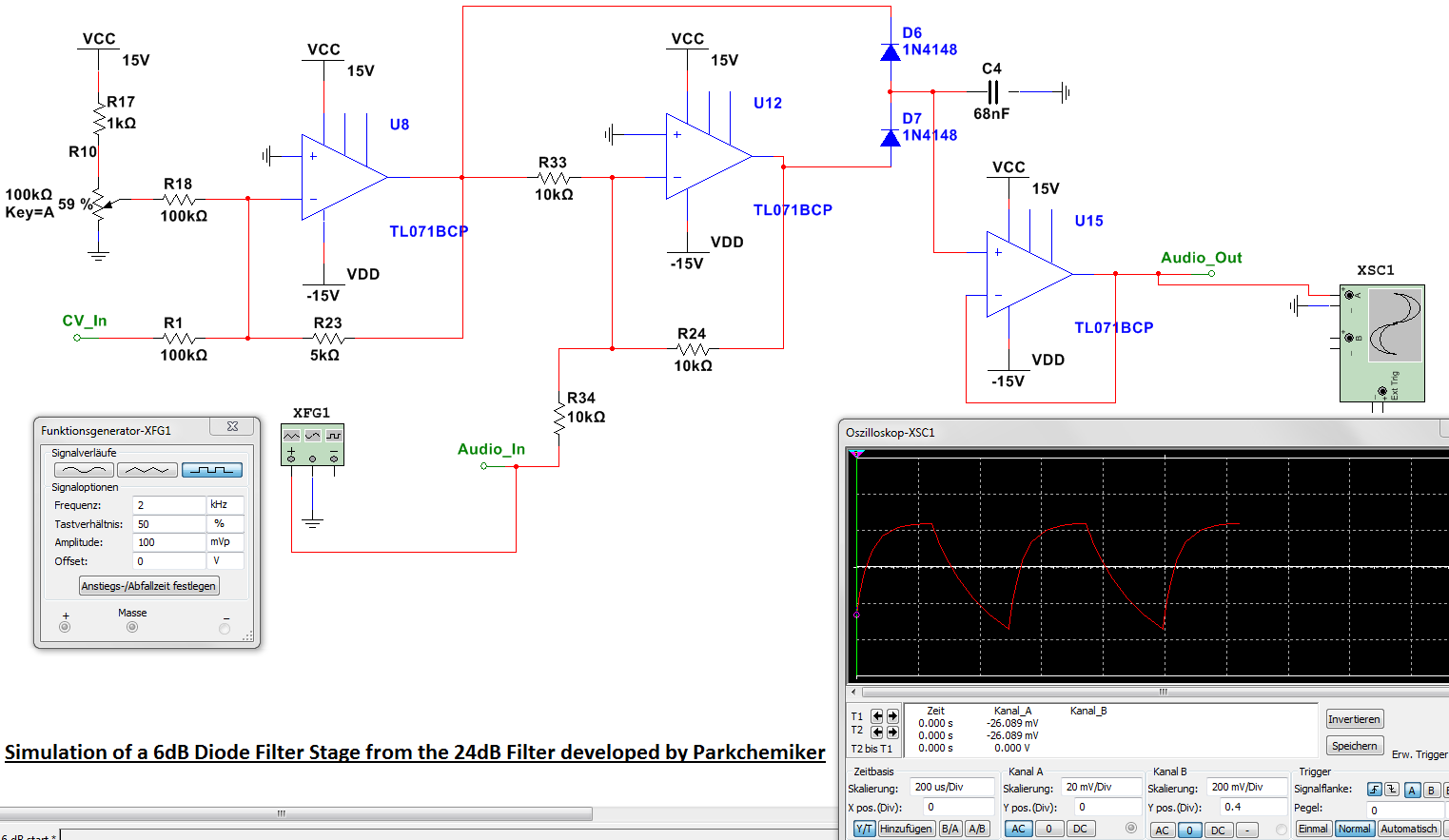

I have simulated your schema in Multisim and I was pleasantly surprised by the operation of the filter stage.
The following Breadboard test has the simulation fully confirmed.
I immediately had ideas for the use of the principle in other filter topologies.
If you do not mind I'll post it here on EM and refer to this thread.
Do you have a name for your filter?
cheers
gabbagabi
I'm sorry, but there is nothing new with this filter concept. Look at Steiner's 70's diode filter and you can see the same diode-C arrangement. Diode based VC-attenuators have a long history in VCA and VCF design and many variants exist. BTW you can improve distortion/dynamic range by putting 2 or more diodes in series or using LEDs (although matched LED pairs are much harder to select). Diode attenuators have the advantage, that you get the V/oct (exp.) for free, but temperature compensation is easier to get with matched transistors. That's why most diode ladder filters do not apply CV to the diodes but use an extra transistor based expo to control the diode current.
Nichts für ungut Wink

Hello gabbagabi,
I call the filter "diodenfilter".
My circuit uses diodes as voltage controlled resistors - this is not a new principle.
The filter capacitor is grounded in my circuit - what is not the case in the Steiner - filter.
I think the special about my "diodenfilter" is the minimum of electronic components and that only one half of the diode bridge is fed with an audio signal, what leads to another equivalent circuit as in related vcf-circuits.
This filter has a registered design:
Google: utility patent
cheers Parkchemiker
