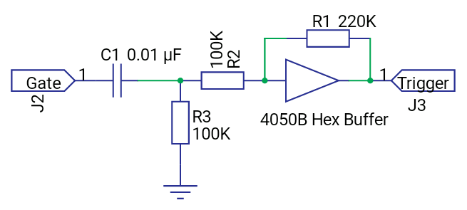

Another variation on the gate to trigger circuit is to use a buffer (4050B) wired as a Schmitt trigger. There is no need for the clamp diode as the chip has onebuit in at all of its inputs.
The values of C1 & R3 may need tweeked depending on your application ( they determine the length of the trigger pulse )

Hello Gasboss,
Your circuit works great in my Eurorack setup (off of a breadboard).
I'm planning to use all 6 circuits of the 4050b and build a module with 6 gates to triggers as I need them to trigger some modules that require short triggers.
Is there anything I should consider before building the circuit?
I'm an electronics newbie, so I may miss something crucial here.
Thank you for sharing your knowledge!

since this circuit triggers at the leading edge, maybe as an extra first invert the input signal using one of the schmit-triggers, than you have a trigger pulse at the trailing edge of the applied (Gate) signal.
