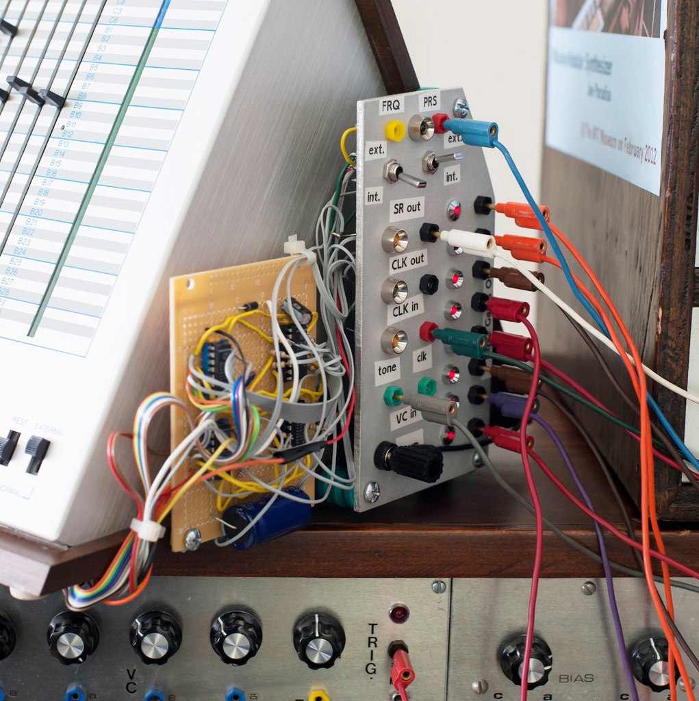

a few weeks ago AlanP posted this link to a javascript version of the Triadex Muse in the chatroom.
I immediately thought that it wouldn't be too hard to recreate with a handfull of CMOS chips and
after a couple of days I couldn't resist the urge any longer and started drawing up a schematic.
I made use of this blockdiagram, the user manual and the programming manual. I also tested this
windows version. To get the timing correct I actually watched some demo videos frame by frame as
both the javascript and windows versions aren't 100% true to the actual muse. But I've also noticed
that there seemed to be a difference between muses (they also have different colored lights).
On to the circuit..
The original muse has 1 switch for both auto and step mode. you could actually use a toggle switch that
returns to it's center position from one side but they can be a bit harder to come by so I added a seperate
step button instead. I didn't add a debouce circuit so if you would use it as it is it'll probably be all over the
place. I also used a seperate reset switch (an external signal could be used as well) and if you add the
inverter and diode it will also stop the oscillator. The C 1/2 output is inverted which I found out after watching
some videos. C1, C2, C4, C8 are just divisions of the CLK frequency. For the odd divisions C3, C6 an XOR
gate is used and it is based on the examples found here.
The other part of the control circuit is a large shifregister made by chaining a couple smaller ones. The data
input bit is selected with switches W, X, Y Z which are connected to a parity generator made with 3 XOR gates.
If there is an even number of 1's selected with the switches the output will be 0 if there is an odd number of
1's it will be 1. (I think this was incorrect in either the javascript or windows version). This combination of
shiftregisters and XOR gates actually foms a LFSR which could create some pretty long sequences.
In the original muse the outputs from switches A, B, C, D are connected to a DAC which is used to control a
VCO. Getting the tuning right could be rather tricky so I went for a different, full CMOS, method instead which
is starting with a very high frequency and dividing it down to get the correct notes. The same way I made the
Chromatic Melody Generator. Switch D is used to select the octave (0 = one octave lower) which is done with U10b.
One thing that I haven't fully figured out yet is how the rest switch on the Muse functions. In the manual it says
it replaces the lowest note with a pause but I am not sure if the lowest note is just the low C or the output of
switch A or actually the lowest note in the sequence. Although I think that would be rather hard to implement.
I guess I could check the javascript and windows versions to see what they do.
I am not intending to actually built it although it is tempting. But besides the long shiftregister I pretty much have
all the components already in my current lunetta system so I could patch up something similar. If you do plan on
making one you'll probably won't be able to get 40 position slide switches and I think the best substitute would be
2x40 pin headers in combination with jumpers. Of course you could also adjust the number of dividers and shift-
registers. I was actually thinking about making a mini-cmuse.

Blue Hell's intuition about odd parity is correct. At the bottom of page 2 it explicitly says that when all the theme slides produce 0's a one is clocked in.
In the section on tempo at the bottom of page 7 it says the tempo is doubled when you use the C1/2 setting on the sliders. This suggests the the raw oscillator is presented as C1/2 and then divided by two for the master clock C.
The description near the top of page 2 concerning note generation clearly talks about dividers so your implementation is clearly in keeping with the original. |
Joined: Jan 14, 2010 Posts: 5881 Location: Moon Base
Posted: Fri Mar 02, 2018 7:48 pm Post subject:
| Steveg wrote: | | At the bottom of page 2 it explicitly says that when all the theme slides produce 0's a one is clocked in. |
If I am reading it correct it seems the programming manual is actually contradicting itself.
at the bottom of page 2 it does indeed say:
| Quote: | | Since all Theme slides had a zero on them prior to the first beat and no ones is an even number, a one was shifted in. |
however on page 1 it says:
| Quote: | | If the four Theme slides have an even number of ones on them (i.e. 0, 2, or 4), then a zero is introduced into the first bit of the shift register at the next tempo beat. |
In the end it doesn't really matter of course, it's just meant to be used as inspiration and if anyone would
actually like to built it they can choose whatever they prefer or even add a switch for both options. (add
another XOR gate and you can even control it with a signal). _________________ "My perf, it's full of holes!"

Posted: Mon Jun 28, 2021 8:52 pm Post subject:
| In case anyone is interested, a Muse turns up in this video https://www.youtube.com/watch?v=cTCVm-Eo1F0 at 1:30 and a couple of times later. It is never mentioned but is obviously in use connected to Joseph Paradiso's giant modular synth. |
Steveg
Joined: Apr 23, 2015 Posts: 184 Location: Perth, Australia
Posted: Tue Jun 29, 2021 8:43 pm Post subject:
This page has some pictures of the interface and Joe's discussion of his interface philosophy (section 5.5): http://paradiso.media.mit.edu/ModularSynthsVoltageConnect-17-ReallyFinal.pdf
"With the Triadex Muse (the world’s first autonomous
sequencer product) [72], I can, for example, voltage-control the
pitch and clock rate, inject an external clock, have access to all
bits coming from the sequencer into the note-generating
priority encoder, and inject external bits into the sequencer. As
the Muse was probably inspired by Marvin’s hobby of
improvising fugues at the piano [73], the Muse is all about
melody and does nothing with timbre, as it just produces a
square wave. When married to my modular, however, the
Muse becomes a timbre and melody monster, producing thick
waves of dynamically changing sound in accordance with state
determined by the current patch"
And this is a class project inspired by the muse: http://paradiso.media.mit.edu/MusicalStateMachine/index.html
There may be more stuff buried in corners under other titles as I no longer have the concentration to read everything but it is a worthwhile page: http://paradiso.media.mit.edu/synth.html |
Steveg
Posted: Thu Jul 01, 2021 7:37 am Post subject:
I sent a query to Professor Joe Paradiso and he sent me a nice response and permission to reproduce it here. There is a close up image of the Muse interface wich I will attach when I remember how . Now over to Joe:
Yes, the Muse is a wonderful box - An Eddie Jobson piece just shuffled on yesterday when I was driving, and he was one of the few popular artists who used it quite a bit - I’m looking forward to using the Muse in another piece soon.
Yes, I have written bits about what I’ve done with it, and you may have found them - you probably saw the blurb I wrote about the interface to the Muse in the 2017 paper I did for the Berklee conference: http://paradiso.media.mit.edu/ModularSynthsVoltageConnect-17-ReallyFinal.pdf - it’s on pg. 10, where I had that photo of the muse mod - quoting myself from back then: 'With the Triadex Muse (the world’s first autonomous sequencer product) [72], I can, for example, voltage-control the pitch and clock rate, inject an external clock, have access to all bits coming from the sequencer into the note-generating priority encoder, and inject external bits into the sequencer.’ I’ll include the photo of the interface below - indeed, it does all that - I can also inject my own clock if I want (the Muse provides for that), plus I have the Muse’s clock on a separate output - I can also not only VC the pitch, but also put my own master high-frequency clock in for that if I want, I believe (I think that’s what the yellow ‘FRQ’ jack is, but it’s been a while). I’ve got the 6 bits coming out of the selector switches that I can route into my modular, but I can also interrupt one of them and insert my own signal to mess a bit with the sequence (don’t remember exactly what I do there - but that switch on the upper right lets me put my own bit into the priority encoder stream as opposed to just let it default to one of the sliders). When I built the interface to it, I took some rough notes, but there’s no detailed ’schematic’ as such - as I never had a proper schematic for the Muse to begin with away from the high-level diagram in the patent (even though Marvin was a good friend, and I met with Ed Fredkin when I started working it - they couldn’t find one!).
When I use it, as you can see in the photo below (taken from the patch I did for a big event we ran at the Lab - described here - https://resenv.media.mit.edu/SynthMuse/) the Muse is pretty heavily wedded to the synth - the logic outputs change sequences and patch coding on the synth proper while I pump a digital output occasionally into the Muse to torque its sequence, and I sometimes slow/speed/stop the clock on the Muse, or use the Muse clock as the master clock to drive everything happening on the Modular, or drive the Muse with my own sequencer clock. The patch on that site (this is the best version) https://resenv.media.mit.edu/SynthMuse/SynthMeetsMuse-Ex-1.mp3 is very Muse - it’s making one of the main complex sequences that comes in and out, and I think I made other sequences myself out of the bits coming out of the Muse - I used lots of logic in the patch and it was pretty complex. |
Steveg
Posted: Thu Jul 01, 2021 7:38 am Post subject:
The audio from the Muse is that iconic square wave - Marvin was all about melody, but didn’t really get timbre as well. Hence I mess heavily with it in the modular, filtering it of course, sometimes driving PLLs to messily track the sound, but also going through logic modules to selectively fatten it up, adding echoes/reverbs/delays, and all the other tricks - the Muse audio output can be in a patch in many places and sound different when different audio signal paths come into the mix. These days, I’m starting to hear hum on it, so put it though a comparator to clean it up (I have those on the modular too) - I’m probably going to take it apart before long and replace the filter capacitors in the power supply. I kick myself a bit for not doing it when I had it open to make the mod… I sometimes think of paralleling the bits on the priority encoder into an D/A converter so I can get a proper control voltage out of it and directly voice other oscillators - but I can in principle do that anytime, as I’ve broken those bits out already via the black jacks at right on the panel.
In the patch I did for the Plasma Fusion Center, the main Muse apparition is that gurgling arpeggio that comes in periodically - you can hear that I stop the clock a fair amount to hold notes, and it goes through many signal processing chains that fade in and out, but the gurgling filter is the most obvious one you can hear. You can also hear how I throw bits into the Muse to change the sequence there. I’ve got a long excerpt of it on BandCamp - https://joeparadiso.bandcamp.com/track/alcator
Yes, I think there are some demo videos floating around that the students posted where I go through the Muse interface that I think you found, but I use the Muse on almost every patch since I did the mod - it’s heavily in this one that I did a year ago January - https://joeparadiso.bandcamp.com/track/h-nggerberg-redux - but to be honest, I don’t remember exactly what’s Muse and what’s other sequencers - they are heavily interconnected there.
This piece is essentially all Muse - https://joeparadiso.bandcamp.com/track/your-bleepiness - it’s driving all kinds of things on the Modular, but everything comes from the Muse here. Not the easiest thing to listen to, but there are a few different modes in it…
OK - thanks for the interest, and hope this sheds a bit of light on how I use the Muse in different ways - it will continue in work I do later this year as I’ve finished my new studio and will be doing more down there soon (busy now building a new module I thought up around a formant generator I had as a kid, and enjoying playing the keyboards again - the synth can’t have all that fun on its own!).
Best -Joe-
