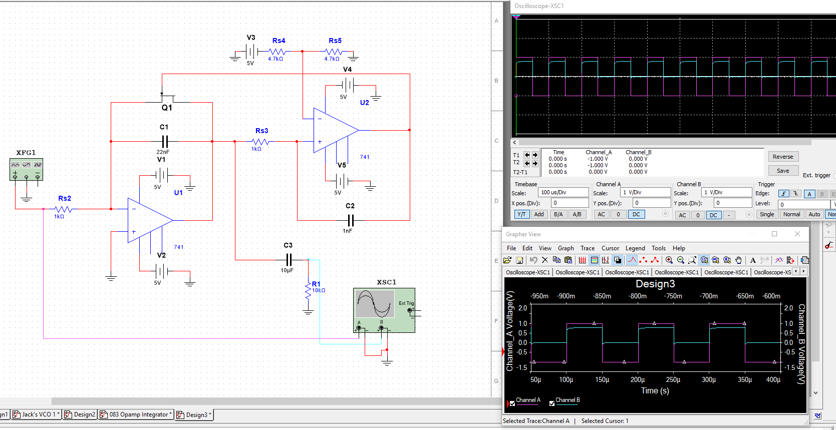

I am currently trying to design my own Analogue synthesiser, to better understand the theory behind each stage. I am working on a sawtooth VCO at the moment and seem to be having problems with the Multisim simulation. Any ideas why I am not outputting the correct sawtooth? The input will be from an exponential converter
A screen shot of my circuit and simulation results

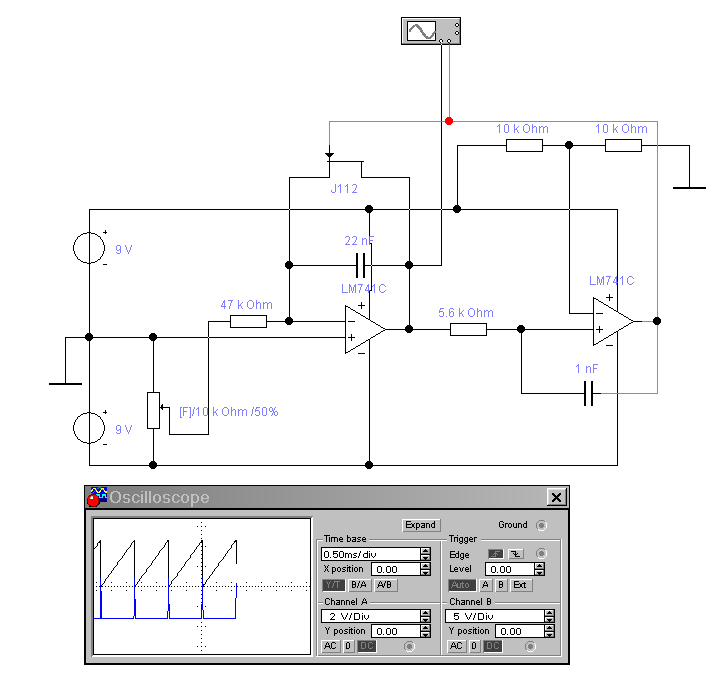

Good idea to test circuits using a simulator but sometimes it can be tricky to get them working as you'd expect.
Firstly, you need to get rid of that function generator you've got connected to the input - this is supposed to be an oscillator after all and feeding a 10kHz square wave into it doesn't help...
I tried your circuit on an old version of Electronics Workbench I've got (see attached picture) and I managed to get your circuit working with a few changes.
The supply voltages I increased to +-9V as +-5V is right on the lower limit of operation for a 741. Also didn't know the cut-off voltage for the default JFET.
The reference voltage at the comparator V5 is made positive not negative as you've got.
I also changed the JFET to an actual J112 or J113 model - I've never had much success with the default one.
The input (for testing) is from a potentiometer across the negative supply then turned into a current via a 47k resistor to the inverting input of V2. 1K is far too small a value here.
Played about with some resistor values as well for reliable simulation.
I haven't built this so can't say whether it's would work or not, that's up to you to find out.
Good luck with your experiments.

I have drawn your design to see if I can make that run in Multisim first, before analysing the errors of my own. What 9V input sources did you use? I cant seem to get past the simulation error with this circuit. Any ideas what might be causing it? Thank you for your response, very useful !!!!! I'll post all the progress that I make on here if it's of use to anyone Smile
