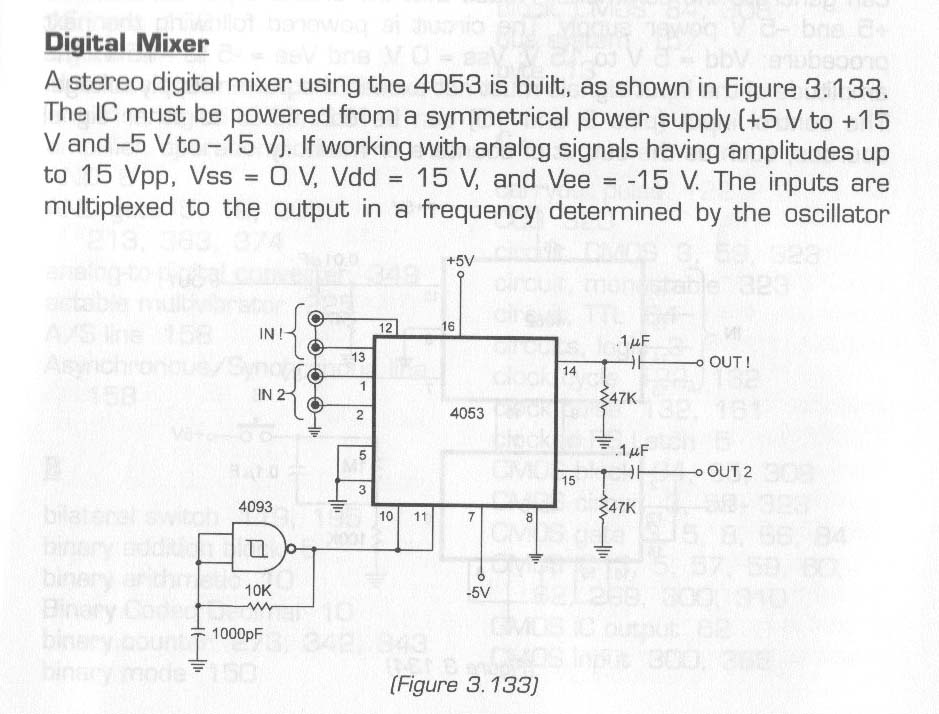

how about this -
 Filesize:  79.44 KB
 Viewed:  531 Time(s)

A mux-mixer and an adder, got it! Lots of ideas coming to me now Very Happy

hey andrew-what book was that taken from? it looks like a cool book
andrewF
Joined: Dec 29, 2006
Posts: 1176
Location: australia
PostPosted: Tue Feb 12, 2008 4:26 pm    Post subject: Reply with quote  Mark this post and the followings unread
i think - cmos sourcebook
but i am not 100%.
