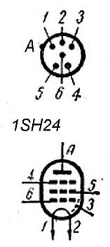

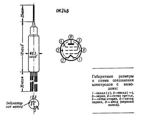

thank you again, can you confirm this tube pinout :
1 - heater
2 - heater
3 - suppression grid
4 - screen grid
5 - control grid
6 - cathode
7 - anode
can't go further by myself without being sure of it Wink
Also, the grid bias has a significant effect on how it sounds and functions.
did the 220n DC blocking caps (i assume) play a part in the the biasing too ?
i haven't been able to find reliable biasing infos on this tube.
do you have any ?
1 - heater
2 - heater
4 - screen grid
5 - control grid
6 - cathode
7 - anode
That is not correct. This tube uses a filamentary cathode, so pins 1 and 2 are the heater and the cathode. Pin 3 is a shield. Pin 4 is the suppression grid. Pin 6 is the signal grid.
http://dl3jin.de/mig40-data/1sh24b.pdf
 Filesize:  9.61 KB
 Viewed:  7171 Time(s)
 Filesize:  22.05 KB

hi !
thanks for the Schematic on page 1 !!
to sum up >
pin 1 & 2 : heater & cathode
pin 3 : shield
pin 4 : suppression grid
pin 5 : control grid
pin 6 : signal grid
pin 7 : anode
THANKS Wink - things are a lot clearer to me !
