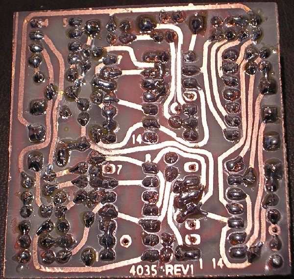

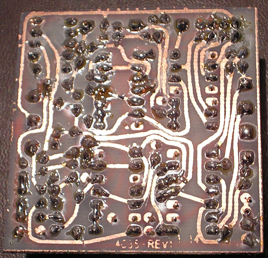

3nity
Joined: Oct 10, 2008 Posts: 13 Location: west
Posted: Tue Oct 28, 2008 8:51 am Post subject:
| AndyR1960 wrote: | Any chance of hi-res pics of both sides of your PCB?
I've built several 4035 modules with no problems - I'd like to see if I can help. |
Hi Andy,
Thanks for your support.
Please find the pics enclosed.
I started with 4035, then I changed back to 4034, but no luck at all.
Probably I should build a test gig, and test the filter alone.
As you can see, I have used the equivalent TB331 that I had around, 2 BF245A as fets, and a simple 2-watt resistor instead of the tempco.
Any hints?

Broadwave
Joined: Feb 16, 2007 Posts: 347 Location: Manchester UK
Audio files: 6
3nity
Posted: Wed Oct 29, 2008 2:25 am Post subject:
Hi Andy,
Thanks for support.
Did the mod, but unfortunately still no luck with this card. It doesn't seem to work properly.
I have a bad low freq. floor at the output, with nothing connected on the card (no input, no pots, no trim). I see about 2-3 Vpp on the scope!
Signal is present at the two fets gates: for a 0.5Vrms on the input, I get 30/40mVpp on them....
I tried a test rig, connecting the CVR trim between 18, 14 and 3, a 100K pot with a 22K resistor in series with it's wiper in pins 10, 2 and gnd,
another 100k pot for the cutoff, top on -15V, wiper in series with 150K to pin 4, bottom to gnd.
It doesn't change.
Probably I should redo the whole work again.
Comments are welcome.

2nd ATTEMPT
1) I remade the foil, since I realized that in the old one the emulsion was up, so I could get a more precise development.
2) I re-etched a new pcb, double-checking for shorted traces, and correct all the errors.
3) I mounted the whole board again. Now I have DIL sockets for the IC's, found the original CA3086 from RCA, and 2 BF245B.
4) Double-checked again for errors.
5) Reconnected the test rig, with the trimmer and the two pots.
6) Fired up!
RESULTS :
It immediately seems to be working.
Frequency and resonance controls respond correctly.
The mains hum is still there, but it depends on the fact that the board is not encapsulated in a screening can, so it picks up electro-magnetic fields from around, especially when near a transformer.
Now I'm tired.

[part numbers are taken from the ARP 4035 schematic, in your PCB Z2 is up left, Z3 up right, Z4 down right]
maybe I am missing something, or referring to the wrong schematic, or ...?
would you please check that the PCB you published is correct ? or else help me find my mistake ?
thank you
another detail: the 220nF input capacitor should actually be two 220nF capacitors in parallel, according to ARP service manuals
thank you for all you are sharing, I am learning a lot here |

| Jaba wrote: | Hello AndyR1960 and all of you,
thank you
another detail: the 220nF input capacitor should actually be two 220nF capacitors in parallel, according to ARP service manuals |
I don't know what schematics you are comparing with (maybe J. Verghese?), in that case, he has drawn the schematics slightly differently from the genuine ARP copies I have - those transistors are not used in the circuit, so ARP just tied the EBC pins together. Don't worry the board works fine - I've built several of them.
The two 220nf caps are used in the later MKIII Odyssey with the 4075 VCF.
It's fine just to use one 220nf for the audio input into the 4023/35
Andy. _________________ Kronos 2-88, Kronos 61, Studiologic Sledge V2/SL, Broadwave ARP 2600EX, Broadwave 18U ARP based Eurorack Modular, Broadwave Minimoog Clone, GEM S2 Turbo.
Synth DIY Projects
Musical Doodlings |

yes, the schematics I have are from J.Verghese (btw where did you get those "genuine ARP copies" ?)
on another schematic (from Verghese again), some notes about early versions of 4035 actually correspond to your version;
so I am not surprised that your PCBs work fine, but there may be subtle differences
has anyone tried the 40235 board ? it seems it follows the schematics I have
I heard that the 3046 transistor array chip has better Vbe matching than the 3086, is it worth trying ?
once again, thank you for sharing your work with us |
