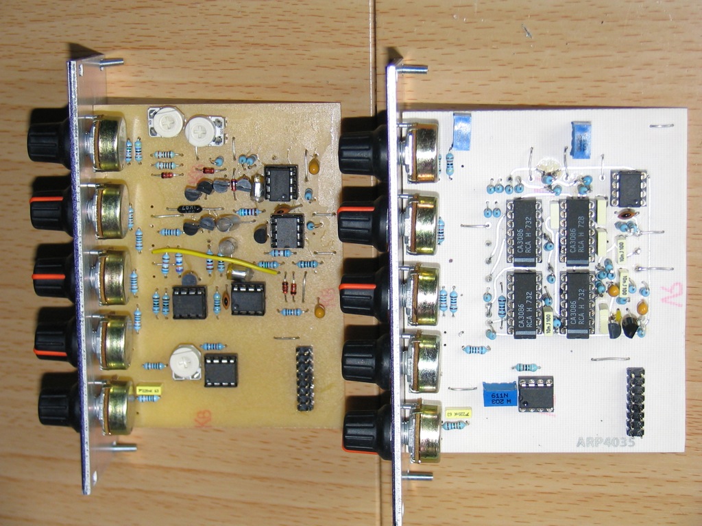

Just a teaser Smile
The 4023 12db is on the right, the 4035 24db "Moog" is on the left.
I'll try and get the layouts up today for both filters. Again, like the Oddy VCO's I'm surprised that these two have been ignored for so long.
Yusynth has the 4072 LM3900 based filter on his site... go on collect the whole set - you know you want to Twisted Evil
Andy.

Hi all,
Ok, here's the PCB and component layout for the 4023 VCF, one or two things though...
The original TZ81/581 expo pair have been replaced with 2N3904/06 (perfectly acceptable subs), and the original 2N5172's are now 2N3904's (again, perfectly acceptable sub).
You will need to watch out when you insert the trannies, as I haven't changed the PCB foil from the original, so you'll have to twist the transistors a bit, as the originals had different pin-outs.
There are two fly leads (marked as blue on the pdf, ugly solution I know) and a wire link which is obscured somewhat by one of the 61.9k resistors - please don't forget these.
The only other change I made was for the CV summer, the original was an LM301 with compensation cap, I had none left so that's been replaced with a TL071 (you can also replace the other two 301's with the TL071, but remember to remove the 33pf caps... In fact, the VCF will probably sound better using TL0's).
I seriously like this filter, I know everyone goes on about 24db Moog VCF's and how fabulously powerful they are, but this cuts through anything, it's a real sizzler - but be carefull when you crank up the resonance, as there's no gain compensation... I don't want you to blow your speakers Smile
I'll get a BOM and samples up for everything when I've slept... been awake now for 36 hours... need... sleep... peaceful... sleep... ZZZZzzzz...
Andy

I got my board etched from a local pcb-service and now there is one question on the 3 trimmers on this pcb.
PDF is here... http://electro-music.com/forum/phpbb-files/arp_4023_163.pdf
What does the "CV-reject"trimmer do? And how to adjust it?

LektroiD wrote:
...but I don't see what the tempco is doing here, it's not thermally coupled to the transistors or anything, so surely it can be substituted with a fixed metal film (or similar)?
Exactly what I think. I´ll try building this filter without tempco...and maybe add one later if really required.
Btw,any idea on the "cv-reject" trimmer and how to adjust it?

Hi Andy.
The Tempco resistor is for keyboard tracking?
If I'm not interested in keyboard tracking can use regular 1% resistor?
If I use the tl071 instead lm301 you said to remove the 33pF caps, do I need to put jumpers instead?

isak wrote:
Hi Andy.
The Tempco is mainly for frequency "stability" which is vital in a VCO, but not so much in a VCF, so it's ok to use a regular resistor.
Just remove the 33pf cap, no jumper required Smile

alcide wrote:
I have, however, a question: at high frequencies (cutoff) when resonance is high, if I apply a lot of CV's, the filter produces short and uncontrollable screams
The 4023 will overload (not in a nice way) if the CV is to high - The ARP Odyssey is designed to keep the CV mixer levels within a certain range to avoid this happening. I think you probably just need to attenuate your CV's a little... or a lot Smile

PostPosted: Mon Apr 22, 2013 8:49 am    Post subject: Reply with quote  Mark this post and the followings unread
Problem fixed ! I replaced the lm301's with TL071, and everything's fine now (maybe I should have selected, as required, the 301 ? But I don't know how to do it, and I don't care anymore, in fact: it sounds a LOT better, now, i must say (by modern standards, at least...)
Thanks !

PostPosted: Wed Apr 24, 2013 8:03 am    Post subject: Reply with quote  Mark this post and the followings unread
The 301 is an uncompensated opamp which required the right capacitor to prevent oscillation. That may had been the "squealing" you heard. 301s were also prone to latchups.
The TL071 that you substituted has internal compensation and that may have fixed the problem.
Could had been a bad cap or bad 301 opamp. ARP did have a selection process for the 301 opamps. The 301 offered that design flexibility of tailoring the compensation circuit towards the application circuit, but it was not without its thorns and in the long run the industry favored the internally compensated opamp.

Thanks a lot for your help Andy.
4023 is working perfectly. A bad cap replaced and it came to life.
thanks for sharing Wink
Now I will try the 4035 one but I've got not much experience with double faced PCBs...gonna make a try anyway.
