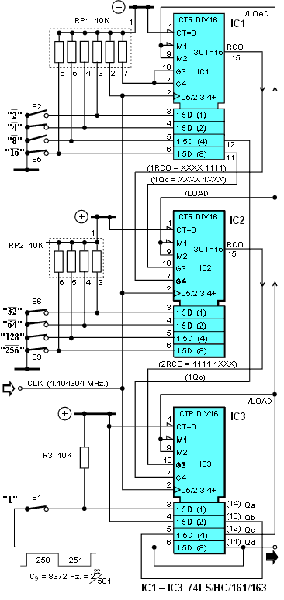

If you inter-connect three '163-type counters in the quirky configuration shown here, then you have a switch-programmable divider with an output that is always either a square-wave (even divisors), else a pseudo-square-wave (switch S1 closed for odd divisors).
Achieving this result is harder than it sounds, and exploits the exclusive dual enables of the 74HC163 plus its almost-unique synchronous load together with a highly unorthodox connection scheme, used to overcome problems often encountered with stand-alone programmable dividers, viz.:
Pulse or spike output.
Switch setting n may equate to divisor (n+1) etc.
Extra “glue-logic” required.
Operational frequency must be doubled in order to derive square output.
The operation of the circuit is not easy to understand (and even its designer got confused more than once!) and although it was rejected by Elektor as being “too simple for our readers”, there is not much point trying to understand how it works unless you need to keep your brain active. The simplest way of explaining it is that IC1 & IC2 count half-periods (first the Space, then the Mark) so that switches S2 – S9 assume double their usual binary value (“weightings”). IC3 functions as timing control and output toggle stage. With S1 closed (on), an extra clock period delay is injected into the output “space” (i.e. IC3/Qd = LOW) period.
With all 9 switches closed (divide-by-511), the output mark-space ratio is 255:256.
A limitation to “what-you-see-on-the-switches-is-what-you-get”, is that the minimum divisor is 6, even if the switches are all set open/off (value = zero).

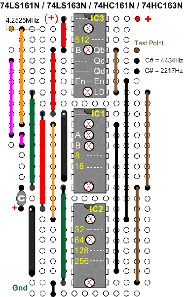

To prove the design as quickly as possible, the prototype used 4-way switch-banks suited to the data inputs of the ’163N. The switches are sandwiched between a 10K pull-up SIL pack and a 220R pull-down (inverted, pin 1 to ground). These can be found on the surplus market (in various lengths) remarkably cheap and make a quick, neat job of wiring the switches to pseudo-ground.
The strip-board track is left uncut at all pin 16s and at IC1 pin 7, and at IC3 pin 6 (including underneath pin 8 of the unused switch). (You may also wish to limit track-cutting under IC3 so as to allow a link from pin 13 to pin 5).
This layout is unsatisfactory in that three out of four switches in one switch-bank are un-used. It would be more aesthetic to use a 10-way switch-bank, perhaps aligning switches 2 - 5 against IC1 pins 3 - 6.

When you build this circuit on a piece of virginal copper-strip board, the output mark:space is 256:257 (i.e. divide-by-513).
Lesser divisors (in quantum multiples of 4) are obtained by using a track-cutter (or drill bit) between the input/output pins of IC1 and IC2.
The pull-up resistors then come into play.
By cutting the track between IC1 pins 4 and 13, the output is reduced by 4 (to divide-by-509, the mark:space being reduced equally to 254:255).
To reduce the counter from divide-by-513 to divide-by-301, it is necessary to cut alongside those pins marked:
301 = 513 -128 -64 -16 -4 [derivation of top Ab from 4.0 MHz by cutting four of seven tracks]
Once the copper tracks are broken, "repair" is made by linking inputs to ground, as required to increase the output from the minimum count.

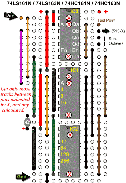

The following example demonstrates two small modifications required to deal with divide-by-959.
As before, the counters cascade in conventional synchronous manner: the carry output from IC1 (pin 15) feeds the two enables (pins 7 & 10) of IC2.
When IC1 & IC2 are "full-up" (=255), IC3 is enabled (via IC2, pin 15).
On the next rising edge of the common clock, IC3 increments whilst IC1 & IC2 "roll-over" to zero.
As long as our test point ("registered overflow" ) remains high, all is conventional and, according to the Texas data (1988), this simple cascade should be good for 14MHz.

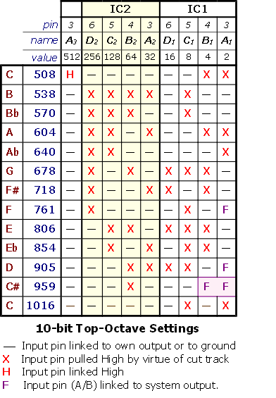

To implement dividers from TOGware set 508, 538 ... 959, the previous layout is reconfigured as a 9 + 2 overflow counter, giving effective 10-bit division at system output IC3 Qc. Comparing with the previous layout, notice that the allocation of IC3 inputs/outputs has "slipped down a notch", leaving input A as the new most significant input.
The additional bit can boost maximum division to 1025 (513 + 512 ).
Just one sub-octave is now available — this can be similarly dispensed with should you need 11-bit division.
The simplicity of the previous feedback may have blinded you from noticing that 50% of odd divisors are not implementable with that circuit.
Consider trying to implement divide-by-239 by the method given: 239 = 513 - 256 - 16 - 2
As with divide-by-959 (= 1025 - 64 - 2), half of all odd numbers incorporate a binary bit value ("weighting") of 2, which previously did not warrant a mention.
If an inverter is available, or you can spare a couple of counter bits as here, then you can set any mark-space ratio that takes your fancy. If, however, you need all your counter bits and do not want to tack-on an inverter, taking the feedback to both inputs A and B reduces any count by 2, because (at the end of every mark period) input B is is being pre-set 2 counts nearer to the counter's maximum. The minimum divisor is now (2:5) and the maximum count is 1023 (= 510:513).
Now, we can achieve 959 as 959 = 1023 - 64 (i.e simply cutting the track between IC2 pins 4–13). The mark-space ratio of 478:481 will not be obvious.
Similarly, we can now achieve 239 as 239 = 511 - 256 - 16. (Mark-space ratio 118:121).
