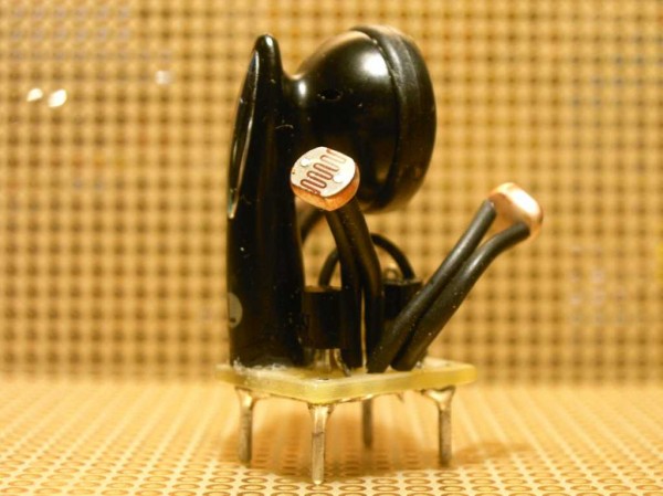

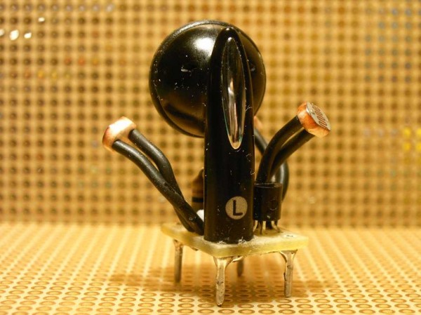

Perfertorator Subject description: Bubzy's perferted challenge
played a bit more with a 2 transistor AMV,
replaced resistors with LDR's, changed the circuit a bit and to my surprise I got it oscillating with 1 capacitor.
didn't realize how small 30 holes actually was untill I cut the perf
the design was a bit trickier then I expected too,
but I managed to get it on there.
the 4 pins it stands on do have a function, 2 are for power, the other 2 are connected together and can be used
as a line out.
nice perferted challenge bubzy!

Well done! Looks good... like a little bunch of electronic mushrooms. Some sound recording would be nice .
It does pretty much come down to transistors. There isn't room for an IC... unless you want to go opening the cases. Of course there is the option of making your own custom components if that is not cheating.
EDIT: also, there is a distinct advantage with perf. You don't need to sacrifice holes to make a break in the track.
