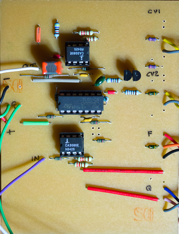

I built it, initially wiring up the power backwards, but since replaced the 2x CA3080's and the TL074, and it doesn't work... It seems to make a bandpass effect when I wire the in to the out and vice versa, but in the normal configuration I get nothing except a small amount of random noise...
What else might have popped? _________________ LektroiD |

Try to check all the jumpers.
I did a mistake with 2 jumpers when soldering them.
Oriontetion of the IC's.
transistors i used is BC557, dont know what you used but check the pinout. _________________ http://www.myspace.com/mgmtrance |

Can you upload the full pcb size pic?
If I recall the 470nF at the output needs to be poly.
did checked the led oriontetion? _________________ http://www.myspace.com/mgmtrance |

Posted: Fri Jan 11, 2013 11:30 am Post subject:
LEDs need to be green, it's important.
Don't plugin nothing to the input, first let's check if it's working right.
the LEDs need to be off (not lighted) when the reso is all the way down CCW.
Is it like that?
If yes turn the F to 12 o'clock and slowly trund the reso CW the LEDs need to light after half way (12 o'clock) and fully lighted when turning the reso all the way.
In this way it suppose to self osc.
Please try that and report back. _________________ http://www.myspace.com/mgmtrance |

Green LEDs are in, but I can't do any more tests for two weeks, as I'm away. They only lit when a source was plugged into the output. I'm wondering if I popped the transistors too when I fed it with inverted power... _________________ LektroiD |
