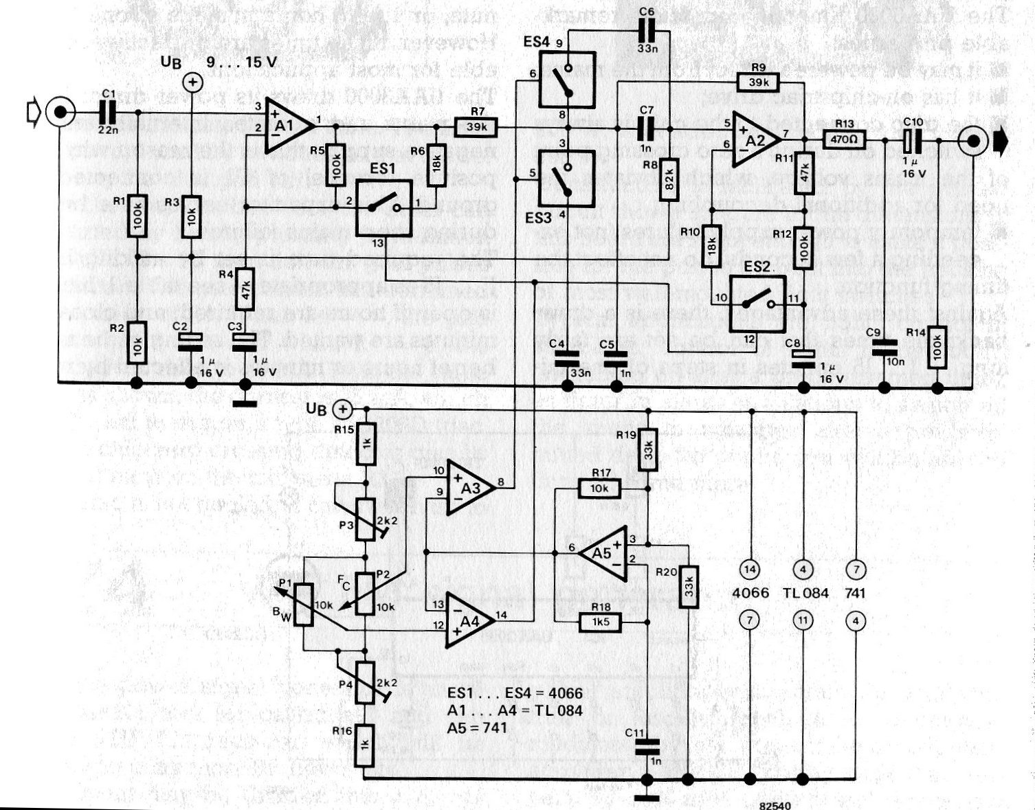

PostPosted: Thu May 23, 2013 4:48 am    Post subject: Reply with quote  Mark this post and the followings unread
I've attached an old Elektor circuit diagram for a switched capacitor VCF. I haven't tried it out yet, so I'd be interested if anyone builds it. I also believe that Ken Stone's Bi-N-Tic Filter (CGS57) has switched capacitors in it.
Gary
Clarification:
Just in case anyone tries this out, I feel that I should clarify this design a bit. Although the article was headed "Universal VCF", it is actually controlled by the duty cycle of the IF signal derived from the A5 circuit (a fixed frequency oscillator) and the A3/A4 circuit (2 comparators). A5 MUST be a 741, as you need a triangular output here. The 741 is too slow to produce a rectangular output at this frequency and so produces a triangular(ish) signal. To make this truly a VCF, would require 2 voltage controlled PWM inputs to ES3 and ES4, probably making the circuit more complex. Still, it does illustrate the idea of switching capacitors to vary the cut-off frequency of a filter.

PostPosted: Sat Jul 20, 2013 1:10 pm    Post subject: Reply with quote  Mark this post and the followings unread
To show how ignorant I am and how important it is to post schematics or pictures of what we are referring to before asking (like gdavis adviced):
When I remarked the CV worked on my circuit (a simple oscillator, see picture at the bottom) even without JFET or Vactrol, I thought (I am sincere. I know it sounds stupid, but I am learning out of these mistakes) that it worked because the pot in the circuit (driven by power) was generating voltage (I mean I understood it this way and here again we see that posting more concrete questions with examples might save time and confusion. Mea culpa !), so today I disconnected the pot and thought I will then try with Vactrol to see what happen§. But the incoming CV was working !
The resistor R between incoming voltage and opAmp input, which I added while trying with Vactrols in previous tests and did not have at the beginning in the circuit (this is the reason why I asked here how to add CV because all my tests were not successful), is essential and allows CV in my case.
Now I wil try with this concrete simple example to understand a couple of important points:
Measurements in red color.
When I measure at 1, I see the voltage from the incoming CV input. Okay.
When I measure at 2, there is no voltage shown on my tool.
And now I think I am missing here something essential in DIY. In this thread voltage and current were mentionned quite often. Is it exactly here the case we talk about since the beginning ? Having to transform voltage into current or current into voltage depending on the circuit ?
At 2, if not a voltage is it then a current (you see how ignorant I am I did not know we could have current without voltage !!!!!! People here will fall down from their chairs, I know and I am reasy sorry !).
I measure a current in amperes here not changing, but what kind of signal else should I then be able to read here ?
Thank you very much for your explanations !
gdavis
Joined: Feb 27, 2013
Posts: 359
Location: San Diego
PostPosted: Sat Jul 20, 2013 10:49 pm    Post subject: Reply with quote  Mark this post and the followings unread
What you are measuring is correct. With the + input of the opamp grounded and negative feedback (in this case through the capacitor between the opamp output and - input), the - input is a "virtual ground". It's not actually connected to ground, but the circuit behaves in a way to maintain that point at the same potential as ground.
Do a google search on basic opamp circuits, there are a lot of good explanations out there, better than I could do here. Wikipedia isn't bad: http://en.wikipedia.org/wiki/Operational_amplifier
