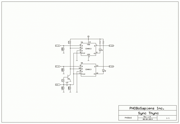

PostPosted: Mon Apr 07, 2014 6:30 pm    Post subject: The Sync Thync (now with Stripboard layouts)

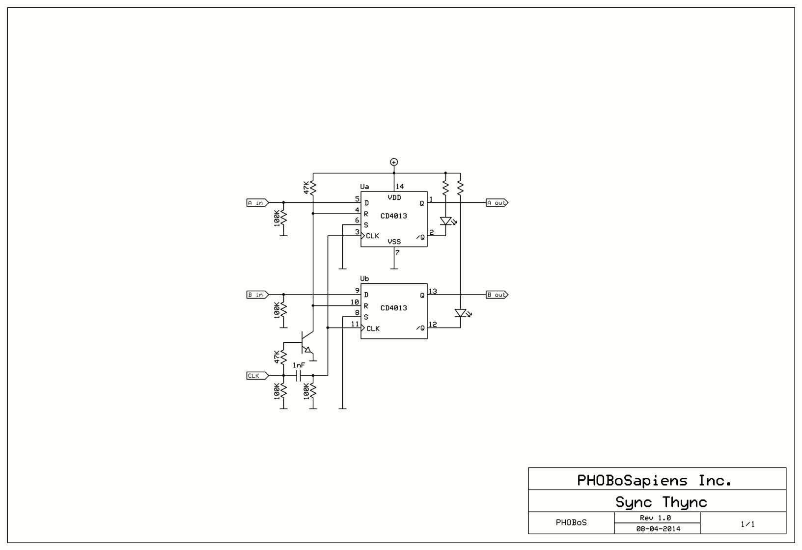

Subject description: S&H + AND, useful for rhythmic patterns
Something simple that actually came from a bigger circuit I was testing. It's a bit of a cross between an AND gate an a S&H made with 2 flip flops
(but you could easily add more). When the CLK input goes high it samples whatever data is at the A/B inputs and this appears at the A/B outputs as
long as the CLK stays high. When the CLK is low the outputs are low. It's nice for creating rhythmic, somewhat random, patterns by connecting some
oscillators to the A/B inputs and an LFO to the CLK.
The Sync Thync, you know you want (at least) one! Wink

PostPosted: Tue Apr 08, 2014 8:36 am    Post subject: Reply with quote  Mark this post and the followings unread
when the CLK input is High is the R Pin on the 4013 High or low? (i plan a one channel version of this, so i can use a 4049 or 4050 i think for the Reset)
i think this is a cool thing with one of my lunetta modules. I build a "pattern" generator from a 4017 and a AND with some 4050 Buffers with 4 outputs:
A 1-1-0-0
B 0-0-1-1
C 1-0-1-0
D 0-1-0-1
think this is a cool Source to Trigger/clock this.
Posts: 5884
PostPosted: Tue Apr 08, 2014 11:37 am    Post subject: Reply with quote  Mark this post and the followings unread
R(eset) is low when CLK is high and the other way around. It'll probably work with a 4049 but you'll have to test it. When I first experimented with
it I had the clock directly connected (without the capacitor and resistors to create a pulse) but that didn't work, so keep that part in.
A 1-1-0-0
B 0-0-1-1
C 1-0-1-0
D 0-1-0-1
I did a test using 2 LFO's on the A/B inputs and it's possible to get repeating patterns but there is usually some drifting which will cause it to change.
It will always be in sync though Wink

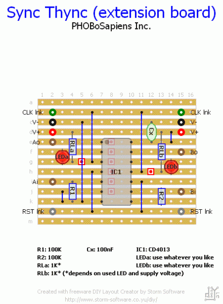

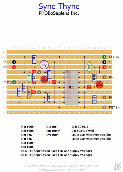

PostPosted: Tue Apr 08, 2014 3:39 pm    Post subject: The Sync Thync Stripboard layouts Reply with quote  Mark this post and the followings unread
I know some of you like stripboard so here are 2 layouts. One with the main circuit, the other is an extension board for 2 more in/outs.
It can be added to the same PCB that's used for the main board if you cut some tracks in between (V+, V-, CLK lnk and RST lnk line up).
And you should be able to add more than one extension board if you like, although I haven't tested this. Cool
note: don't cut the track between pins 7,8 of IC1

Posts: 5884
PostPosted: Tue Apr 08, 2014 4:27 pm    Post subject: Reply with quote  Mark this post and the followings unread
So this is what it would look like if you put both on one piece of stripboard.

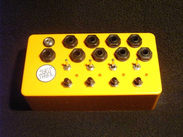

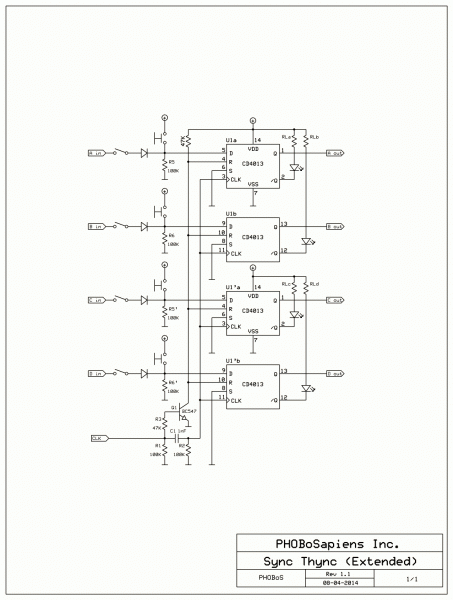

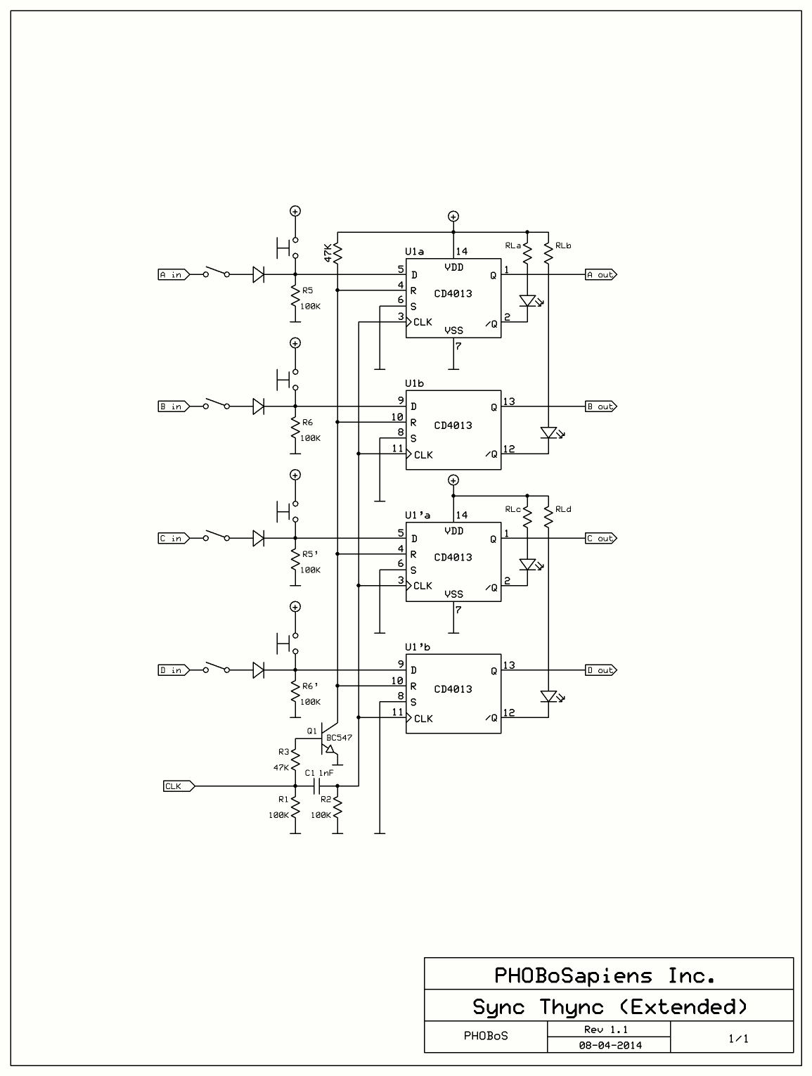

PostPosted: Sun Apr 13, 2014 12:56 pm    Post subject: Sync Thync build pics Reply with quote  Mark this post and the followings unread
I put it in a plastic enclosure and added some switches. The toggle switches turn the input signal on/off and when it's off the output stay low. By adding
them to the inputs, switching will always be in sync with the clock. The pushbuttons force a high signal on the data inputs, so when pressed the
output will be the same as the CLK input (useful for drumrolls/bursts).

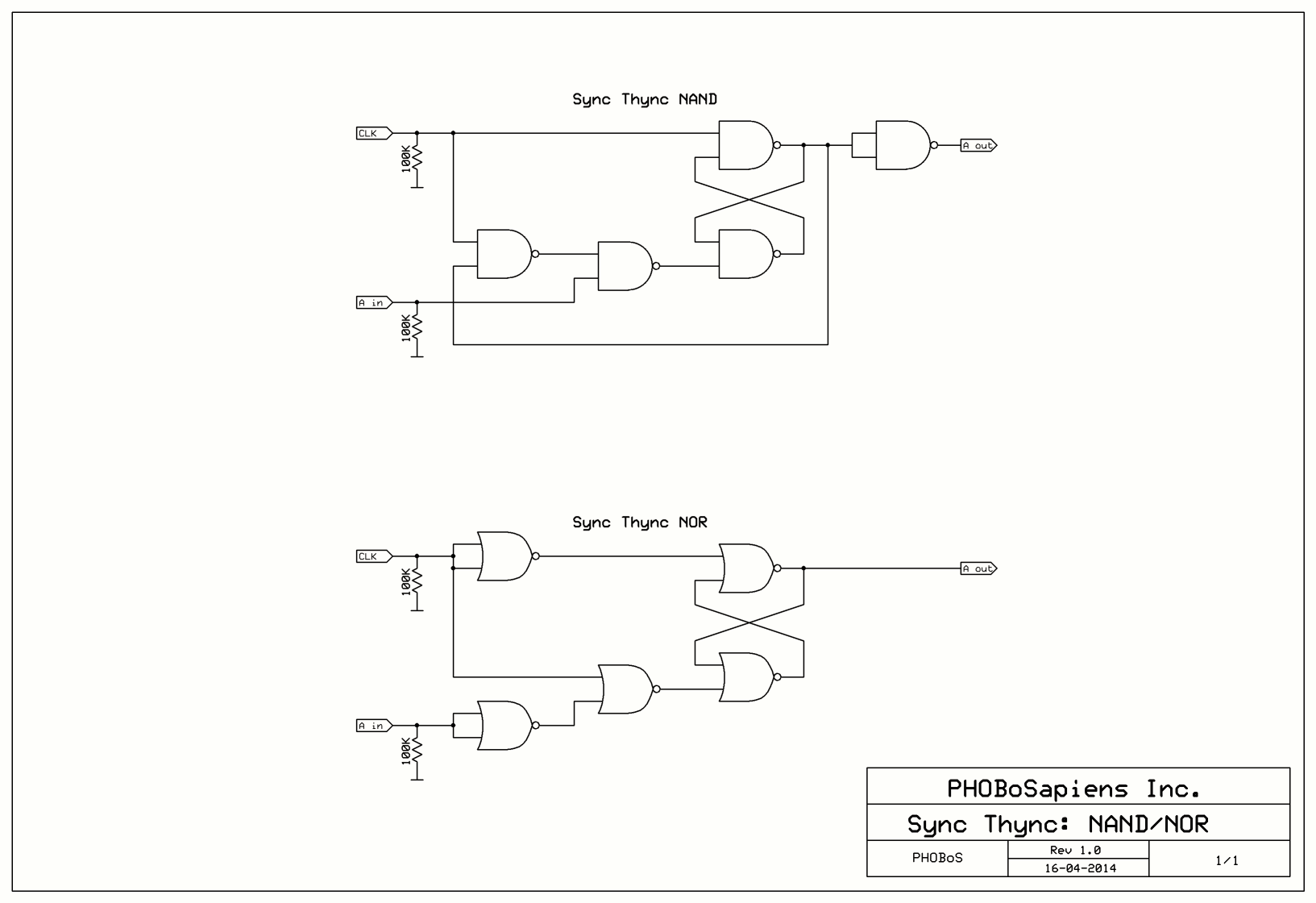

PostPosted: Wed Apr 16, 2014 4:24 pm    Post subject: Sync Thync NAND/NOR version Reply with quote  Mark this post and the followings unread
Here are the schematics for those NAND and NOR versions that seem to work.
At least in simulation, I haven't breadboarded it.

Posts: 24537
Audio files: 299
PostPosted: Wed Apr 16, 2014 4:41 pm    Post subject: Reply with quote  Mark this post and the followings unread
Hmm .. that's strange ... I would have expected more symmetry between the nor and nand versions ... yet the nand one has an extra feedback loop .. prolly means that there are some more possible alternatives so maybe even a better optimized one Cool
Posts: 5884
PostPosted: Wed Apr 16, 2014 4:46 pm    Post subject: Reply with quote  Mark this post and the followings unread
yep that's what I was thinking, it kinda surprised me that I didn't need the feedback loop for the NOR. But as long as I haven't really tested it I 'm not
sure if either version will work.
Posts: 24537
Audio files: 299
PostPosted: Wed Apr 16, 2014 5:02 pm    Post subject: Reply with quote  Mark this post and the followings unread
The thing is that
NOT ( A AND B) = ( NOT A) OR ( NOT B)
De Morgan's laws .. unfortunately the Wiki entry has a bit of a formal notation for it ... but De Morgan is the the thing, its a handy thing for optimizing stuff.
Another thing to look into is Quine McClusky
Anyway .. that NOT ( A AND B) = ( NOT A) OR ( NOT B) thing hints at symmetries to be expected .. basically it states that a positive logic circuit with ANDs is equivalent to a negative logic circuit with all the ANDs replaced with ORs ( so you need inverters on all in and outs to make it the same).

Posts: 5884
PostPosted: Thu Apr 17, 2014 1:43 pm    Post subject: Reply with quote  Mark this post and the followings unread
thanks for the links jan. Very Happy I'm familiar with some of it but not all.
so using NOT ( A AND B) = ( NOT A) OR ( NOT B) I changed the circuit with the feedback loop to a configuration using NOR's. Seems to work in
simulation but you need an extra gate. However it has 2 inverters on the inputs so you could use transistors and you would only need to do that
once for the CLK, but still not very ideal. Maybe it can be done with less gates adding a different gate (like XOR or mixing NAND & NOR gates).
I also converted the other circuit to NAND gates but that doesn't seem to work. Maybe that tells me that the NOR version doesn't actually work
either, but I guess I won't know unless I breadboard it sometime.

Posts: 24537
Audio files: 299
PostPosted: Thu Apr 17, 2014 3:21 pm    Post subject: Reply with quote  Mark this post and the followings unread
For the NAND version ... are the two outputs of the flip flop not inverse to each other? if so the output inverter would not be needed.
And something likewise for the NOR version then.
Posts: 5884
PostPosted: Thu Apr 17, 2014 3:36 pm    Post subject: Reply with quote  Mark this post and the followings unread
if you have a flip flop in one package than that is indeed so as far as I know (Q and /Q are just inverted).
But when using NAND or NOR gates both outputs can be the same (1 for NAND, 0 for NOR) .
