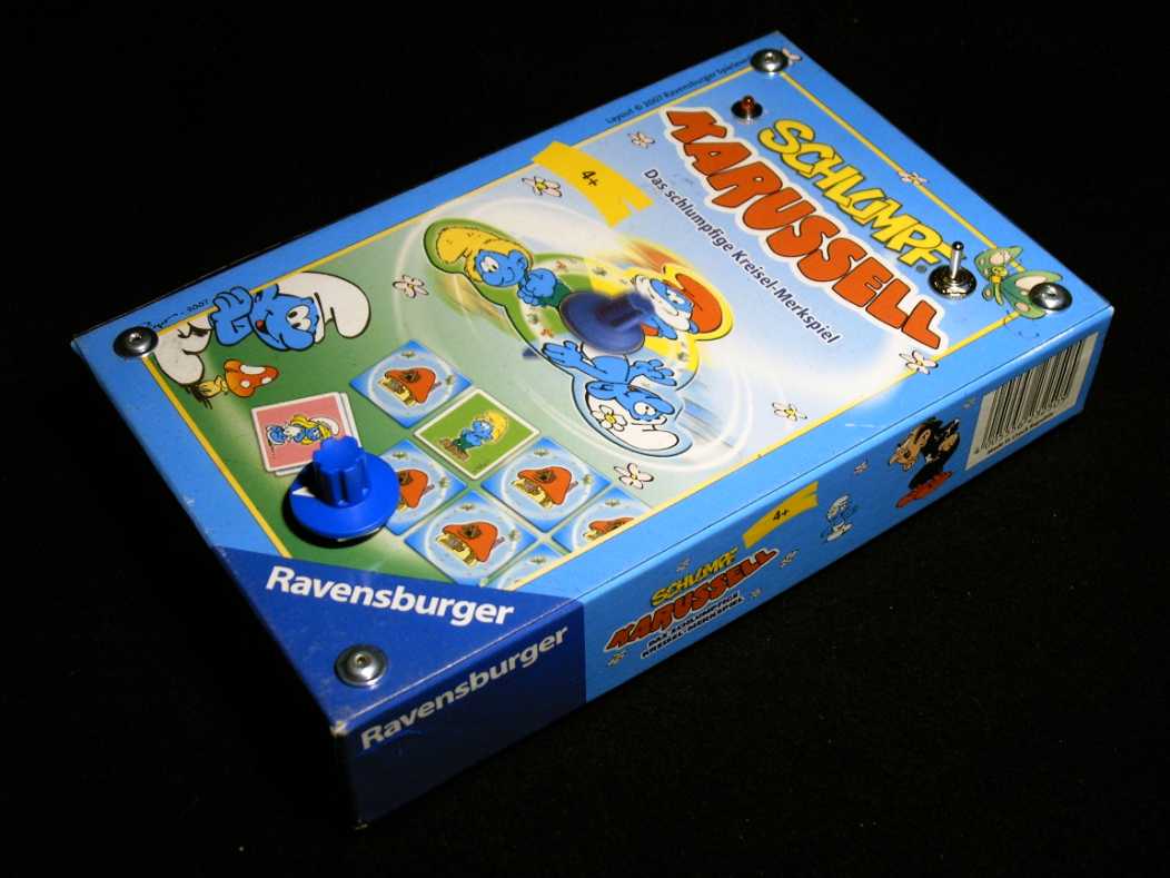

PostPosted: Sat May 31, 2014 2:45 pm    Post subject: magnetic stirrer Reply with quote  Mark this post and the followings unread

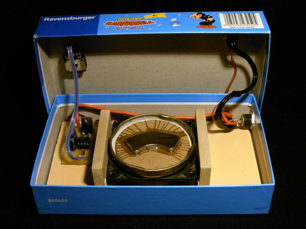

a CPU fan, a HDD magnet and a PWM controller circuit from here (with some different values).
The fan is mounted on a thin piece of wood, slightly smaller then the box, which is attached using some double sided adhesive foamtape to reduce
vibrations. I tried to get everything centered but it was pretty hard to get the magnet right because of it's shape. It's not too bad though, it doesn't
'walk away' and at low speeds it works great. I riveted some clear plastic to the top of the box as protection.

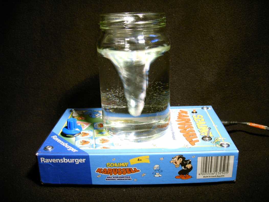

As long as I don't turn up the speed very high it doesn't make much noise.
And the noise is coming from the stirbar, which is a decapitated nail right now, grinding on the glass.
I don't really have a good mic to record it but I was thinking that if I add a reed switch I should be able
to use it as an oscillator Wink
