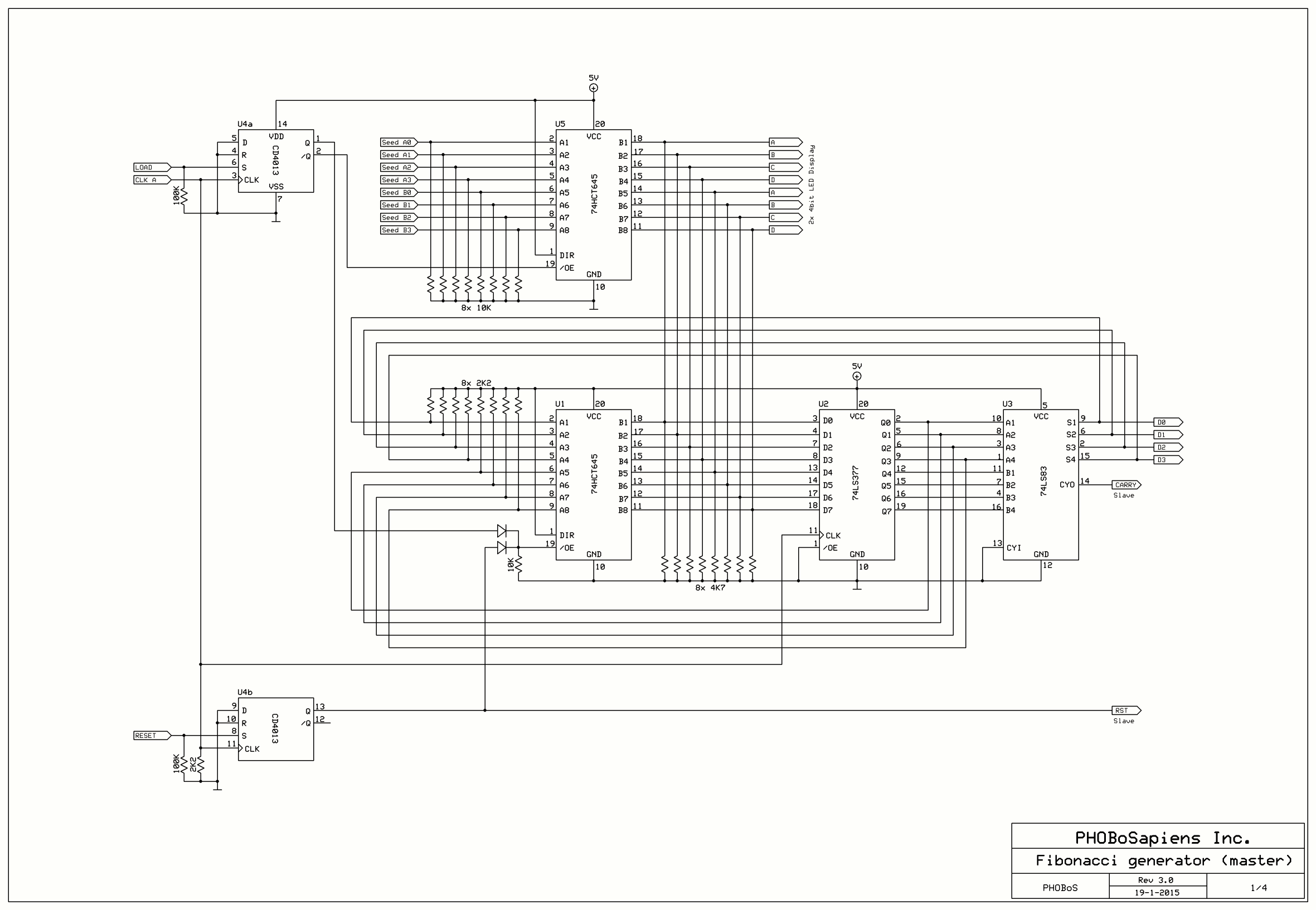

Starting from that basic circuit I designed the following 2 circuits.
The first one is the MASTER sequence generator:
U3 is a 4bit adder and U2 contains 8 D-type flipflops. I used TTL because the only CMOS full adder is the CD4008 which appears to be obsolete
and I have a bunch of 74LS83 chips anyway. I also have a couple of 74LS377 chips so those came in handy too. Although the basic circuit works,
it doesn't have an option to insert the first (Seed) values. This is what U1 is used for. It is actually an Octal Bus Transceiver chip but I'm
using it as an Octal switch. With the DIR pin (1) held high data flows from A to B, at least as long as the Output Enable pin (19) is at
a low level. When it is at a high level the outputs are floating (it has 3-state outputs).
The Output Enable pin is controlled by U4a which also enables the seed switches. So when Q is high the datastream gets interrupted and the data
from the switches is inserted. Using a Flipflop for this isn't necessary but it keeps everything in sync with the CLK. The 2k2 pullup resistors
are added because U1 is not TTL but high speed CMOS. And because U4 is also CMOS and can only drive one TTL input the transistor buffer is needed.
I also added a reset option using U4b, when the reset button is pressed the datastream is interrupted but the seed switches aren't enabled so seed
A and B are both 0. The result is that all the outputs will be low and stay low untill new seed values are added.

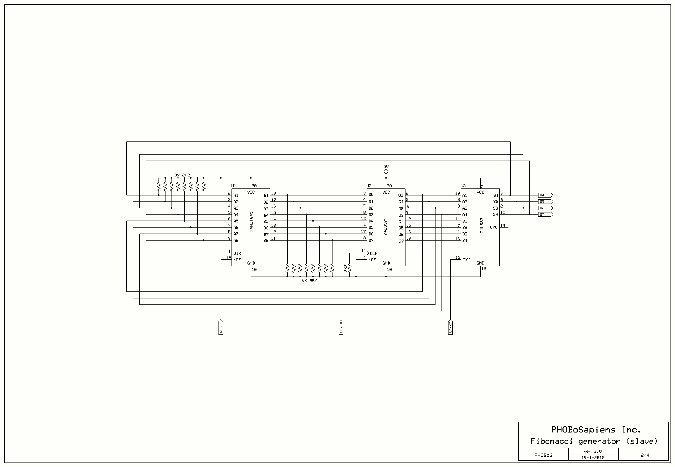

The second circuit is the SLAVE sequence generator:
It's pretty much the same as the MASTER generator except that it doesn't have the seed section. Instead it uses the carry out from the MASTER
circuit and it's used to turn it from a 4 bit generator into a 8 bit generator (and you can add more SLAVE circuits for more bits). You could
add seed switches too but 2x 4 bit is enough for me.
I haven't actually tested the circuit yet (didn't have a free breadboard yet and I don't have any 20 pins sockets to solder it either) but I did
simulate an 8 bit sequence generator. For an 8 bit generator the maximum output value can be 255 and higher values are truncated, so the sequence
pattern won't be correct after that. I was expecting that it would either just zero out or repeat a short sequence, however it keeps going and can
create a sequence with a maximum lenght of 384 steps (depending on the seed values) before it repeats. Very Happy
with seeds 0 and 1 the full sequence is:

PostPosted: Tue Jan 06, 2015 4:02 pm    Post subject: Reply with quote  Mark this post and the followings unread
I made a change to the Master generator using a second Octal Bus Transceiver chip as a switch instead of the transistor.
This makes it easier to have external seed inputs aswell Very Happy
I'm also adding some displays to see the numbers! The schematic for that is posted here.

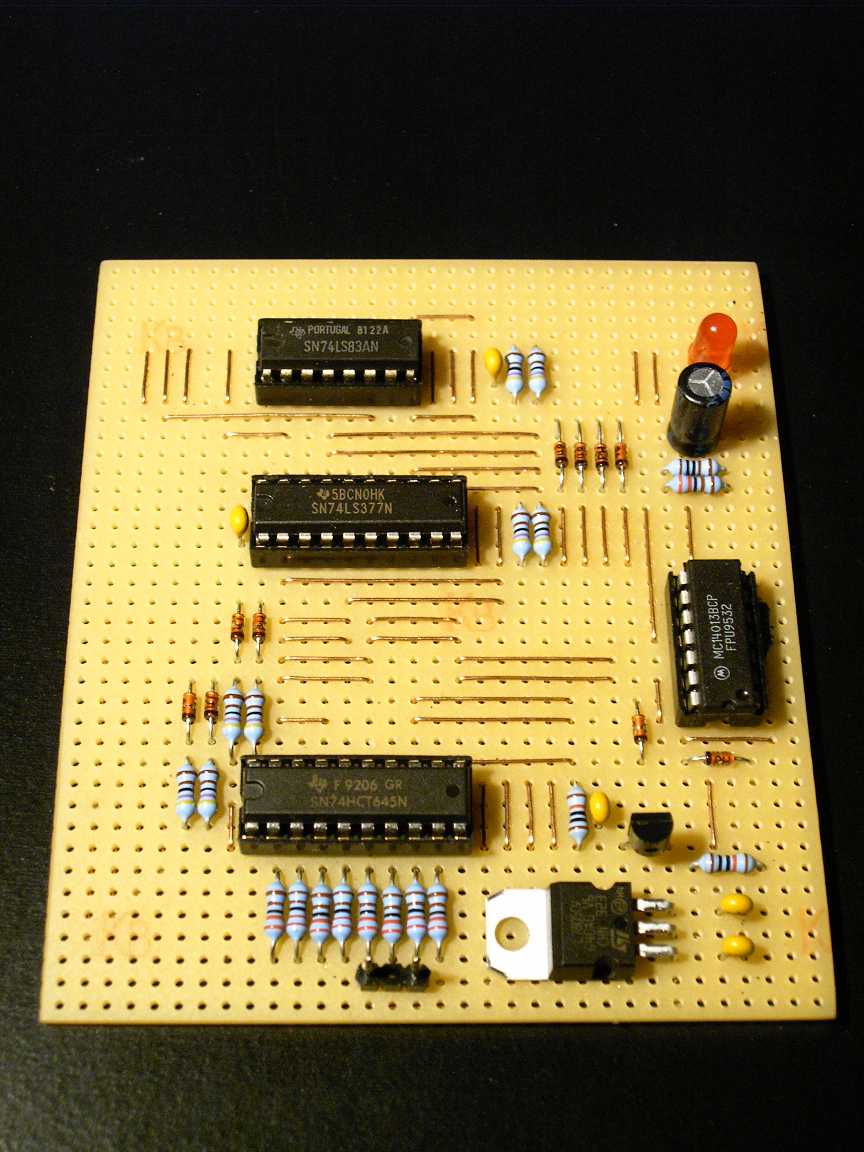

Posts: 429
PostPosted: Wed Jan 07, 2015 5:16 am    Post subject: Reply with quote  Mark this post and the followings unread
Ha, cool. I wonder what it could sound like.

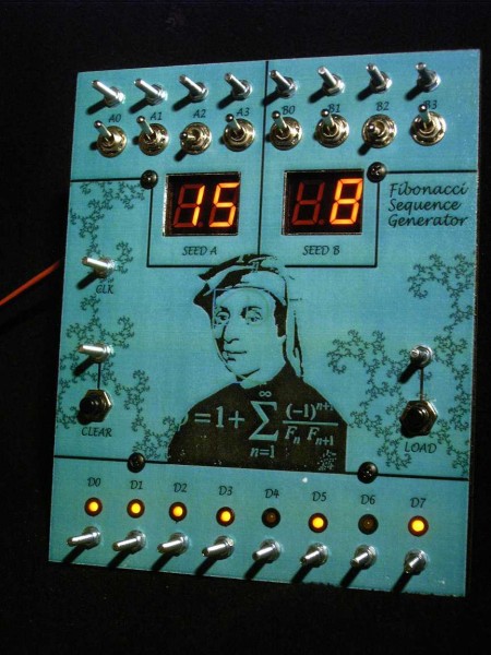

PostPosted: Sun Jan 18, 2015 7:40 pm    Post subject: Reply with quote  Mark this post and the followings unread
it works ! Razz
jackson dancing
I will post a schematic with the buffers and how it's connected later (probably tomorrow). And maybe some sounds too.
now I'm just gonna watch the numbers Shocked

Posts: 5881
PostPosted: Mon Jan 19, 2015 3:02 pm    Post subject: Reply with quote  Mark this post and the followings unread
Here are the 'final' schematics. Master and Slave haven't really changed except that I removed the seed inputs and switches
and added labels to show that they are internally connected. What they are connected to is the in/out buffers. I used CD4050
as input buffers + level shifters and opamps as output buffers + levels shifters. The diodes on the seed inputs aren't
needed with the way I wired up the switches but I only noticed after soldering them. I also added a schematic of
the display drivers here to have it all in one place.
I had it working faster then expected. After powering it up for the first time it didn't really work as it should but it didn't smoke either.
and I had already tested the display board earlier so I knew that was working. After some measuring I found 3 pulldown resistors
that were floating together because I forgot one solder connection.
After fixing that it almost worked except that the second bit seemed to be at a high state all the time. Which turned out to be
a trace which I made a bit too long in the PCB design so it was connected to the +5V supply. Since I copied the design for the
Slave board from the Master it had to fix this on both. But after that it worked as it should Very Happy
I think I will make one change to it; connecting the reset input of the LOAD flip flop to the ouput of the RESET flipflop.
Because they are synced to the CLK the reset doesn't have any effect after the load button is pressed untill there has been a CLK pulse.
something interesting I noticed is that although it takes some time before the 8 bit pattern repeats the individual bits
have a shorter repeating pattern. With 0 & 1 as seeds the first bit (D0) repeats after 3 steps, the 2nd bit after 6 steps,
the 3rd bit after 12 steps, the 4th bit after 24 steps, the 5th after 48 steps,. and .. I didn't look further than that but I
assume it keeps doubling.

Posts: 429
PostPosted: Tue Jan 20, 2015 2:13 pm    Post subject: Reply with quote  Mark this post and the followings unread
Wow... impressive build. Image 04 (i.e. lying face down) made me think of a layer cake. A circuit layer cake.
.: James :.

PostPosted: Sun Jan 25, 2015 7:45 am    Post subject: Reply with quote  Mark this post and the followings unread
Great build, great graphics,metal stanchions....what you trying to do....5 days no samples...I can hardly breatheeeeeeee Smile
Posts: 5881
PostPosted: Mon Jan 26, 2015 12:21 pm    Post subject: Reply with quote  Mark this post and the followings unread
layer cake, mmm. maybe I should do a slice of pi next Wink

Fantastic, Phobos , love the panel , nice colour & layout Smile.
Dave.
Posts: 5881
PostPosted: Wed Jan 28, 2015 3:25 am    Post subject: Reply with quote  Mark this post and the followings unread
thanks dave Very Happy
