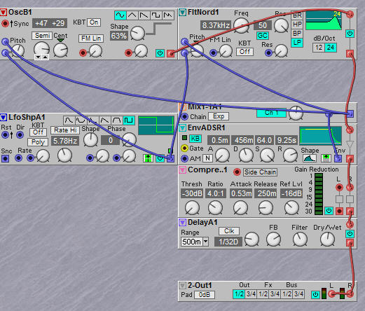

I want to create a effect like the one on this clip (the "sparkly" one that starts high and goes low, not the lead sound) but I have absolutely no idea where to start with this sort of thing. Any suggestions as to general approaches to patching this sort of sound most gratefully accepted.
Cheers, Angus

PostPosted: Fri Aug 12, 2005 1:39 pm    Post subject: Reply with quote  Mark this post and the followings unread
Sounds like a square wave modulating a high Q filter, with some delay and an envelope control sweep. Here is something that is pretty similar. Not exactly what you want but pretty close I think.
Maybe a place to start.

PostPosted: Fri Aug 12, 2005 1:45 pm    Post subject: Reply with quote  Mark this post and the followings unread
The basic ingredience of this sound is a complex multifx..
There is stereo delay, reverb and stereophasing involved in that multi fx...
The sound itself is a strong sounding resonant filter on noise with envelope and lfo modulations.

King Rat
Joined: Mar 11, 2005
Posts: 98
Location: London
G2 patch files: 13
PostPosted: Fri Aug 12, 2005 2:20 pm    Post subject: Reply with quote  Mark this post and the followings unread
Wow - quick replies
I was busy working on this [attached - not a million miles off but a sounds a bit rubbish lower down] but I'll go back and revisit some of these ideas (not that I understand any of the technical jargon - I just spend hours adding in modules and switching them on and off to see what they do!!)
Messed around with the shape of the LFO a bit to get the right amount of bite and distinction on each "bleep" without sounding too clicky. Also assigned some params to the mod wheel so you can mess around with the sound when it reaches lower registers.
Angus

This is what I would probably use as a starting point.
Fast sine lfo on a sinewave, plus another slow lfo or AD env for that large sweep, plus a little modulation of the fast lfo on the VCA. Play with the speed of the slow lfo and echo level for effect. But be sure to first hit that moonweed... Wink
Some extra tape echo comes closest to a late sixties type sound and a spring reverb to an early seventies type sound. The big Accutronics number nine springtank is my advice.
