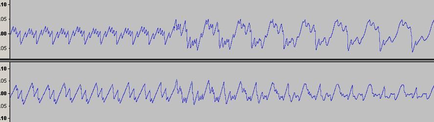

PostPosted: Wed Jan 25, 2006 2:48 pm    Post subject: Reply with quote  Mark this post and the followings unread
This is a difference in waveform I'd say (from the first few notes; I selected a part where the pitch changes to check correct alignment)
[edit] added more pics. All zoom levels are equal, even though the scales don't seem identical (caused by scrolling the tracks into the right part of the screen).
waveform of the left channels from the blind test v1.4 vs v1.32
 Filesize:  22.18 KB
 Viewed:  29828 Time(s)

PostPosted: Wed Jan 25, 2006 3:16 pm    Post subject: Reply with quote  Mark this post and the followings unread
In this particular patch, the LFOs and the oscillators aren't synced to the note onsets, so it's probably normal to expect the waveforms to look different even. Sometimes, looking at waveforms doesn't help all that much.

PostPosted: Wed Jan 25, 2006 3:24 pm    Post subject: Reply with quote  Mark this post and the followings unread
Ahh, good remark Mosc. I haven't actually looked at the patch itself, but I could/should have thought of that myself Embarassed

PostPosted: Wed Jan 25, 2006 3:29 pm    Post subject: Reply with quote  Mark this post and the followings unread
The fact that lfo's and osc's aren't synced do make the comparison semi-objective, however. I have focussed my listening on some specific parts of the demo, where I could hear clear differences. These could also have been caused by the free running oscillators Exclamation

PostPosted: Wed Jan 25, 2006 11:28 pm    Post subject: Reply with quote  Mark this post and the followings unread
The takes do not sound exactly the same because of the free running oscillators and LFOs, but I do not think that exact duplication of sound is what this test is about. The test is about percieved sound quality differences between the takes generated by the two OS versions. The overall sound quality for the duration of the takes should not be affected much by the difference in phase of the oscillators during the recording of the two takes.
Just my opinion - what makes this test of which take sounds better very difficult is the fact that both takes sound bad because of the horrible aliasing!
