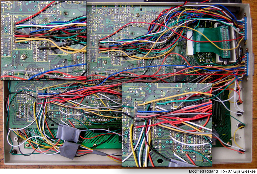

I found this schematic... somewere in this incredible blog: http://gieskes.nl/

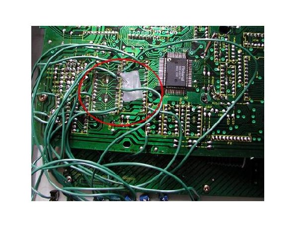

The photos to "~gzifcak/tr-707_pitch_mod.html" appear to be gone, but here's the writeup: Razz
hi,
in case anyone is interested, i added pitch knobs for each of the sounds in my 707. the ones that share volume sliders also share pitch knobs, and the ride and crash have a single pitch control as
well. it's awesome; the sounds are 8 bit so it sounds all gritty and industrial when you pitch them down. it's not a simple mod, however:
1. build nine 555 (the cmos version) oscillators. these are the new clocks for the sounds.
2. very carefully disconnect pins 56, 57, and 59-64 of ic30 from the circuit board, or find some way to cut through the traces that go under the (surface mount) ic. i ended up slicing through the board with an exacto blade before i realized i could have desoldered the pins, cut the traces and resoldered the pins.
3. solder the outputs of the 555 oscs to the pins. this part is difficult because the pins are small and close together. i guess if you wanted you could just build a single oscillator and solder it to all the pins for a global pitch control. that might not work though, because i suspect that some of the sounds run at a different sample rate.
-structural integrity is extremely important here. if one of the pins breaks off, no more drum sound. it's best if you can have the pins soldered in their original places rather than sticking up in the air with the wires attached.
4. TEST.
5. find all of the connections between the original pins and the other circuitry that were severed when you cut the traces, and reconnect them to the original clocks. this part took the longest for me. you have to pore over the schematic and find the stuff that gets the clock signals. it sounds distorted and bent without these connections, and some sounds may disappear.
6. mount the pots.
or you could just go and sample its sounds and tune them up and down that way, but that would be easy. also, i tried connecting the oscillators to the pins while they were still connected to the circuit board and got all kinds of crazy noises that sounded way better than my rom-scrambling bends. it was like pitching the sounds and adding tones and messing with other circuitry that was also connected to the clocks. i might add this function to mine later.

Yes, TR-505, 626 and 707 use the same IC's, so bends of any of these may be applicable or translated to the other devices.
I aligned the picture from the Gijs Gieskes site (great site, and an awsome builder) with the Burnkit2600 schematic and marked pin 1 of the chips.
Lorenzo pointed out an error, so...
EDIT!
The Gate Array pin1 is at the dot in the lower left corner, subsequent pins count COUNER CLOCKWISE (top view).
The MASK ROM chip pin1 is at the upper left corner , count up clockwise (bottom view)
Datasheet compatible to the 256 Kb Mask ROM:
http://pdf1.alldatasheet.co.kr/datasheet-pdf/view/162377/HITACHI/HN613256P.html
gate array IC and schematic together, error corrected

My new question is: it is really possible to de-soldering the pins of the IC30??
There are some tricks?
I notice that there is a difference in two links you gave me. Your last attachment and IC9 505 gate array are different. In the pictures, the tr-505's IC9 count unclockwise, but you say that tr-707's IC30 count clockwise from pin 1!?! It is all right?
I know that thay are two different IC, but ... Confused

PostPosted: Thu Apr 22, 2010 5:44 am    Post subject: Reply with quote  Mark this post and the followings unread
Yes!! Posted Image, might have been reduced in size. Click Image to view fullscreen.
I just desolder Gate Array pins!!
so... now I have to solder it to the 4010 "clock oscillator"
At the moment I add HH, OH, Ride, Crash dacay mods and I found a lot of very nice circuit bent node!!

I have to advise that I have a lot of problems to fing a good "clock osc system" to controll the gate array!!!
look at this thread
Anyway
I delate my previous post, I'm sorry... so:
On IC30(gate Array) the relevant pins are:
Pin 56: Bass Drum
Pin 57: Snare Drum
Pin 59:Low Toms
Pin 60:Mid Toms
Pin 61:High Toms
Pin 62:High Hat
Pin 63:Rimshot/Cowbell
Pin64:Handclap/Tamborine
