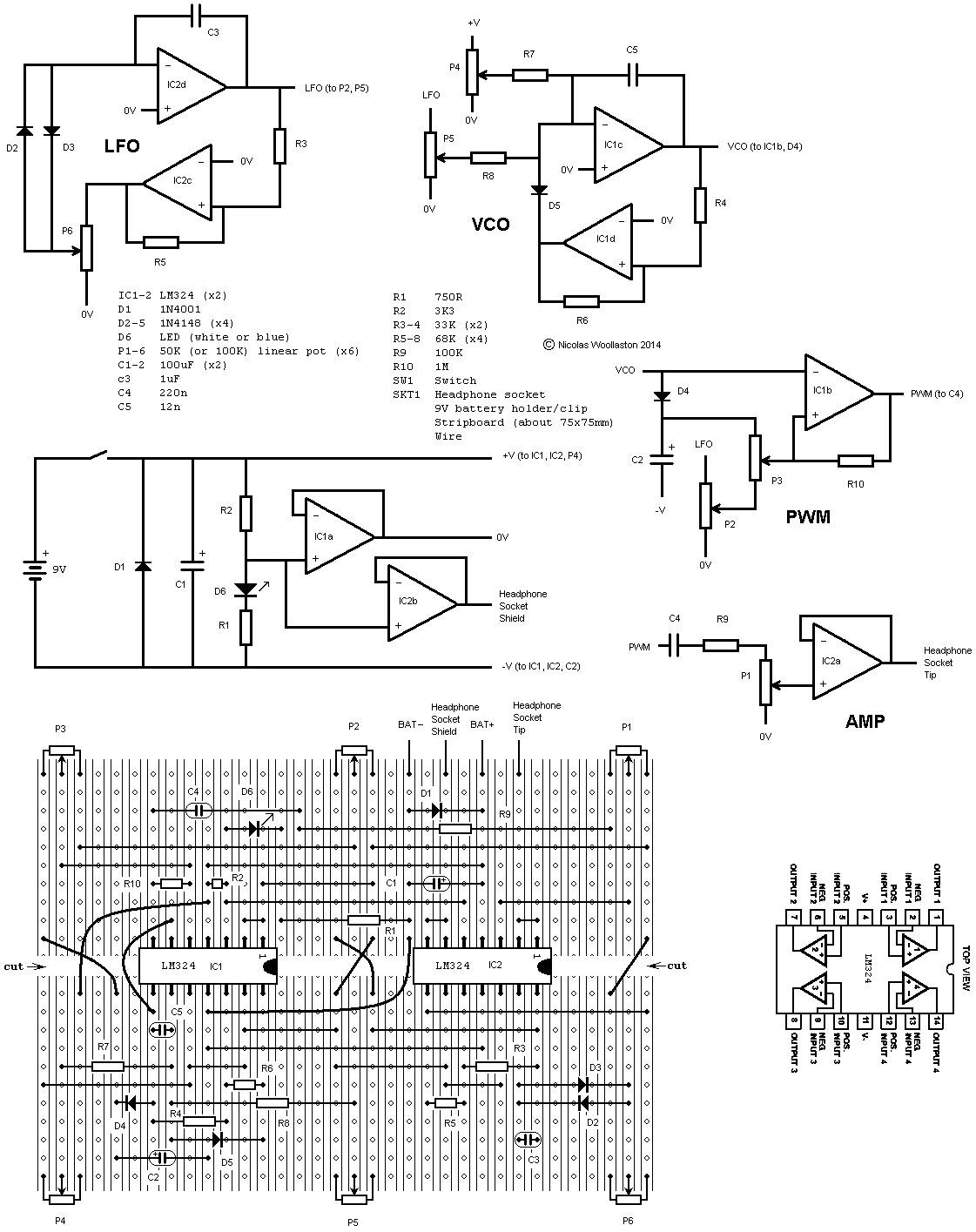

I haven't posted on here for a while, but I am running a workshop this weekend, getting some beginners started on the soldering addiction. I have rehashed some of my simple oscillator circuits and merged them into a single (strip)board that gives an LFO and VCO with PWM and headphone output - 6 knobs to twiddle and all running off a single 9V battery. Simple to construct, but capable of a good range of bleepy type sounds. All components easy and cheap to source. Basically designed to be an easily achievable first project that is simple enough for a beginner to build in a weekend, but sophisticated enough to make quite a satisfying range of cool sounds.

Please let me know if you build this and have any issues or comments or feedback.

The new jpeg has a couple of things moved over slightly to make sure that the pots all have spare tracks either side of them. That makes it easier/safer if you are mounting the pots on the copper side (which is what I recommend). If you are mounting the pots on the copper side the legs of the pot need to be inwards towards the centre of the board, if you are mounting them through-hole you will need to have them oriented with their shafts inwards and legs nearer the edge. Hope that makes sense.

Also, I meant to say, that this circuit has now been built 5 times without problems so the layout is definitely good to go and is well suited to an educational setting where you can use it as the basis for teaching soldering, component identification, basic electronics including opamps, and some aspects of analog synthesis. About right for beginner adults or teenagers as long they have a reasonably good attention span. And at the end they have a little machine that can make some very cool sounds. A beginner (adult) who has never soldered before can build this (with a little bit of coaching) in about 6 hours of soldering. Plus a bit of extra one on one time at the end with someone to help them debug it and get it working. The only issues we had were the usual: placement off by one track, polarity wrong with diodes and electros, solder bridges between tracks, copper whisker bridges between tracks where they had been cut.

one question from a total greenhorn. Is C5 12nF? in germany (thats where i live) i can´t find any 12n capacitors... can i use 10nF or 15nf instead?

Any capacitor within 10-20% should work fine, 10nF or 15nF would both work. Go for 15nF if you want a bit more bass range, 10nF if you want a bit more treble.

Question has come up ... "missing polarity markings on the capacitors c3,c4,c5. does it mean it doesnt matter?"
For these caps you need to buy unpolarised. Polarised caps like electrolytics and tantalums are marked and used for larger values. Pretty much all small value caps are unpolarised types. The 1uF cap is interesting because around that value you can get both polarised and unpolarised types, but in this case you need to make sure you get an unpolarised type and then it doesn't matter which way you solder it in.

however due to lack of supply in my stash of gear, I don't have any of the 33k, 68k and 750r resistors how strict do I need to be? Can I play with resistors that are as close to the ones as required?
What effect would this have on the system?
PostPosted: Sat Jan 10, 2015 11:24 am    Post subject: Reply with quote  Mark this post and the followings unread
If you're building on a breadboard, I'd say just experiment and see.
The other thing is, you can combine values of resistors get get other values. Obviously series resistors add together, parallel resistors combine in a more complex way.

The components I used just reflect what I had in my stash at the time. For things like R1, etc the value is not too critical, certainly anything within 30% would probably work fine. If you want to push the values beyond 20% either way then push them all as it is generally the ratios that matter. So if you want to use 1K for R1 then fine, but also use something a bit on the large side for R2, say 4-5K. Same for R3-R6, the values are not critical, but the ratios are what matters. Keep R3 and R4 the same as each other and roughly half of R5 and R6 which should be the same as each other. R7 and R8 can be varied quite a lot and it will affect the freq range, but not necessarily in a bad way Smile None of the component values in this circuit are critical so have fun and make something unique by trying whatever you have to hand. The LM324 vs TL074 question is interesting, because it will almost certainly work and it may even work better, but it will probably sound slightly different at the extremes and it is at the extremes that this circuit is most interesting, ie when the LFO is almost stopped or when it is screaming in the upper audio - that is where it gets interesting - and that is where choice of op-amp may make a difference. But TL074 may be better, so go ahead and give it a go. As I said, nothing is critical in this circuit and everything is crying out for experimentation Smile

Hello again,
I seem to be having issues with this build as in nothing happens. Crying or Very sad
Testing with a multi meter I see power in the circuit but it looks like it might be too low or something. Could it be due to c4 cap u state 220n I only had 100n caps and as such only used one. Could or should I use more.
Still new to electronics so pardon the simple questions and ignorance.

Hi Citezyne!
No, c4=100n is not the problem, in worst case it would cause a little low end roll off (I don´t think so).
Check your power scheme, is the battery putting out enough voltage (7.5-9V)?
Are your supply rails (+v/-v) at +ca.4V/-ca.4V with ground at 0V?
Check IC1a and IC2b, check the right orientation of D1 and D6, I think that would be a good start for trouble shooting!
