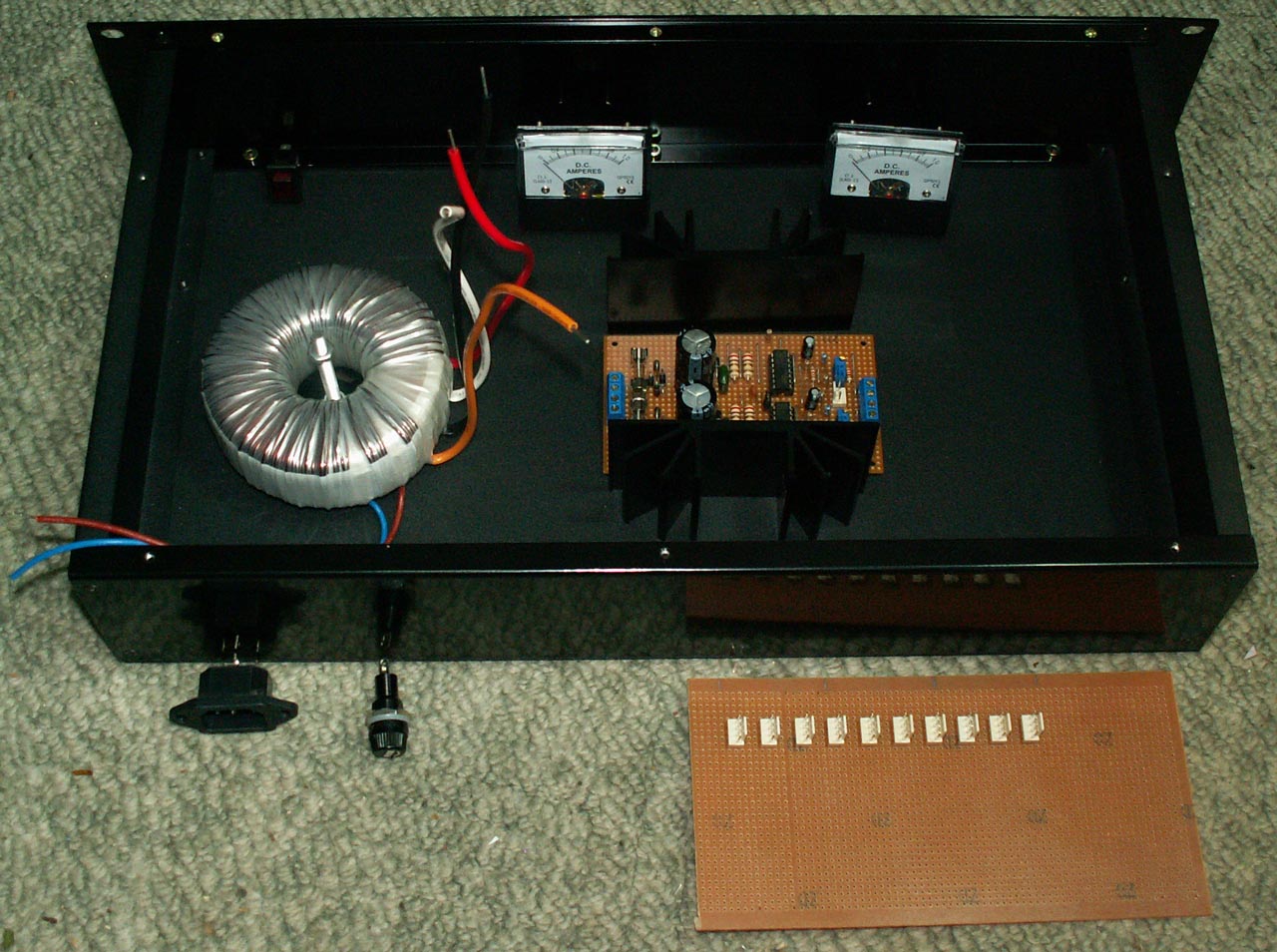

PostPosted: Sat Sep 27, 2008 5:15 am    Post subject: Reply with quote  Mark this post and the followings unread
Okay,
Here's the first pic.
These are all the basic parts, laid out roughly where I want them. You can see the start of my distribution panel bottom right (it's come a long way since then!)
I think there should be plenty of space for expansion later, like I said, that transformer can supply 4A4 on each rail, so to up the ante I only need to come up with a new stripboard layout and heatsink pair later on.

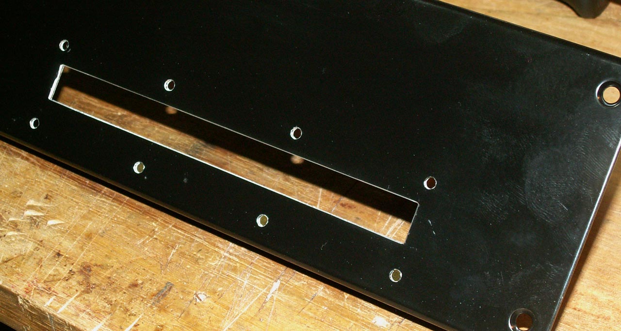

Next,
I got to work on the back panel. Here's a pic of the panel, with holes cut for the IEC power socket and fuse holder. There's a collection of tools around it which I use for this kind of work.

PostPosted: Sat Sep 27, 2008 7:34 am    Post subject: Reply with quote  Mark this post and the followings unread
i cant tell from the pics what kind of ventilation scheme you're using? big heatsinks help conduct the heat away from the regulators, but it's still got to have someplace to go... vent holes and/or forced air.

PostPosted: Sat Sep 27, 2008 7:49 am    Post subject: Reply with quote  Mark this post and the followings unread

PostPosted: Sat Sep 27, 2008 7:58 am    Post subject: Reply with quote  Mark this post and the followings unread
I'm not putting any ventilation holes at this stage, as this board is just 1Amp per rail. The 3A version (when it goes in) will have larger heatsinks and holes top and bottom. I'll sort out where to best place the holes once I have the larger heatsinks in place.
PostPosted: Sat Sep 27, 2008 8:03 am    Post subject: Reply with quote  Mark this post and the followings unread
I don't want to cut holes at the moment, 'cos I don't know where the larger heatsinks will be mounted. I've never built a PSU this size before, so I want to do a bit of testing under load and find out just how hot it gets. Very Happy

PostPosted: Sat Sep 27, 2008 8:13 am    Post subject: Reply with quote  Mark this post and the followings unread
Personally I would ( and I have on my version ) mount the heatsinks on the back of the unit.

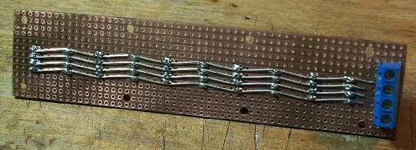

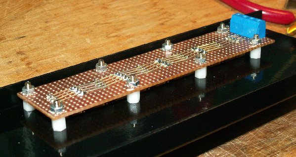

Here's the distribution board.
I used stripboard, as I'm going with the .1" pitch molex style keyed headers and plugs.
The screw terminals are reverse mounted, and jumpered over with a piece of .7mm tinned solid copper wire. I continued this along the stripboard to maintain the cross section and keep the resistance as low as possible. I thought about adding an extra 2 caps at the other end of the distribution board, but decided that would be overkill and would just up the inrush current. What do you guys think? I could still add them later if needed.

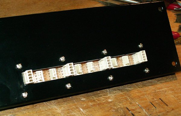

PostPosted: Sat Sep 27, 2008 5:48 pm    Post subject: Reply with quote  Mark this post and the followings unread
Then I mounted it in the slot with 6mm threaded plastic spacers. These are great, as they eliminate the "now, just hold on to those 5 things while I get this one in place,....doh!" effect. Laughing
8 mounting points might seem a bit much, but it wasn't much harder than 4, and it means the board won't flex at all when connecting/disconnecting plugs.

PostPosted: Sat Sep 27, 2008 6:22 pm    Post subject: Reply with quote  Mark this post and the followings unread
When you'd space them differently you could use less ... irregular placement is better than regular and having them at the end of the board is not the best position re. flex reduction .. funny thing is that it's really a musical problem of sorts, the eigen frequencies of the mounted board should be optimized for max stability at least cost Shocked sorry, good morning is what I really meant to say Laughing
PostPosted: Sat Sep 27, 2008 7:54 pm    Post subject: Reply with quote  Mark this post and the followings unread
Yeah, didn't you notice the gap in the middle is bigger? Laughing

PostPosted: Sun Sep 28, 2008 5:09 am    Post subject: Reply with quote  Mark this post and the followings unread
Uncle K -- good work on the rectangular holes --- nice and tidy!!
http://www.bugbrand.co.uk
PostPosted: Sun Sep 28, 2008 6:03 am    Post subject: Reply with quote  Mark this post and the followings unread
Yeah, that nibbling tool is one of the handiest things I've ever bought. Even more vital than a step drill IMHO. You hardly need to clean up the edges either, you can come right up to a line within less than .25mm. It does prefer aluminium to steel though, which is to be expected, but on a nice quality rack enclosure like this one, the front and back are aluminium which makes it easy.
