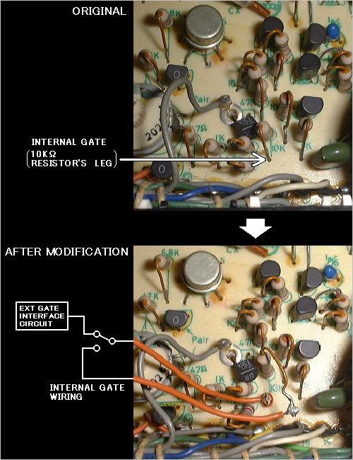

Hi, I recently managed to get my old Korg 900PS back from a friend. As it is, it's pretty useless, the sounds are weak, so I decided to open it up.
Inside there are 17 variable resistors, and a row of smaller preset resistors. They are all labelled up, most of the labelling is pretty obvious, such as cutoff freq, Q, a few less obvious, such as Balance, fC, etc, but there are more obscure labels on the smaller preset resistors, such as TP1.2, TP3, TP4, etc (Test Points?) these have been position fixed with paint, check the pics. There are a few more variable resistors (not pictured) under the control panel to the lower left of the machine, including a white noise level controller.
I was also thinking of making it semi modular, - similar to the MS range, as all the wiring is clearly listed on the board. As it is, the LFO (vibrato) & envelope seem to only control the VCO, it would be nice to have the option of routing the filter through them. I wouldn't mind putting CV/Gate sockets on too, but not sure where I would need to tap into the circuit.
I do have a bit of experience with electronics, but might possibly need a bit of guidance in some areas, and maybe a schematic if anyone knows where I can get one (preferably free). Basically any help will be appreciated.

So, am I to presume a CV/Gate is a difficult addition to this synth, or has this thread just been missed by the right people?
I read somewhere the CV/Gate is Hz/V. If that means anything to anyone?
Here's some info I found about this synth in a Dutch website (there seems to be very little about this machine n the internet). I don't know Dutch language, but this post seems pretty clear:
Board KLM-25
Solderpoint 123, label TRIG --->
Wire colour: blue
No key pressed: 19.2V
Key pressed: -7.8V
Board KLM-25
Solderpoint 120, label <--- TRIG
Wire colour: gray
No key pressed: -2.9V
Key pressed: 9.9V
3 wires on right side on keyboard:
White wire on C3
No key pressed: 0.01V
Key C0 pressed: 2.41V
Key C1 pressed: 4.82V
Key C2 pressed: 9.64V
Key C3 pressed: 19.32V
Brown wire 19.39V continuous
Black wire 0V continuous
http://www.synthforum.nl/forums//showpost.php?p=837233&postcount=30
Now, I'm wondering if I would need to make any extra modifications to have a usable CV/Gate I/O, or if I can simply tap directly into the circuit.

PostPosted: Wed Aug 27, 2008 7:34 am    Post subject: Reply with quote  Mark this post and the followings unread
There was a Japanese webpage that had excellent instruction for adding CV and gate inputs to a Korg 800DV. Judging by your picture they are similar vintage and both V/hz. so I guess the circuitry will be about the same, but the connection points may differ.
I will post up the info from the original site, seeing it seems to have gone.
Actually, the VCF one is probably from somewhere else. Well done to those responsible!
If these prove useful, let me know, there are a few more
Hz/per V is the standard by which most old Korg oscillators tune to, I think it's also called linear tuning (as oppossed to exponential). Yamaha and Paia sometimes used this standard also-- but very few other manufacturers. Most others, Arp, Roland, followed Moog's standard of 1 volt per octave. So, it just means that even with the CV out mod, this synth's keyboard CV won't properly control many other synths (without an exponential convertor). It will control them, just not in tune or scale. Unless you have an Korg MS, Yamaha CS, etc. I'm not trying to discourage you anymore, really. Just saying...

These are very helpful! I haven't yet started the project. I'm waiting to see if I get a good offer or trade, it seems a few people feel it's a sacrilege to modify something so rare. If no offers are made, I will go ahead with the mods in the near future, in the meantime, I'll collect as much data as possible and draw plans ready.
Again, thanks for this, and if you have more, I would love to see them!

I don't think the nord will be much use - isn't it just Midi( just an assumption)? you could get a midi2cv converter (try synhouse - midijack herz so good) but more expense.
it is not much use adding CV and gate inputs if you have no CV or gate sources.
Maybe just check out what the trimpots do, especially the ones on the filter board, if they seem to have a good effect, replace the trimpot with a pot mounted on the panel.
As for modding an old synth...my 800DV was battered, several broken switches and keys, so I had no qualms about removing the keyboard and giving it all the CV and gate inputs. If it was in good condition, i don't think i would want to mess with it.....well, an extra pot or switch on the front panel and a couple of CV/gate jacks on the back wouldn't hurt....

To be honest, I don't think it would hurt to add CV/Gate sockets to any synth with no external control, as it makes it ultimately more useable.
Thanks again for the latest diagrams, very helpful! Wink

A page is missing about S/H GATE UPPER & LOWER OUTPUT (Section C).
Where can i solder this part?
Thanks
andrewF
Joined: Dec 29, 2006
Posts: 1176
Location: australia
PostPosted: Sat Jan 15, 2011 7:51 pm    Post subject: Reply with quote  Mark this post and the followings unread
sorry forgot this one
here you go
