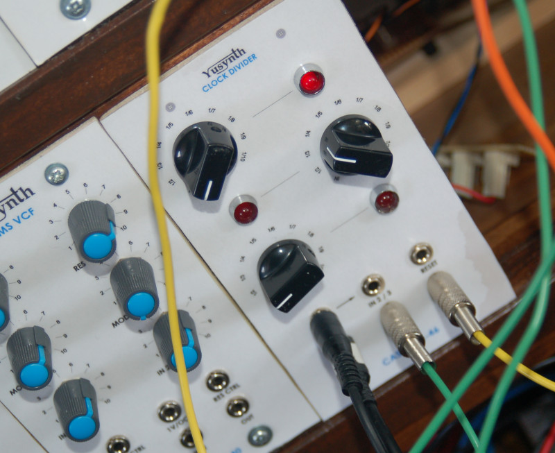

Forgot to post my 2U Frac panel layout...
I opted for the 10-step divider suggested by bugs.
Yusynth Clock Divider

etaoin
Joined: Jun 30, 2005
Posts: 761
Location: Utrecht, NL
PostPosted: Wed Jul 30, 2008 12:33 am    Post subject: Reply with quote  Mark this post and the followings unread
By the way, it works great. I now finally have a module that can sync the MFOS sequencer from a 24ppq clock! A lot of modules can't clock the MFOS seq for some reason.
Now all I need to do is add a remote reset to the sequencer...

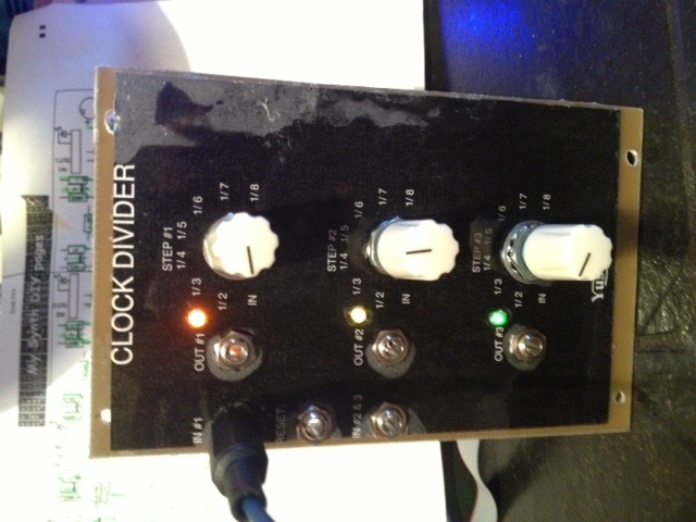

PostPosted: Fri Sep 06, 2013 8:36 pm    Post subject: Reply with quote  Mark this post and the followings unread
What a fantastic little module. I have made a eurorack version (12v), once again by taking the original pcb design and using photoshop to cut the circuit in half to create a new footprint. Thanks again Yves!
 Filesize:  59.69 KB
 Viewed:  10345 Time(s)
 Filesize:  93.42 KB
 Viewed:  185 Time(s)

PostPosted: Sat Sep 07, 2013 8:11 am    Post subject: Reply with quote  Mark this post and the followings unread
I would also like to add that sending audio through it works great and you can get new timbres just by dividing down. For example passing my system x osc through it makes it sound more like a Juno 106. Pulse width stays fairly intact more noticeable on scope than ears though so usable. Plus you have the added ability to jam inversions.
For those interested, playing a c5 note gives you these pitches out:
In, c5 original pitch
1/2, c4
1/3, f3
1/4 c3
1/5 g#2
1/6 f2
1/7 d2 (slightly sharp)
1/8 c1
So much fun to be had!!
