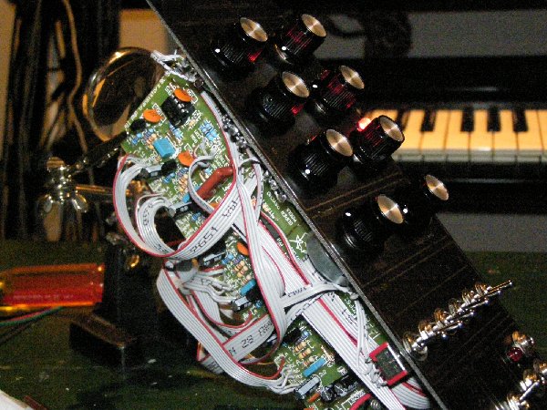

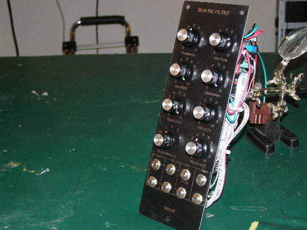

PostPosted: Sun Aug 01, 2010 6:39 pm    Post subject: A couple more CGS modules finished Reply with quote  Mark this post and the followings unread
I finished the CGS Voltage-Controlled Clock Divider in time to demonstrate (and perform) with it last week at the Kansas City Regional electro-music festival.
Today I finished the CGS Bi-N-Tic filter.
The Clock Divider worked on the first power-up. All I had to do was calibrate it.
The Bi-N-Tic was a little more challenging. The smoke test almost turned into a "real" smoke test... indeed, the SM311 chip heated up. Turns out that I had the FET in backwards. Turned it around and the module came to life. (It took me many hours to find it.)
I also tamed some of the voltages that feed the course frequency control (the design gives it a thirty volt range! I got it down to a more manageable 10 volt swing. Smile
How does it sound? Well once my studio is set up (I still haven't gotten everything back into place since the Kansas City EM festival) I'll post a demo track.
It is kind of a filter and oscillator combination that does amazing syncing effects and sometimes strange sweeps that sound more like a sample/hold. I really like the module and look forward to using it.

View that shows the PCB of the VC Clock Divider.
 Filesize:  503.47 KB
 Viewed:  242 Time(s)
The front panel of the CGS Bi-N-Tic filter.
 Filesize:  3.64 MB
 Viewed:  232 Time(s)
The PCB of the Bi-N-Tic filter -- look at all the capacitors!
 Filesize:  3.88 MB
 Viewed:  240 Time(s)
RF
Joined: Mar 23, 2007
Posts: 1502
Audio files: 28
PostPosted: Sun Aug 01, 2010 7:02 pm    Post subject: Reply with quote  Mark this post and the followings unread
Congrats Kevin!
The Bi-N-Tic is the _one_ module that sits forlorned on my shelf of shame. I have spent so much time on it it makes my head spin...and still no joy.
Maybe one of these days I'll get the motivation to go back to it....

PostPosted: Sun Aug 01, 2010 8:31 pm    Post subject: Bi-N-Tic troubleshooting Reply with quote  Mark this post and the followings unread
RF wrote:
Congrats Kevin!
bruce
Thanks, Bruce.
If you decide to revisit your Bi-N-Tic, perhaps you can start a troubleshooting thread on it.
I do have a volt/ohm meter, an oscilloscope, and oscillators on my Aries to use as signal injectors.
The circuit basically has three sections: the signal section, the clock, and the VCO. Suggest one starts with the signal section... even if the oscillator isn't running and the clock isn't clocking you will be able to get output and the bandpass and resonance (damping) will be effective. If you apply an input signal at "in" you should see the signal at pin 6 of each of the LF356 op-amps. If you have a signal at pin 6 of IC4, and no signal from your output, then your output may be connected to the wrong place on the board.
From there, it is a matter of working backwards -- you can inject a pulse signal for the clock.. if the clock chip works, then you move backwards to the VCO.
To check the clock, you can simply take an external clock signal and apply it to pin 6 of the CA3140. If the clock is working, your output signal will be modulated according to the clock frequency.
If the VCO is working, you should see an AC signal at pin 6 of the CA3140.
If there is no oscillation, then scrutinize the FET. Note that the MPF102 (a common FET) doesn't work too well (according the instructions). Also, check its polarity (mine was reversed and not only was there no oscillation, it was shorting the LM311 chip -- the LM311 heated up!)
Be aware that if you substituted 2N3904's and 2N3906's for the BC... transistors, you must install them with the polarity reversed from that on the board. (But, as I found out, though I substituted an FET, I should not have reversed it).
You can also apply a signal to your CV input and see if it appears at pin 7 of the TL072. The front panel frequency controls should cause the voltage at pin 7 to swing. Note that the CV signal at the tempco resistor is extremely attenuated (due to the 56K resistor). However, the LM394 pair amplifies it and you should see a healthy signal coming off of them.
OK, I hope this helps a little... I thought I'd type this out while it is fresh on my mind. Smile
I hope you can bring your Bi-N-Tic to life sometime. It is a really cool module.

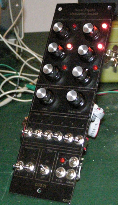

PostPosted: Wed Aug 04, 2010 9:24 pm    Post subject: A new Super Psycho Modulation Source Reply with quote  Mark this post and the followings unread
Those who attended the Kansas City electro-music festival may recognize this panel -- indeed, this is the panel that I used to demo the DecalPro process (though I had to redo the label -- I didn't spray enough glue on the decal and it didn't completely stick to the panel).
It is actually quite a simple device -- six square wave oscillators all mixed together. Each oscillator has its own frequency control, and a switch for off, audio frequency, and low frequency. Oscillators 1 and 2 can be converted to triangle waves.
All the oscillators are fed to an op-amp mixer which, in turn, is passed through a lag (glide) circuit that has a variable control and a switch.
It works very well in conjunction with my (seperate) voltage-quantizer module to create random melodies. In the audio range, it can produce drones -- however it is very powerful when used as an FM source for another VCO. After all -- with six different oscillators, some very complex sounds are possible -- ranging from noise/static sounds to very rich drones.
