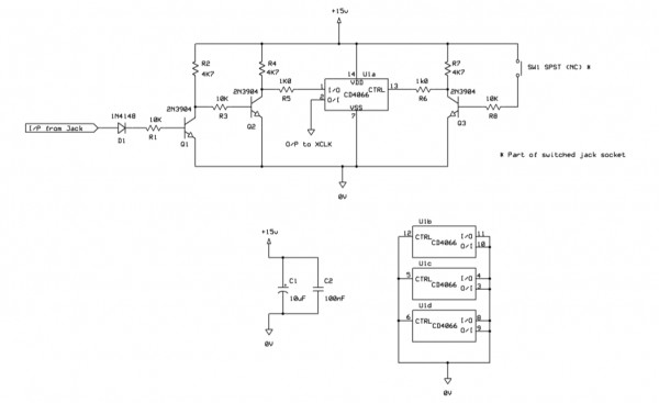

Hi again.
I thought about using a proper op-amp voltage shifter, but I don't think that it's necessary. You should be able to do it with a diode and a couple of transistors as in the attached schematic.
The diode just lets through the positive parts of the square wave. The transistors are switches i.e. fully on or fully off. You need 2, as they are also inverters, so the square wave produced by the first one will be 180° with the original square wave. The second transistor re-inverts the signal. I actually breadboarded it to sanity check the circuit and it works - I've also attached the oscilloscope traces. This was at 5Hz, but it works over a wide range of frequencies.
Let me know if you have any luck with this.

For your information, I have tried a 4066 switch as PHOBoS suggested and it works perfectly. I haven't posted anything yet as I haven't drawn a diagram, but if you need any information, I can post that tomorrow.
Gary

Hi.
I have been looking at switched jack sockets and it seems that normally closed switches are more common (i.e the switch opens when you insert the plug). If you have normally open switches, you just need to put one between the "voltage shifter" and XCLK, but if you have normally closed switches, you can use the circuit below, based on the 4066 bilateral switch (thanks for the tip PHOBoS). The same transistor inverter has been duplicated, so that with the jack switch closed, the 4066 is open and vice-versa. There are probably other ways of achieving this, but I have tested this and it works Very Happy . You might think of uses for the other 3 switches in the 4066, but I've connected all other pins to 0V as I wasn't using them.
Gary

Thank you for the schematic.
Little failure, big pcb.
I can't etch pcbs, so i have to check to get this on a dot hole pcb or stripe pcb.
If not i have to use a dpdt switch.

Nice to know that works. I think you could do it without the extra transistor, just add a pullup resistor to the CTRL pin of the 4066 (13) and use a switch
contact to GND. It also depends on the connectors you use. The ones I have don't have isolated switch contacts, so it would have to be a (NC) switch to
GND. And if you leave out R5/R6 (not bad but no need for them I think) the circuit allready get's a bit smaller Very Happy

Nice to know that works. I think you could do it without the extra transistor, just add a pullup resistor to the CTRL pin of the 4066 (13) and use a switch contact to GND. It also depends on the connectors you use. The ones I have don't have isolated switch contacts, so it would have to be a (NC) switch to GND. And if you leave out R5/R6 (not bad but no need for them I think) the circuit allready get's a bit smaller Very Happy
Yes, that sounds like it would also work (but I haven't tried it yet). I was did wonder if a simpler circuit could be used. Thanks again PHOBoS.
