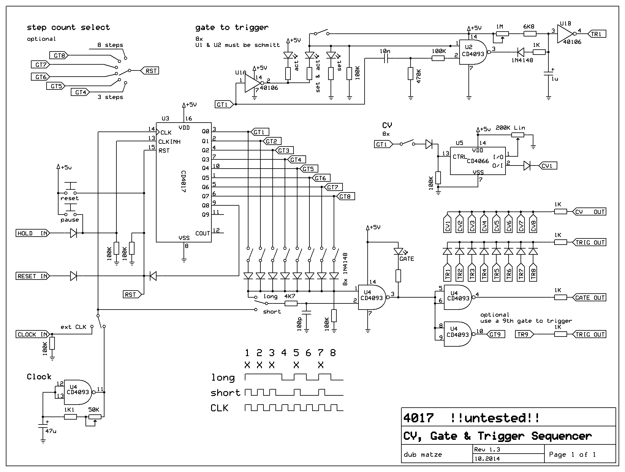

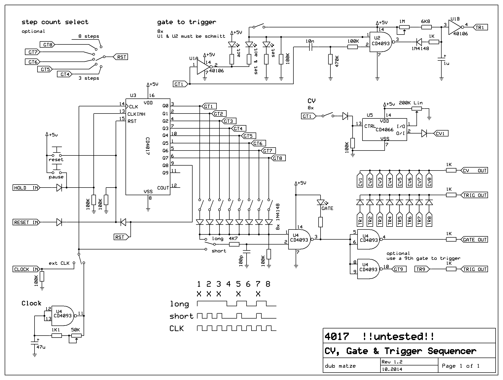

Hello,
can some one have a look at the Gate to trigger section ... will this work with 5Vs? (cant breadboard this atm.) Is there a way to calc the charging time of the Cap? (the 1u i mean)

DUBmatze wrote:
Hello,
hmm it looks like it could work but won't be sure without testing. Calculating the charging time is possible but you have
to keep a couple things in mind here. When discharged the lowest voltage isn't 0V. Caused by the forward voltage of the diode
and the 1K resistor which makes up a voltage divider with the other resistors and pots (so it actually varies).
And there is also the voltage at which the schmitt trigger inverter changes state, which I think can vary somewhat.
You can look here for some info on RC time calculation but there are online calculators that might be easier.
I don't think the global trigger length section will work. (if I read the schematic correct).
It looks like gTL1 .. gTL8 are all connected which can't work. And the global offset pot might cause some weird behaviour too.
some other minor things I spotted:
You most likely want a diode on the reset input. So one diode from input to pin 15 and one diode from pin 9 to 15.
The reset button can be connected directly between +5V and pin 15.
You need a pulldown resistor on pin 1 of U4. I personally would also place one on pin 2. Because when using toggle switches
there is a short moment when the pin is floating if you switch.
I don't think you need the 4066 switches but it should make it more stable and with everything you have connected
to the ouputs of the CD4017 it might not be a bad idea.
The short/long section might not work correct. At least I've been having some trouble with it, in that
it's causing double pulses. more info on that here. But maybe it works for you.
I just drew up a simple gate sequencer with a CD4017. Let me post that and then I'll add a link, maybe it's useful.
edit: posted here

PostPosted: Wed Oct 15, 2014 11:17 am    Post subject: Re: Sequencer again, Gate to trigger Reply with quote  Mark this post and the followings unread
Hey Phobos,
thanks for the fast reply!!
ah you right ... i remove that - just keep it "simple" and mod it later ....
my plan was use the reset input as in and out.
uuups didnt see that.
my old 4017 didnt use that and i realy get some troble with generating a 2nd CV from it. in this case the 4017 must drive 3 Gates and the Gate to trigger thing. i hope that is enouth to add later a 2nd CV section....
hehe this is the only thing i already have tested ..... i use that with a 4081 in my old sequecner and a my pattern generator. while painting this thing i was exact on that page and had already open the tab with the swing generator ciruit from you. Wink but i added the RC. can i still add the 100k pulldown resistor behind that?
edit: posted [url=http://www.electro-music.com/forum
/topic-63020.html]here[/url]
1000 thanks.

pfft now is somthing wrong with the reset .... pfft .... (i just noticed while watching the uploadet version .... )
It should work, although you might need to increase the capacitor value or better use a large (>1M) value for the pulldown resistor.
However I don't think it's necessary with the 100pF capacitor connected. Switching happens almost instantly and the capacitor should take care of any noise.
what's wrong with it ? looks like it should work. Rolling Eyes
Keep in mind that the reset out is a very short pulse in case you're trying to use that to trigger something else. It can be used though.
DUBmatze
Joined: Feb 18, 2013
Posts: 150
PostPosted: Wed Oct 15, 2014 12:58 pm    Post subject: Re: Sequencer again, Gate to trigger Reply with quote  Mark this post and the followings unread
RST shud connect to the other side of the diode. in this case when a selected step will make the reset it will be shorted to Pin9 or?
Posts: 5881
PostPosted: Wed Oct 15, 2014 1:20 pm    Post subject: Reply with quote  Mark this post and the followings unread
ah yes,. I was thinking the label was a reset out, but it's connected to the step count select switch.
In that case it should indeed be connected to the other side and with another diode.
But when using that switch it would make more sense to wire Q8 of the 4017 to it aswell.

RST changed....
