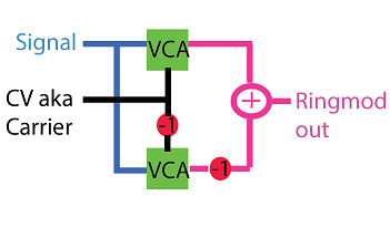

alanwilder has asked me what a vca has to do with a rinmod. I thought i will post an explanation of the circuit here, cos for me it was hard to find a good one when i was going to be interrested in ringmods.
Ringmodulation is also called 4quadrant multiplikation, so far so good.
A normal VCA does 2 Quadrant multipikation. Means if there is a CV and a signal present to output swings up and down, the cv paints the shape. BUT the cv is only positive. If apply a negative cv to the vca it will be mute to output. see pic1
If we put a second vca that can react on negative CV (eg by inverting the cv) AND mix those 2 signals together we have a maschine that makes , i guess, 2 Quadrant Multiplikation. that means the output will swing up and down, even there where before silence, like a copy of the active part pasted into the muted part. see pic2
now the only thing we have to do for have ringmodulation is to invert the phase of the second part we hav created, which can be easily done by an inverter. see pic 3. between the shape in pic2 and 3 is only a little difference when the cv is going thru zero and a important that in the "second" part the phase is shifted - like the wave is going backwards.
pic 4 shows the concept in blocks
any corrections and additions welcome.

PostPosted: Mon Aug 28, 2017 2:53 pm    Post subject: Reply with quote  Mark this post and the followings unread
I verified your ringmod with 2 vcas t and it is indeed a balanced modulator. I have never seen this configuration before. Congrats. Something new, to me at least. Very Happy
Now if you can come up with a linear frequency shifter without a phase shift network you would be my hero.
A frequency shifter just gives the sum and difference frequencies separately, whereas the balanced modulator gives both together. Every analog circuit I have seen uses 90 degree phase shift networks, and digital implementations use a complicated Hilbert transform. (Don't try too hard because this may not be possible). Twisted Evil
