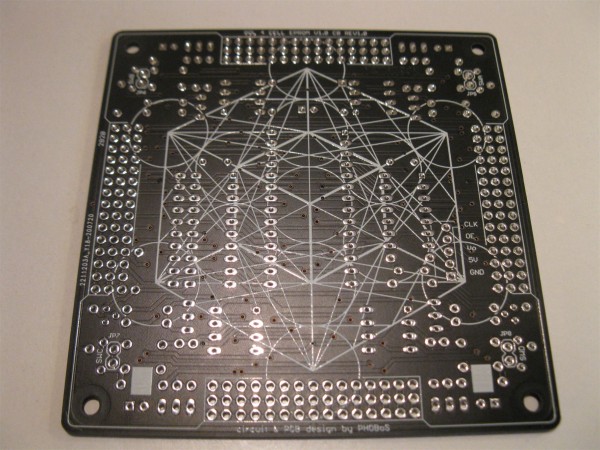

PostPosted: Fri Jul 17, 2020 11:41 am    Post subject: Reply with quote  Mark this post and the followings unread
It's starting to take shape. I need to clean it up but at least sofar everything is routed.

Posts: 5857

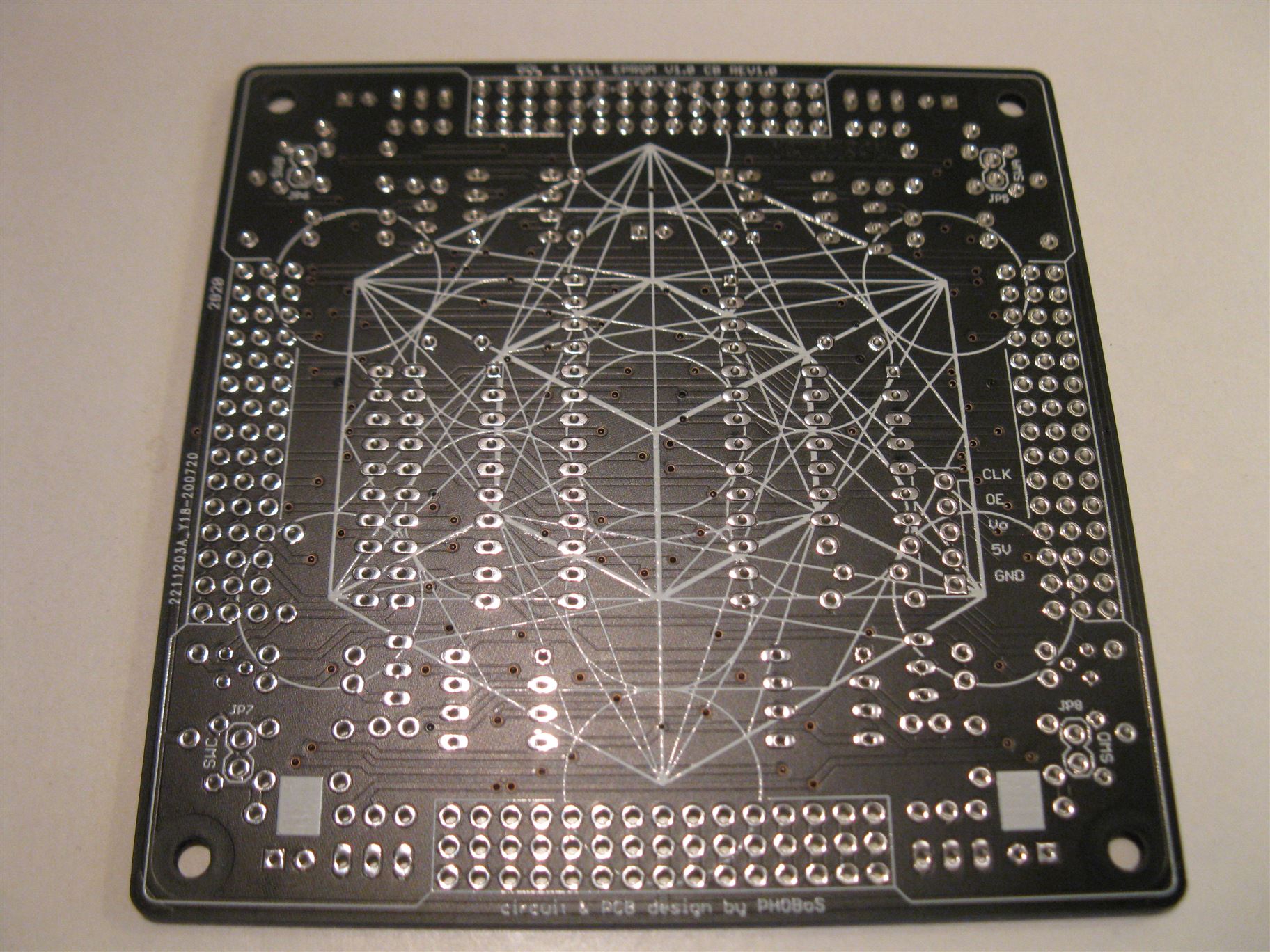

PostPosted: Tue Aug 04, 2020 11:24 am    Post subject: Reply with quote  Mark this post and the followings unread
I got something in the mail today Cool
I've also received the LEDs which is giving me a slight problem. The green is a bit too dim for my liking
at least when driven directly from the 4070. The red is fine and even bright enough with a much lower current.
At the moment I use a 6K8 resistor for the red and 680 ohms for the green which somewhat works but the green
is pulling down the voltage more than I would like (which in turn reduces the current). There isn't a big difference
in forward voltage btw.
The best solution is probably to use some transistors which I tested on my breadboard and it works fine.
Of course I can't do that with these boards without cutting traces but there is another way which helps:
piggybacking 2 XOR chips pig so I could do that for now since these boards are mainly for testing the
concept since I don't even know if it will work. I did manage to change the design and add 4 transistors to it
so if it does work the next batch will have them.
I don't have all the componens yet (mainly need the connectors) but I will probably test something this weekend
or sooner so that if it works I can order the next batch of boards as soon as possible. If it doesn't work I have some
nice coasters.
V1.0 REV1.0 front
 Filesize:  388.86 KB
 Viewed:  248 Time(s)
V1.0 REV1.0 back
 Filesize:  407.98 KB
 Viewed:  243 Time(s)

Posts: 5857
PostPosted: Thu Aug 06, 2020 11:46 am    Post subject: Reply with quote  Mark this post and the followings unread
I am too tired and it's too warm to really test it right now, but it didn't go up in smoke
and I can toggle the LEDs on/off so that's something. Cool
