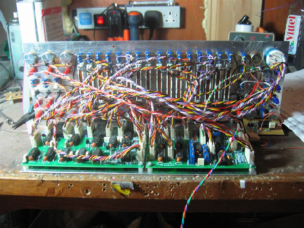

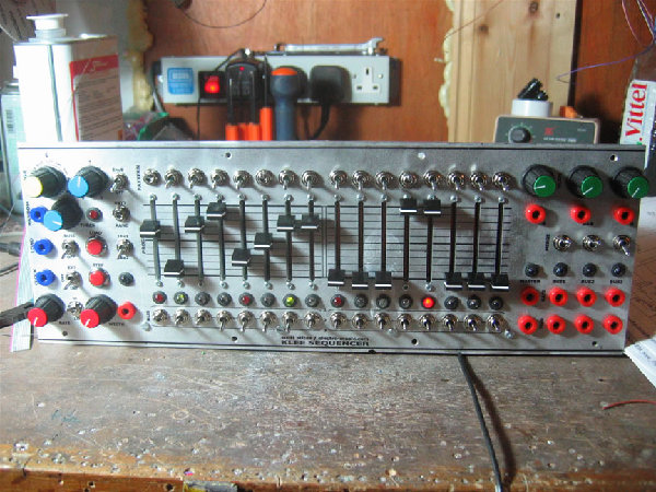

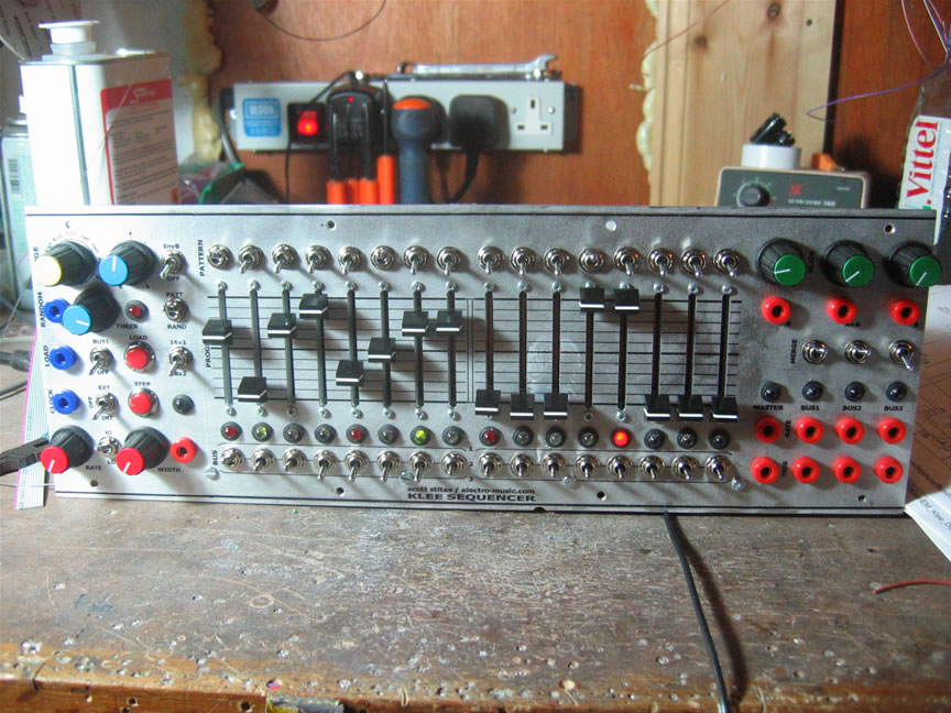

I'm very happy to announce that an electro-music Klee was born today at 6.30pm GMT in Bristol, UK, with an almost perfect bill of health right from the off.
To build something like this and for it to work first time on power up is testament to what an amazing job Scott, Andy and Bill have done with this project. Raising a glass and a grin to a wonderful team!
I'm still a bit zonked from the mammoth wiring session and the first squelch'n'rhythm explorations but I've got some pictures for now. More details & etc coming tomorrow and onwards..

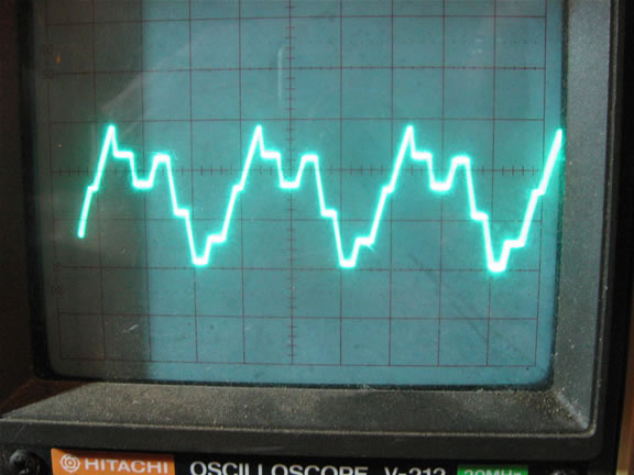

This is a waveform I dialed in running the Klee at fast rates - fun playing with the sliders and pattern settings to change the shapes.
- this was made with just a hint of glide.

Klee Komplete!

Mmmm wiring!
Headers really help though.

Shocked Laughing No brain damage there for sure, congrats ! And doesn't she just look like al of her dadies.

That's a beautiful job Tom!
So colourful, so twisted, so Klee!
I'm feeling all choked up inside! Embarassed Confused Very Happy

Fantastic job, Tom! Congratulations! It looks great. I can't wait to hear it.
now get some rest...

wow! It's beautiful. Congrats...

Tom,
Your Klee is really beautiful! I am jealous of the slide pots!
Now the fun begins!!!
COOL !!! Cool Congrats to you Tom. Great Job Very Happy Very Happy Looks great !
I see you have an "8x2" pattern going on the oscillograph. You can see the CV amplifier slew rate !

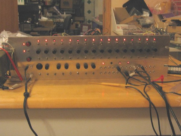

I used to work for a sign company silk-screening...well....signs. I sucked at it, but in my brief tenure there, I had the bright idea of stuffing a rag in my left back jeans pocket. A rag that had been soaked in acetone. Biggest frickin' blister I ever had in my life, that was.
Anyway, outstanding job, Tom. I've got my proto wired up and running. Everything worked pretty much right off the bat, except the lunkhead that drew the schematic put a diode in the wrong place, making the random function not so cool (easily fixed on the proto). The manual step function wasn't nearly as nice as it was on the BB (to say the least), and I've got mine working perfectly now, though the fix needs to be confirmed on the other protos. Thank God for prototypes and prototypers, especially the guys that are working on this project. They're all aces. We all want to deliver a project that works the first time, and every time you power it up.
Anyway, the main problem I have right now is calibrating it - it's no problem to calibrate, the problem is, the Klee just won't shut up. I want to record everything, or nearly everything. And, even if it's disconnected from controlling anything, it's so damn mesmerizing to watch. Seriously.
For me, it's like a whole new toy - having switches one can flip and change things instantly is soooo much nicer than grabbing a wire with the needle-nose and moving it. And the pots - I don't need a tweaker to adjust the pattern voltage! In fact, it's so new to me, I find myself thinking "Hey, it shouldn't be doing that", then I realize it is, because I'm switch-bit, which can happen easily when one didn't have switches before.....might help if I label the switches, too Very Happy

Oh, and such a blast it is! I'm learning new things about it, too, with the increased accessibility to the functions. In particular, I totally overlooked a simple fact about the Bus 1 Load function. The gate bus and pattern switches are pretty clumsy to finagle on the breadboard, so I tended to leave the pattern "switches" in a fixed position, and use maybe two to three gate bus "switches", never more. I never really got the chance to fully explore the permutations of Bus 1 Load and Gate Bus Switches with a variety of patterns.
I'd always thought the Bus 1 Load switch would be handiest with patterns containing a limited number of bits. With on bit, it acts just as a "reset" switch would act on a standard sequencer. With more than one bit, it was a very short pattern before a bit would hit the Bus 1 and cause a reload. So, I thought. The simple fundamental rule I overlooked was that the pattern would reload only when gate bus 1 transitioned from low to high.
In other words, if Gate Bus 1 is already high when a stage set to Bus 1 is selected, the Gate Bus 1 Load switch will let it "pass on by". With a number of active bits, the predictablity of what will happen if you're flipping Gate Bus Switches while Bus 1 Load is on becomes as amorphous as the predictiblity of the other functions. I just spent a good hour or two playing with that function - it's a sort of side-alley of the Klee I didn't realize had so much potential....

I totally hadn't realised that Scott had been doing all the demo sounds before by swapping wires - totally amazing. And, yes, I can imagine the change when you get the sheer wonder tactility and play-full-ness of the finalized machine.
Yes, there's some bits to it that'll take some practice to control but oh my god its so damn exciting to play with! Clay indeed.

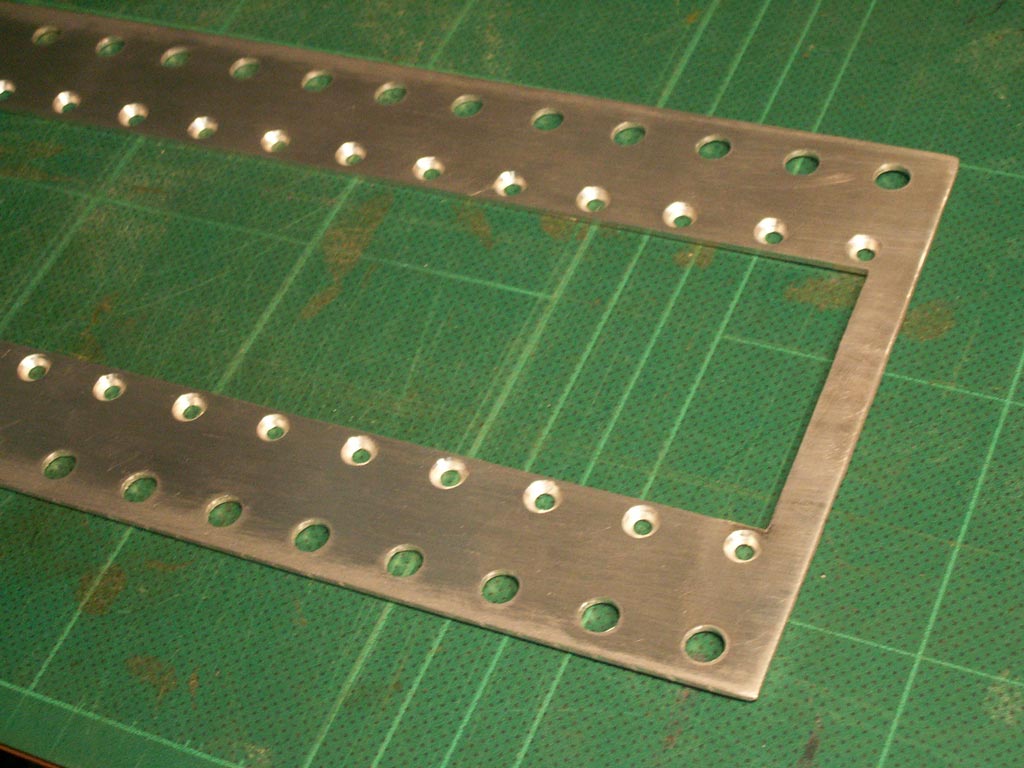

PostPosted: Tue Sep 11, 2007 5:57 am    Post subject: Reply with quote  Mark this post and the followings unread

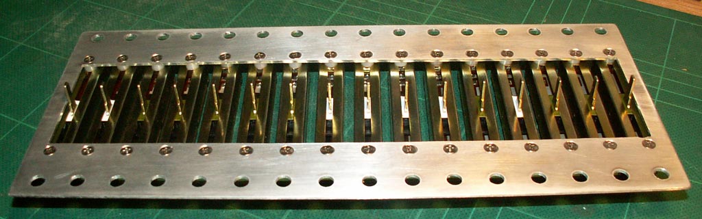

Here's the slider panel finished.

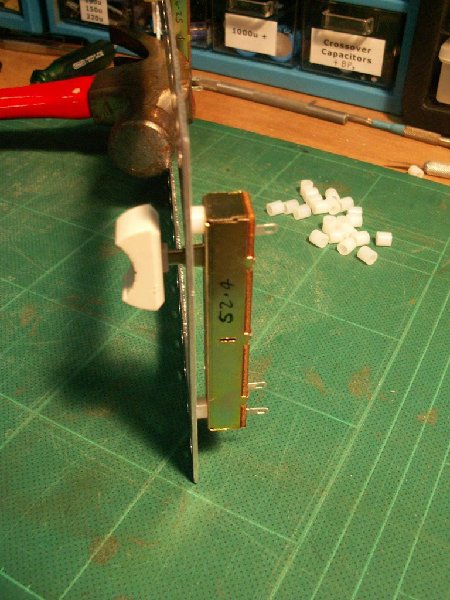

PostPosted: Tue Sep 11, 2007 6:03 am    Post subject: Reply with quote  Mark this post and the followings unread
With a 3mm spacer each side, they sit just right with a Behringer slider knob. (They'd be fairly standard/easy to get similar yeah?) There's space there for the main front panel to sit between. Cool
BTW, I assume some builders out there might benefit from or be inspired by my progress photos, but if any feel they are taking up space or are too obvious, just let me know and I'll put them in a separate thread. Smile
Well I vote to keep them here, it is the build thread after all, and it has inspired me to go with a slider model when the time comes, and I think you guys (big Robert De Niro smile here) are doing all of us a real service, by taking the time to post your progress.
Posts: 2810
PostPosted: Tue Sep 11, 2007 8:03 am    Post subject: Reply with quote  Mark this post and the followings unread
I say keep the photos !! As SLO says, this IS the build thread right Very Happy Very Happy Question Question Besides, the pictures tell the whole story of how to mount sliders. I like it ! The sliders are popular so they are very pertinent to the thread so keep the pictures coming Andy Very Happy

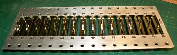

PostPosted: Wed Sep 12, 2007 6:30 pm    Post subject: Reply with quote  Mark this post and the followings unread
Here's the finished slider plate.
Please keep it up. I love seeing how people build things, since I am so poor at it.
PostPosted: Wed Sep 12, 2007 6:42 pm    Post subject: Reply with quote  Mark this post and the followings unread
Well, we all have our strengths and weaknesses Ian. I happen to know that you are pretty damn good at what you do best. Metal work has been fairly instinctive for me. Strange, my father was a carpenter. It does take practice, and the ability to be content with an occasional fuckup.
BTW I don't have a drill press. This has all been done with a one speed hand drill. Of course the right bits, and a well practiced method help a lot. I do think it's important to show others what is possible though. You can get good results on a budget. And you can get great results if you keep at it! Very Happy
